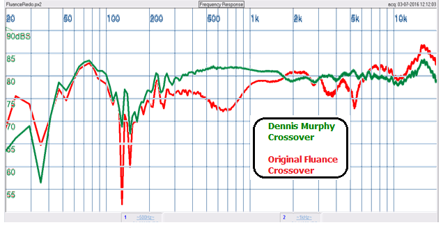

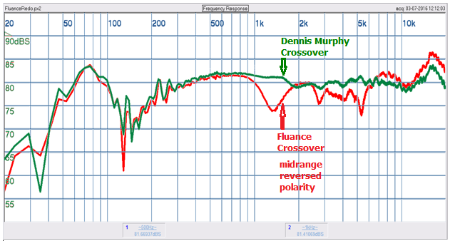

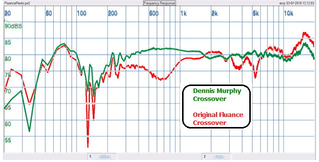

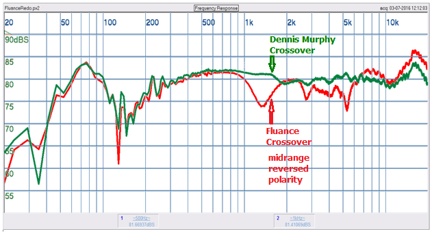

Here is the Fluance crossover with reversed mid range polarity (Red) compared to the new Dennis Murphy crossover (Green).
Next is the original Fluance crossover (Red) and the new Dennis Murphy crossover (Green).
I hope the labels make things clear. I did have some difficulty getting the image sizes to match to get a clean overlap. It isn't perfect, but I did the best I could.
Dennis Murphy
Here are the old crossover (Red) and new crossover (Green) overlapped.
Thanks. I thought you would take the hint when I switched the new plot to green. People should keep in mind that you're comparing the new crossover with the old speaker, but with reversed connections to the midrange. So this isn't how a stock Fluance measures.
You da man. That really does make the differences clearer. Thanks
