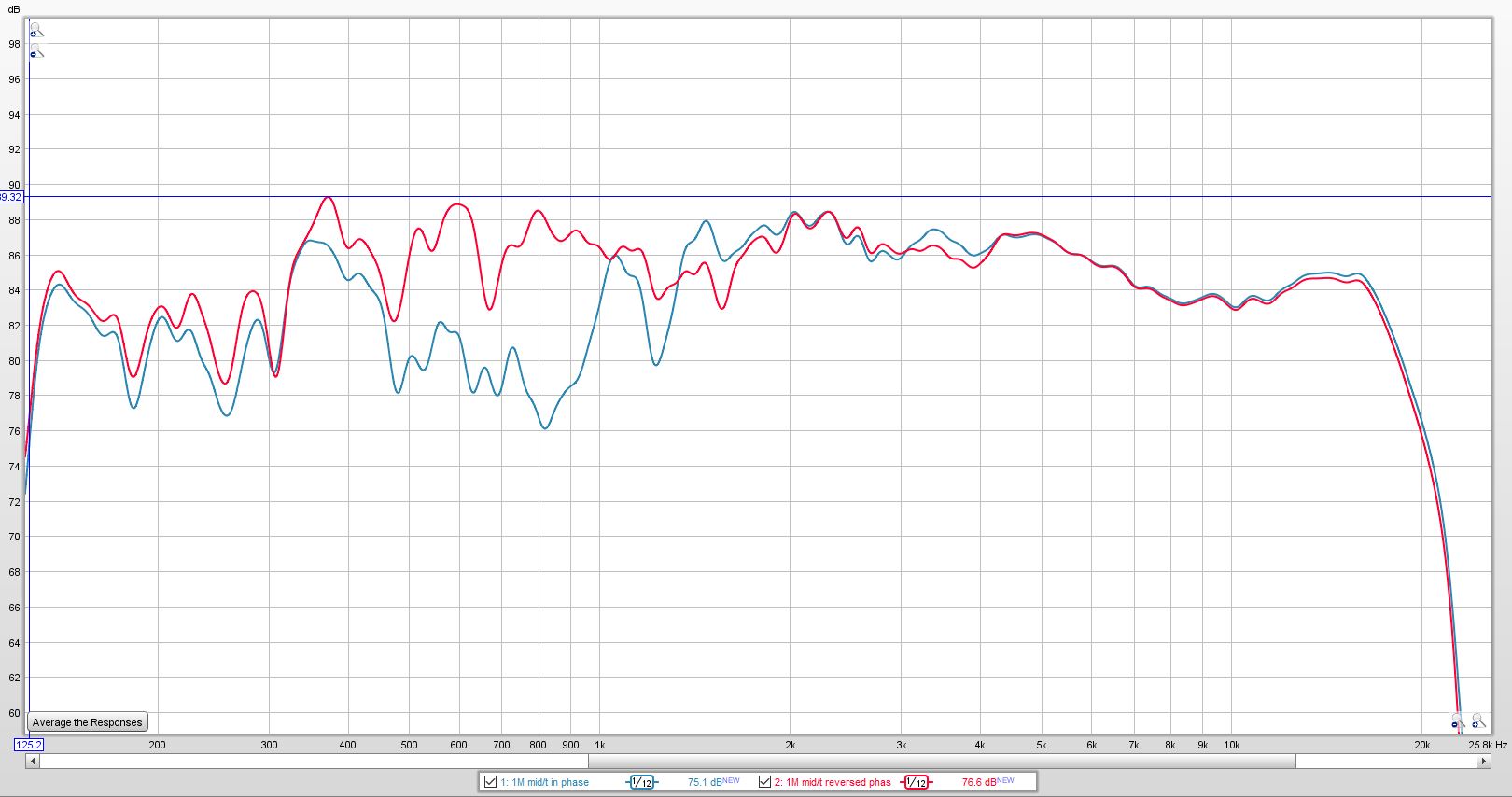

I thought I would post a photo to better show what Gene is talking about. This made a huge difference on mine! It balanced out the sound surprisingly well. The highs are no longer bright and painful. The low end is no longer boomy. Before I read his wiring suggestion I felt something was not right with the sound on the towers. I tried to find the issue and ran power just to the high and mid terminals. I found there was something definitely wrong. Almost all the sound was coming out of the tweet and the mid was pretty much doing nothing. What ever that crossing of the terminals is doing seems to patch that issue and makes the mid come more to life. I still don't think it is putting out what it should be compared to what the same mid drivers are capable on the bookshelfs and center channel, but it made a definite improvement! Hope all this helps.
Here's my 1-meter measurement, with the reversed-phase trick in red.

Here's my 1-meter measurement, with the reversed-phase trick in red. View attachment 17722
Looks like an acceptable fix for those that already like the speakers and don't want the hassle of shipping their products back. Thx for sharing. How do you like the sound after you did this? Admittedly I never actually did a listening test with this fix as I just assumed to do a review of the product with final fixes.

I received a pair of the Fluances this morning, and have confirmed what Gene reported--the connection to the midrange is the opposite of what it should be. I've attached before and after plots.
These plots were made on-axis at a little over one meter. The portion above about 200 Hz is anechoic--that's the inherent response of the speaker free of room effects. The program then transitions to a room mode, where you see a room peak around 75 Hz (which is present on any speaker with decent bass extension in my office), and a big dip in the 100 - 200 Hz range which is floor bounce cancellation--at these frequencies, the sound wave from the woofers bounce back from the floor and cancels out the direct output. Again, this will be present on any speaker unless the woofer is mounted right next to the floor. The response is much better with the midrange connection reversed, as Gene predicted, although there are still some irregularities overall that may or may not be eliminated by a crossover redesign. That depends mainly on whether the problems are strictly due to the drivers themselves, or to interactions with the other drivers. That will take some work to figure out, although it should be possible to improve things a little even if there are inherent driver problems. At present, this is a bright speaker no matter how the mid connection is wired. But some like it bright.
