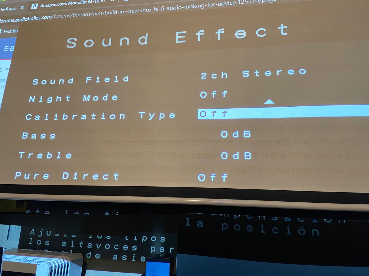

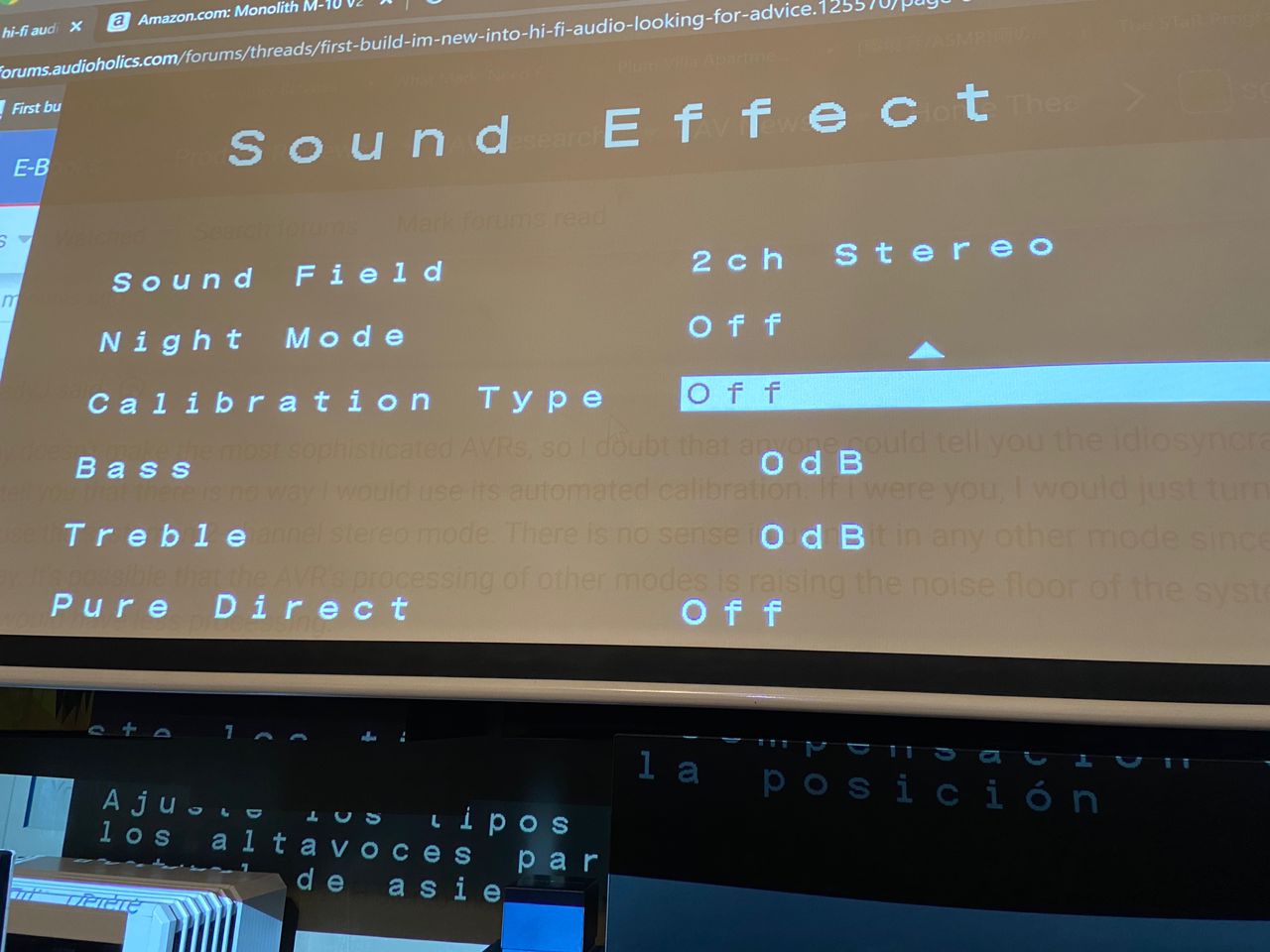

Thanks for the info, does the 2CH Stereo mode cancels any previous calibration? or I should find to delete the calibration?
I'm with shadyJ on the DCAC setup in a Sony avr, I'd just cancel it out (reset the unit is probably easiest). I doubt a particular sound mode would cancel the calibration, except perhaps a direct/pure direct type mode.

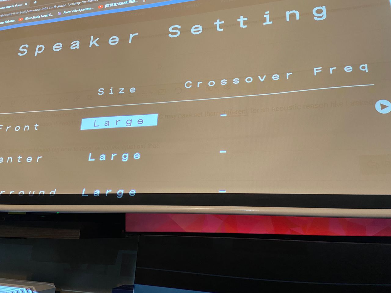

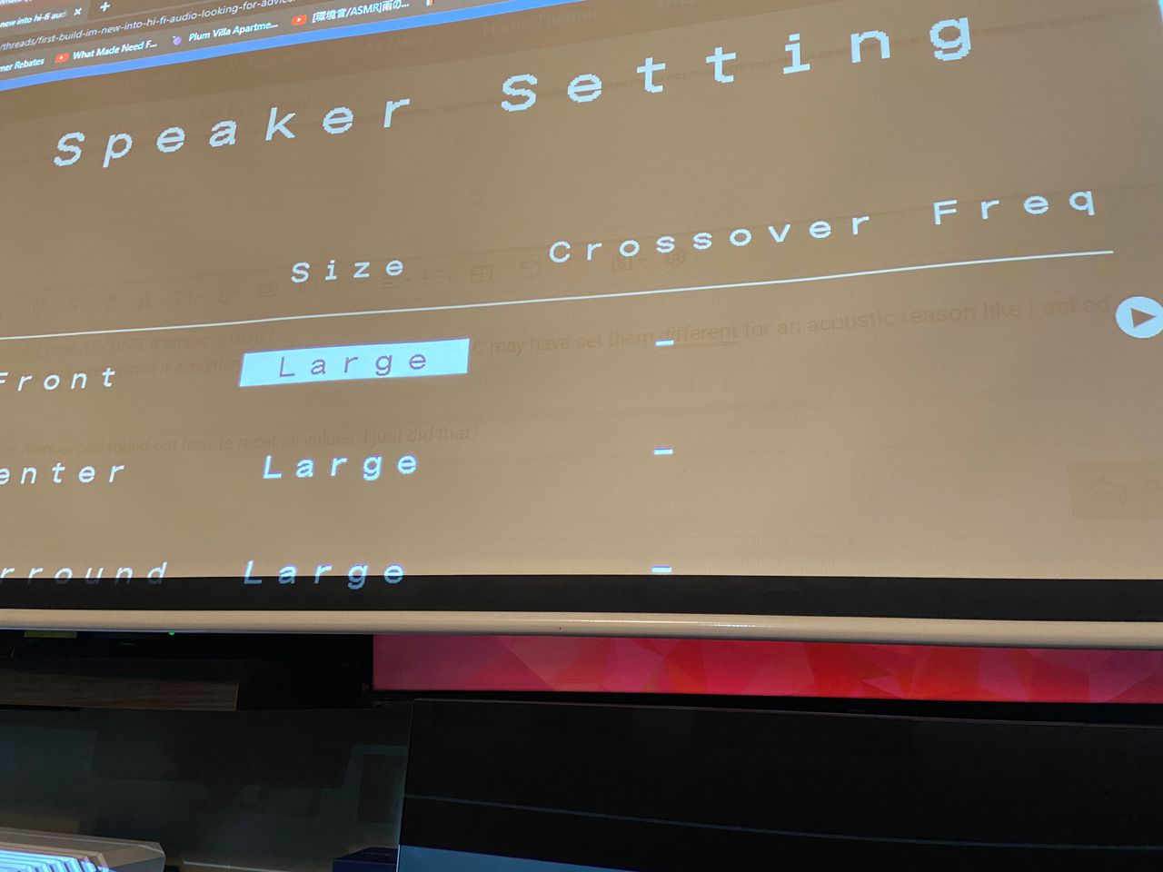

I guess this should do it?

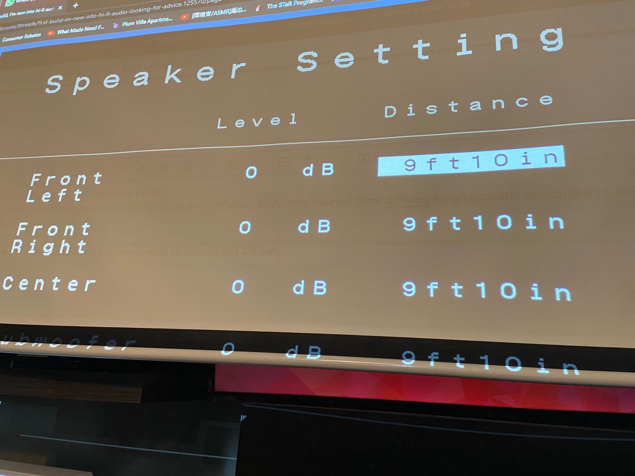

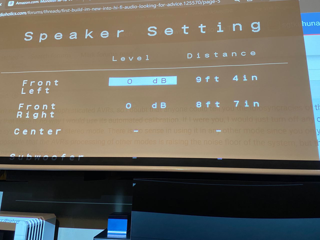

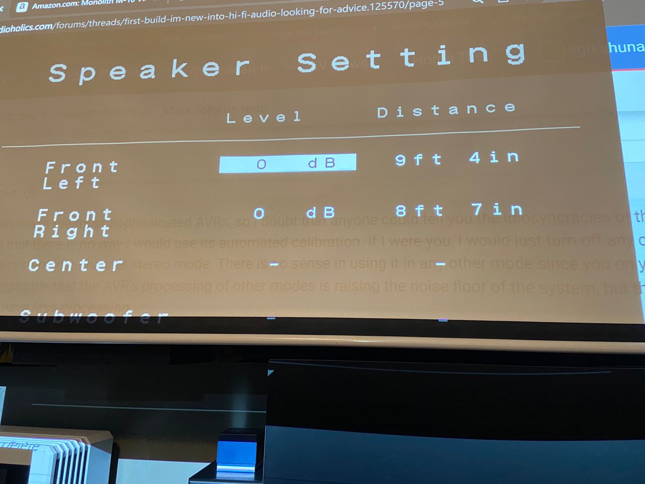

Do I have to configure this distance?

LOL that does look easier (but might have to do that per input).
I'm only able to see that screen with the projector, meaning I'm not able to change that setting in the other devices (TV is using digital audio) and Bluetooth well it doesn't have any screen.
Please let me know about the second photo the distance thing.

Are the speakers not quite symmetrical? One placed in a corner or something? Shouldn't be particularly important other than from a balance perspective in 2ch, tho.
They both are placed next to the side walls, they look symmetrical to me.
I care a lot about balance perspective it's an issue I had with my previous speakers.
Then set the distance and levels equal if everything is nice and symmetric. DCAC may have set them different for an acoustic reason like I asked about...

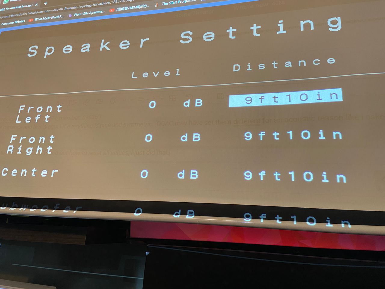

Thanks, I went to the manual guide and found out how to reset the device. So it affects all the outputs, for my peace of mind.
Although I noticed it now "detects" a center and surround speaker even when I don't have any.
I measured from speaker A to Speaker B and the distance is about 9ft'10 which somehow matches what the AVR suggested. Not sure how?
Many avrs start with a default like that, it didn't "detect" anything unless you used the mic. You can turn off speakers/channels not in use I'd think.
I don't see an option to disable the other channels but I'm using the 2CH ST.
