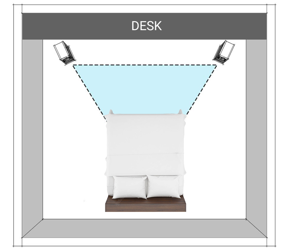

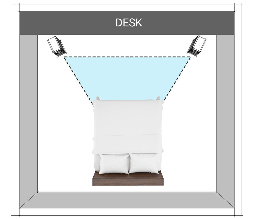

Thanks for explaining, this is the only place where I could put them, is not near close to the wall, below the desk is gonna be an empty space and that party speaker will be gone, will this position cause problems? I believe they would have to be a bit angled I tried to make a perspective but failed miserably.
If you are sitting in the middle of the speakers, that will create a strange soundstage and have a headphone-like effect. You really want to have the speakers in front of you, like so:

Something like this would be the layout, but have in mind there's empty space below the desk, I'm not sure if all that spaces cause something to the rear port thing you said. This is the space below the desk I'm talking about: https://prnt.sc/IQxQPnf0WhBE

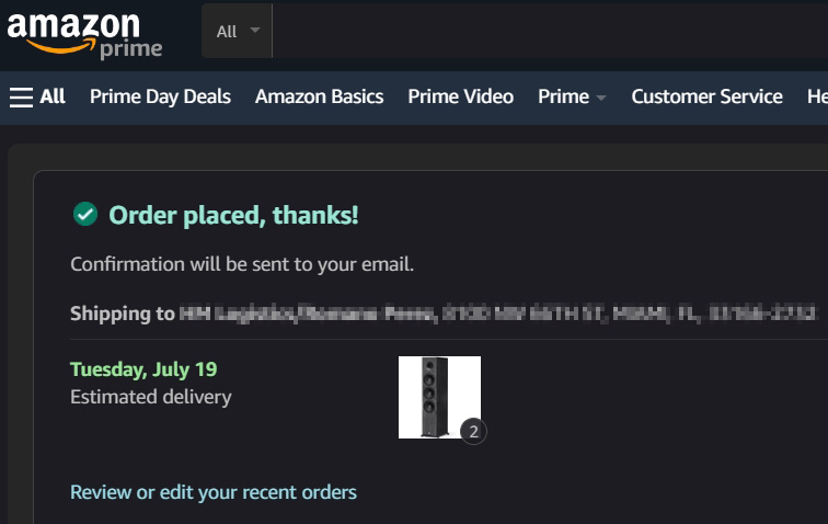

Hi guys, the Sony SSCS5 is on sale right now for $113 but I decided to go with the T6's hopefully I made the right choice, I know the T6's are superior in every way, I'm just worried about the tactile/powerful bass, if in the future I'd like to get a sub, what would be a good match?

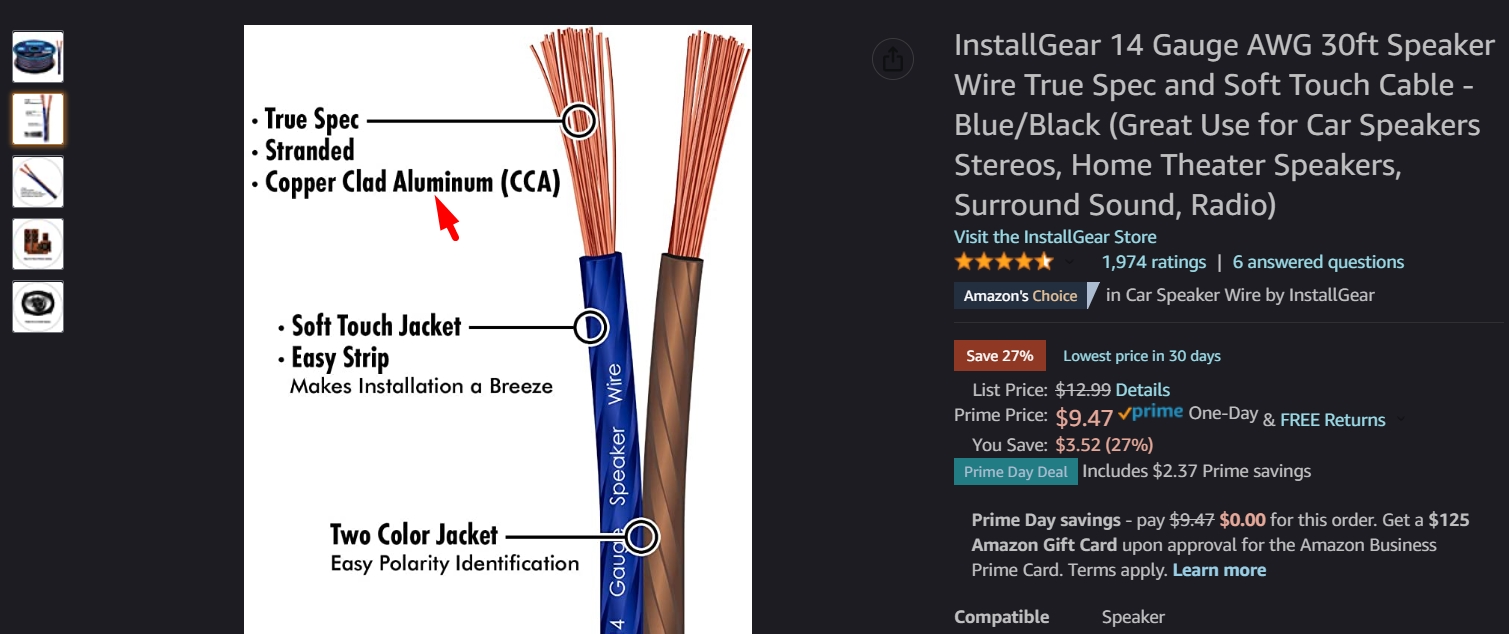

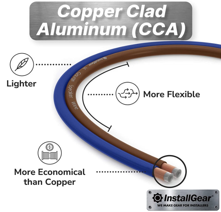

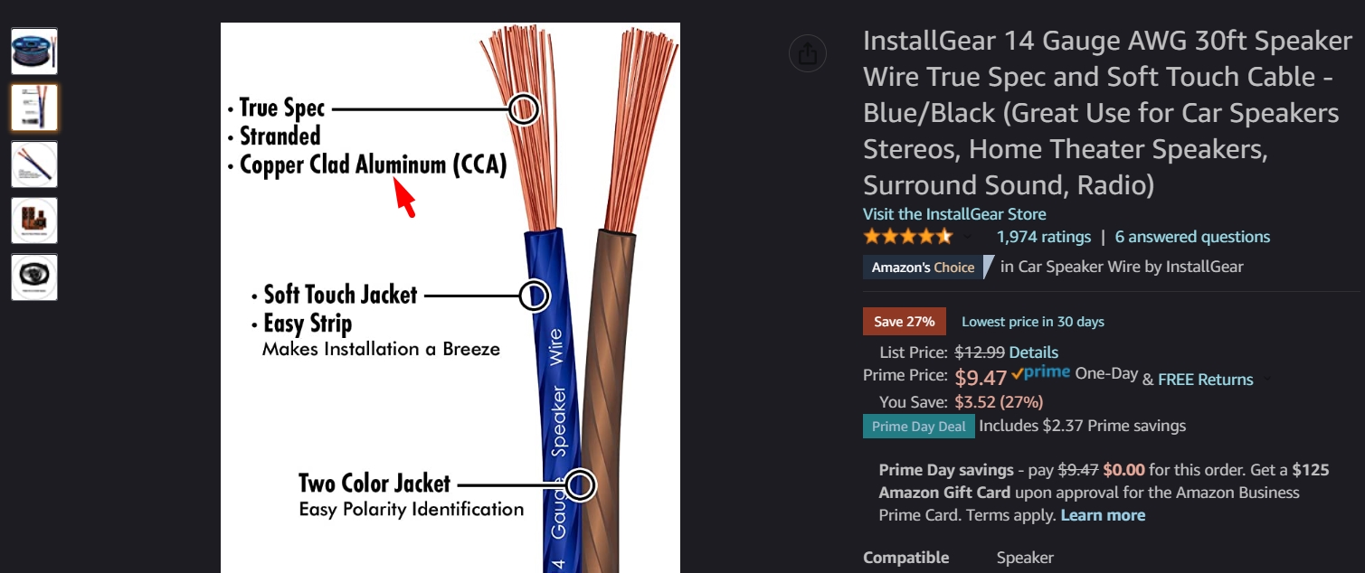

Does it have to be pure copper? or this one will work well?

Please avoid copper clad aluminum. Copper and aluminum in contact with each other can lead to galvanic corrosion. It may be cheaper but can lead to future problems. Yes, it should be pure copper, but it does not have to be low oxygen or oxygen free copper like some cable manufacturers advertise. 14 gauge stranded copper is enough or you can step up to 12 gauge (lower gauge is thicker). The second photo of the pure copper cable is good but what many call "lamp cord" at a hardware store is perfectly fine for speakers. You'll pay a premium for oxygen free but $27 shouldn't break the bank.
EDIT: You might want to add a set of banana plugs for ease of connecting/disconnecting the wires. If the speakers may get moved around, there are locking banana plugs that should not work themselves free.

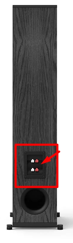

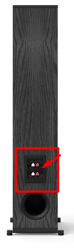

I see there are two sets of ports, does that mean I have to run double wires?

No, the upper and lower terminals can be bridged at the speaker and you use a single speaker wire.
Do you have an owner's manual to reference? Most speakers with two sets of terminals are capable of "bi-amping" where you use separate amps to power the woofers and the midrange/tweeters. It is most common for the speakers to come shipped with metal bars or speaker wires that connect the upper and lower terminals (positive to positive and negative to negative). You leave the bars in place and connect the speaker wire to either set of terminals.
