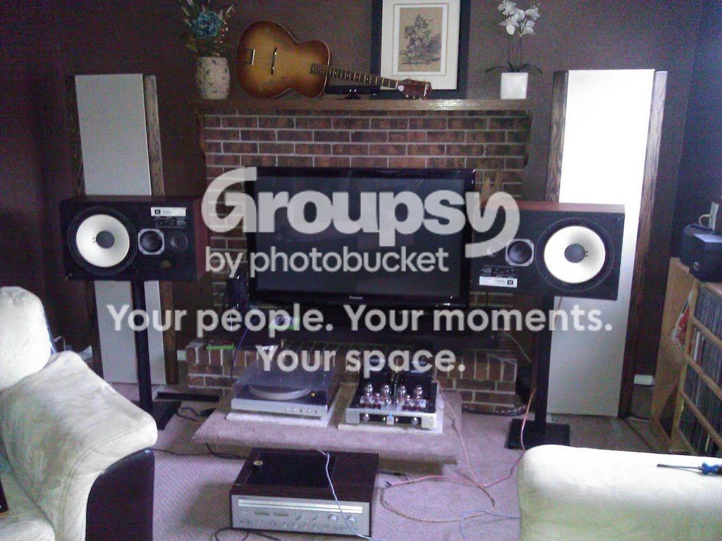

Done! Projector theater AND Planar 2-channel systems

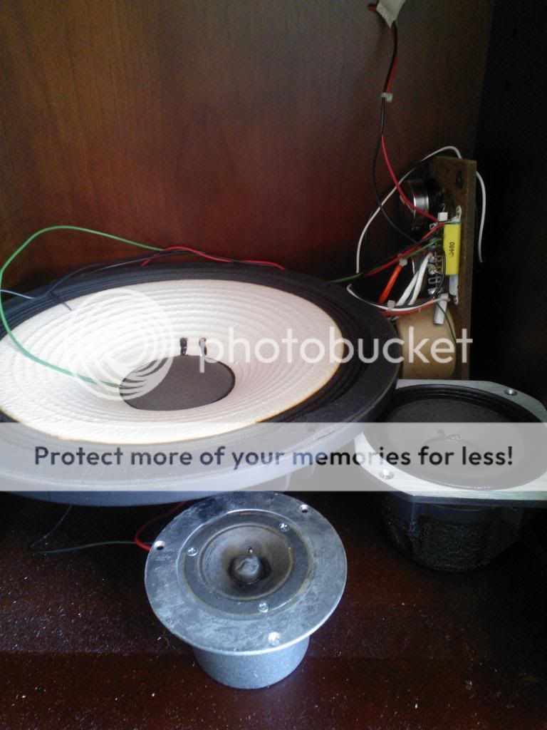

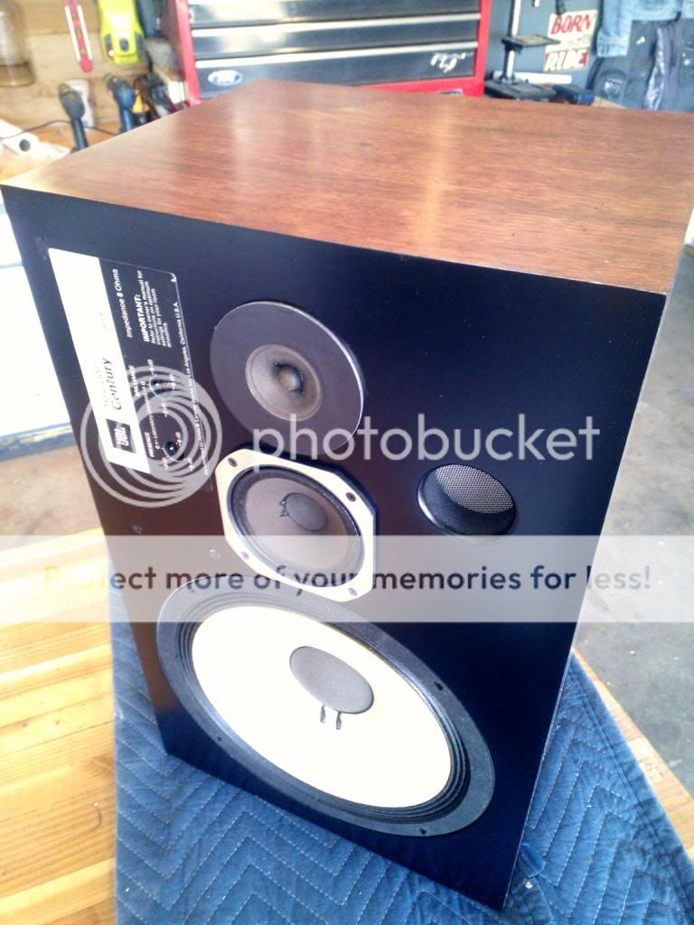

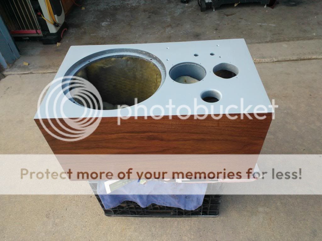

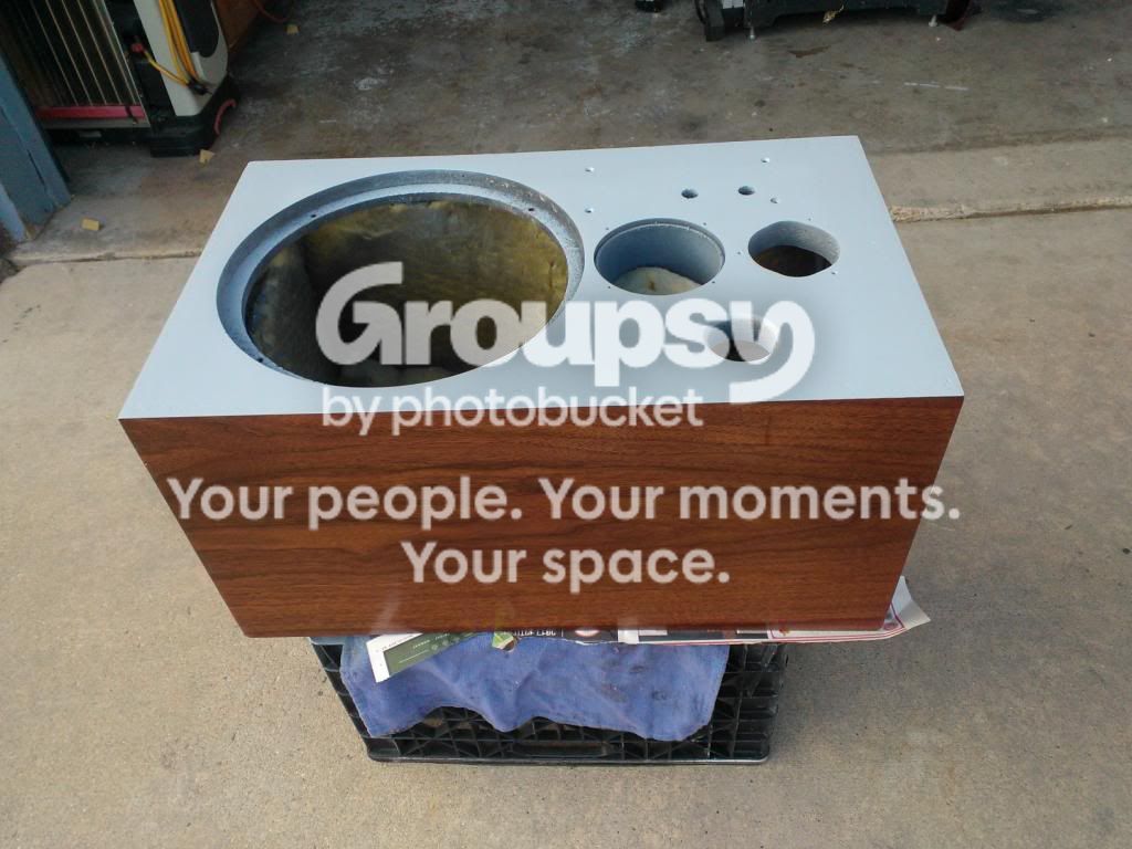

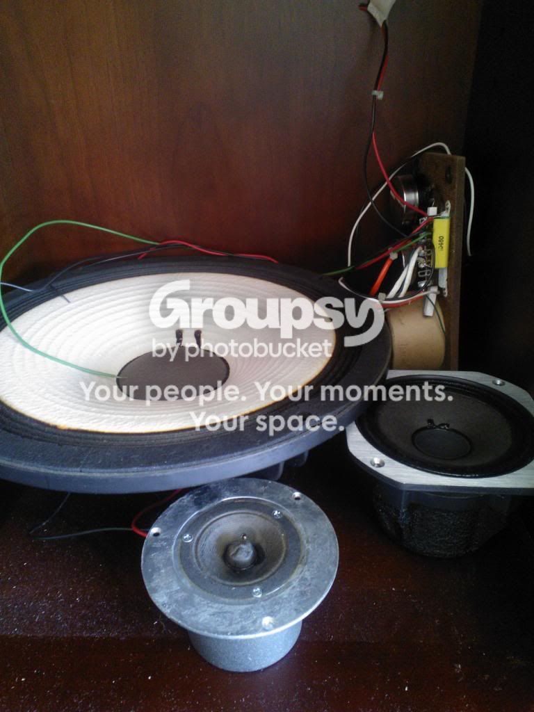

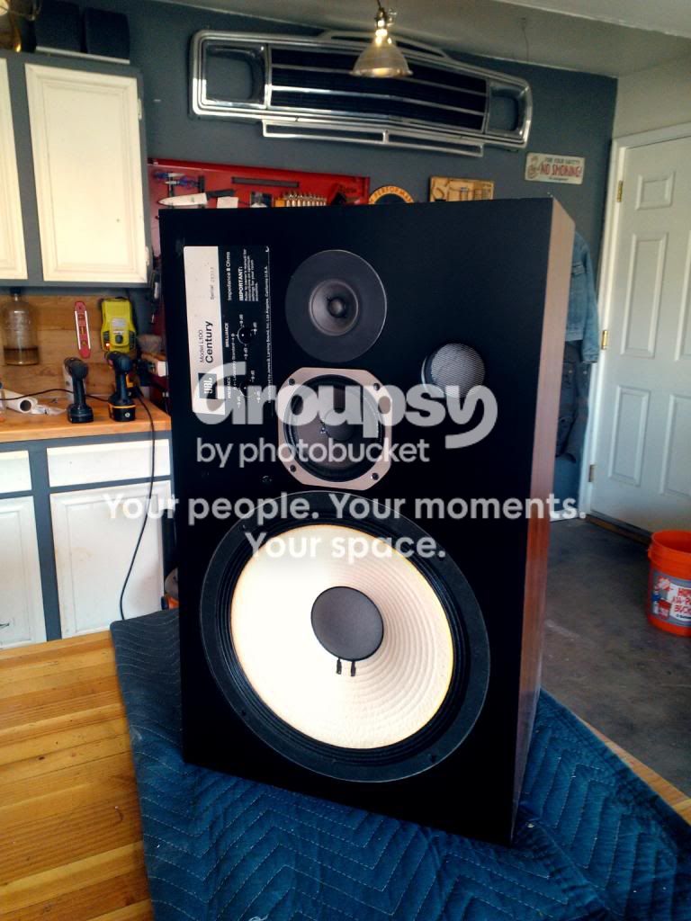

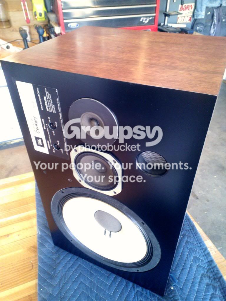

Finally getting around to restoring the JBL L100's I like to use.
1st off, threw together a pair of OB full-range BOFU speakers (This photo is not at the completed phase, The walnut got finished further and a pair of rear firing tweeters were added).
Here's a few pics of the JBL's in progress (only cosmetically restoring, decided that, even though they have many flaws that can be fixed with new crossovers etc., I prefer to keep them as they are as a little time machine).

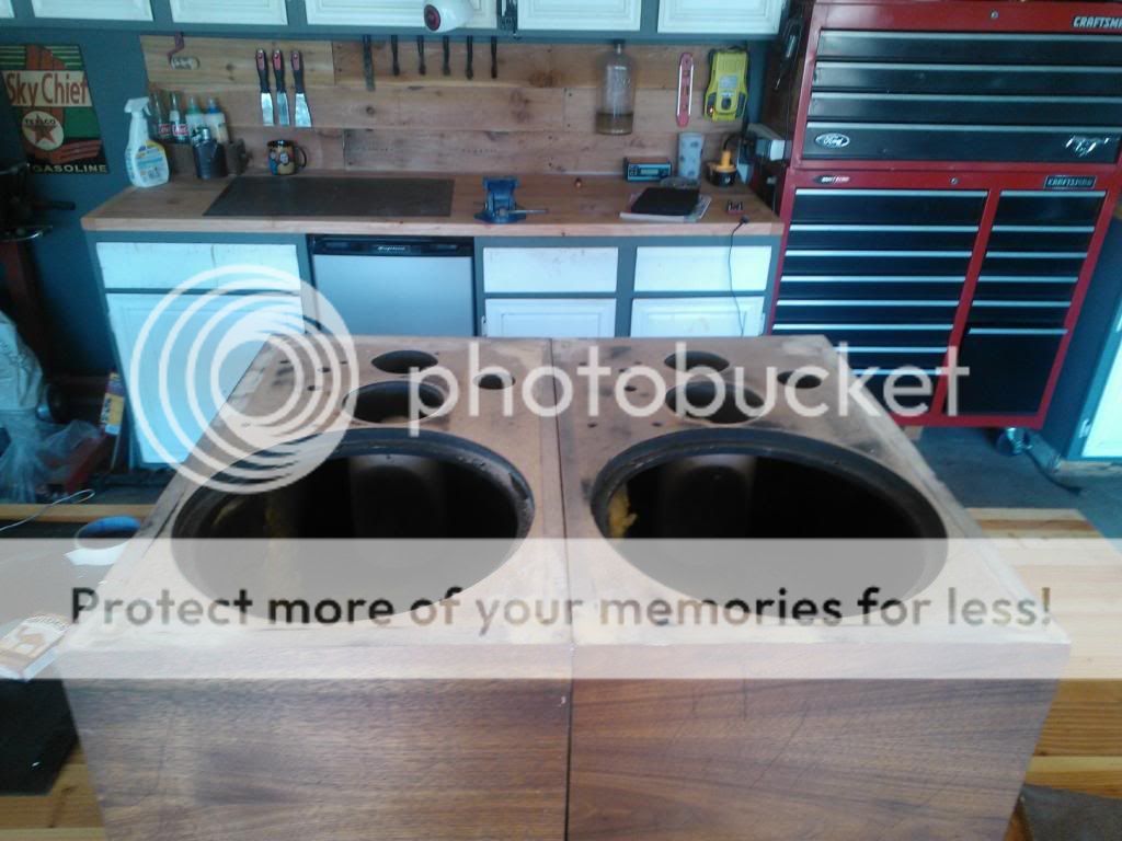

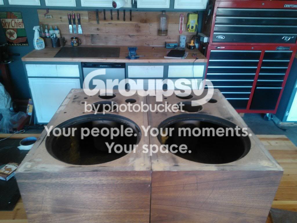

All the components lying in wait for the fresh cabinets

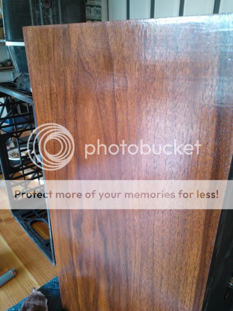

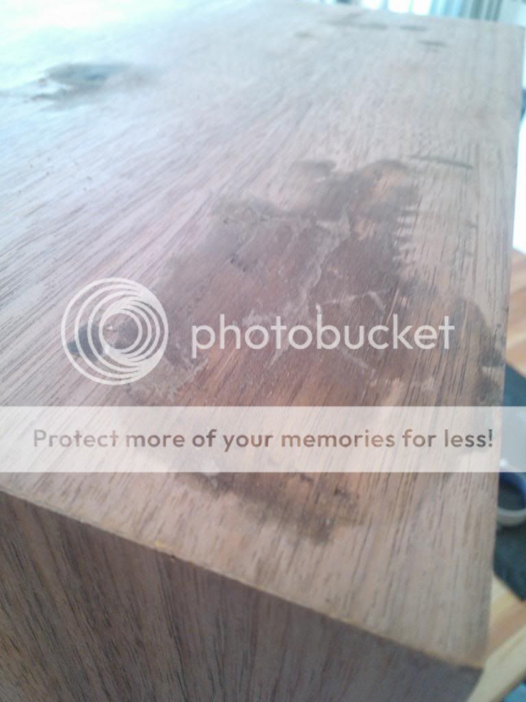

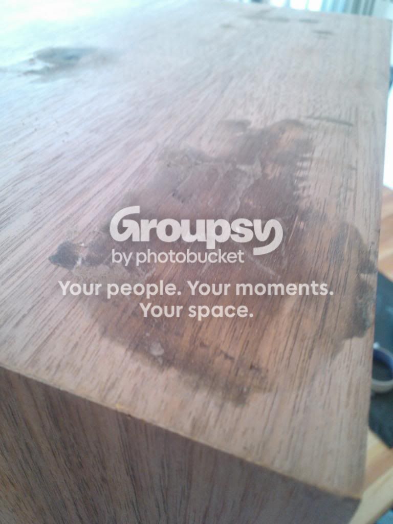

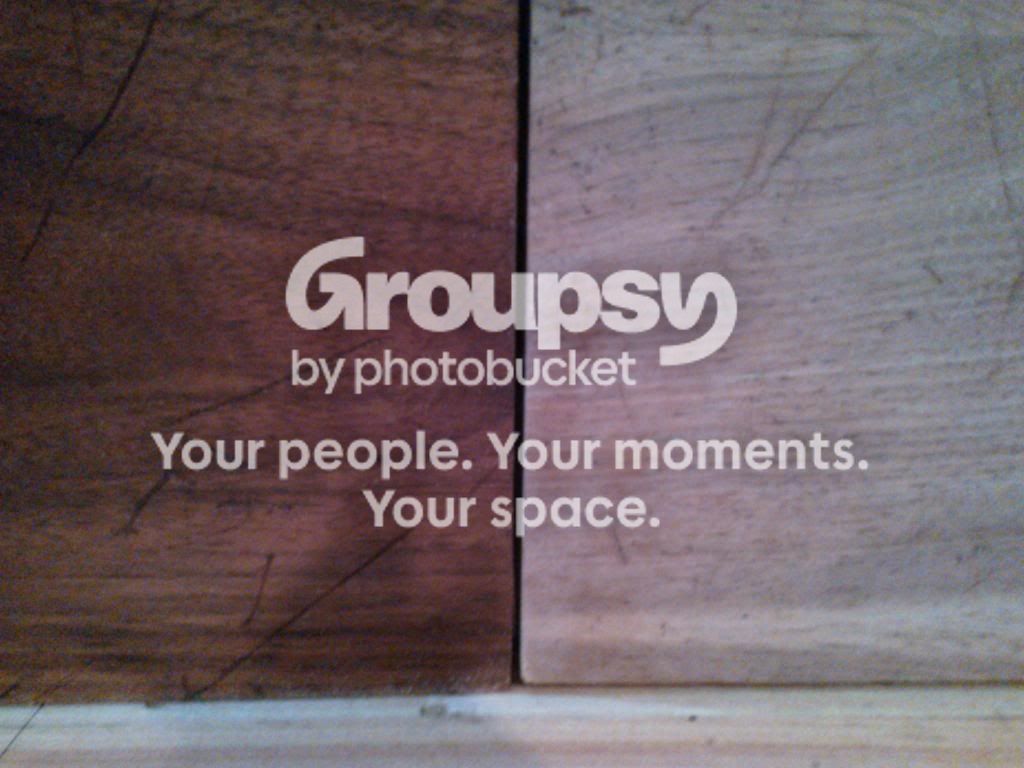

Sanding the black finish off of the porous faces

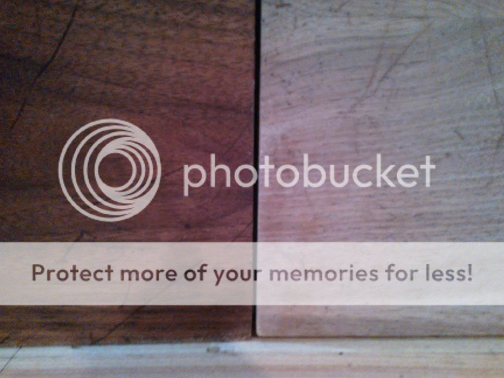

Sanding back the veneer to clean wood
Filling the scratches and gouges with a mixture of glue and walnut dust
Sanding sealer added over the veneer.....this is all sanded back to the wood, just to fill the open pore grain of the walnut and give a flat, smooth surface for finishing

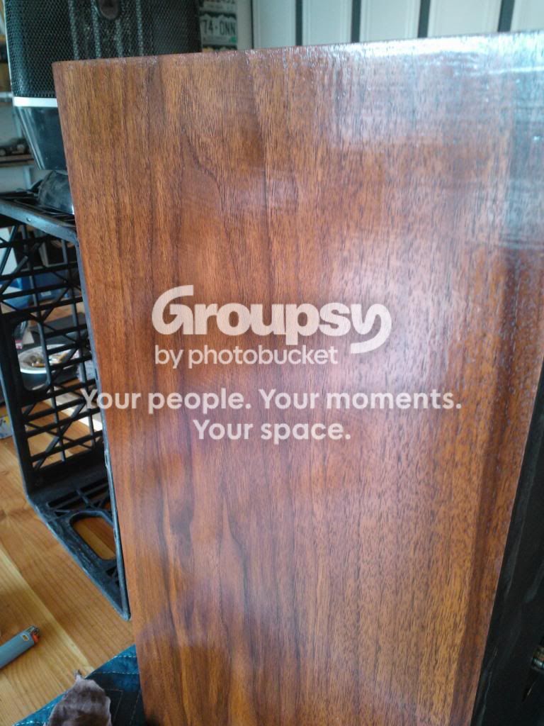

The veneers have been sanded down to 400g and coated with Deft satin lacquer. Have filled the grill pin holes and and adding layers of high build primer to get a smooth, uniform base to repaint the faces
The sanding sealer is well worth doing, creates a really fine finish once it's lacquered. Very time consuming process though. 4 coats, 1 hr dry between each and can only do 1 side at a time, followed by a considerable amount of sanding. But, again....well worth the time.

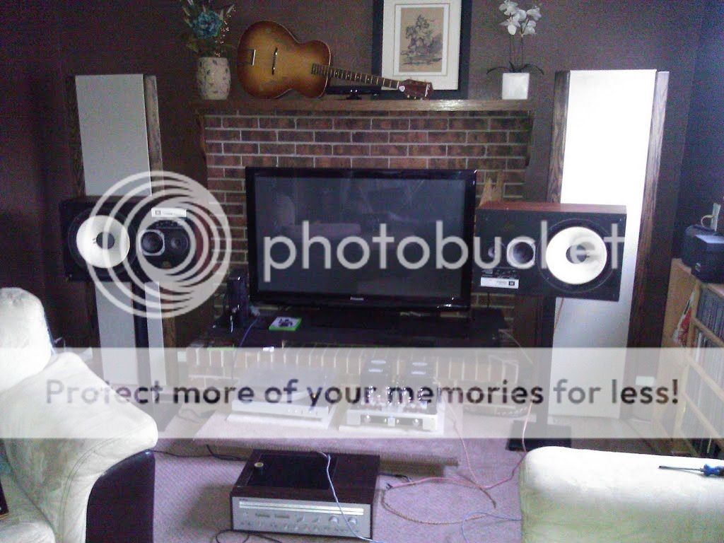

50% complete. Also have to build out matching red walnut stands.....35% done, I guess
TheHills44060
I really like the wood trim and grain on the Magnepans. Good contrast with the lighter colored panel fabric.

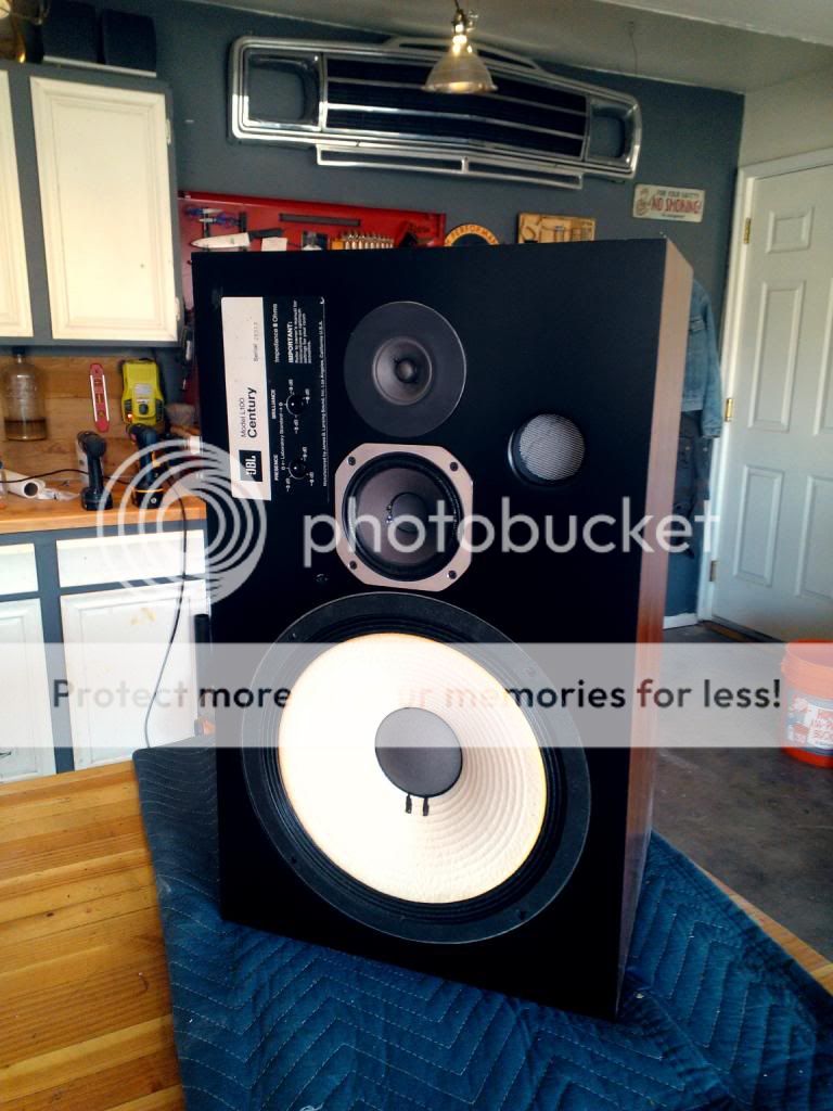

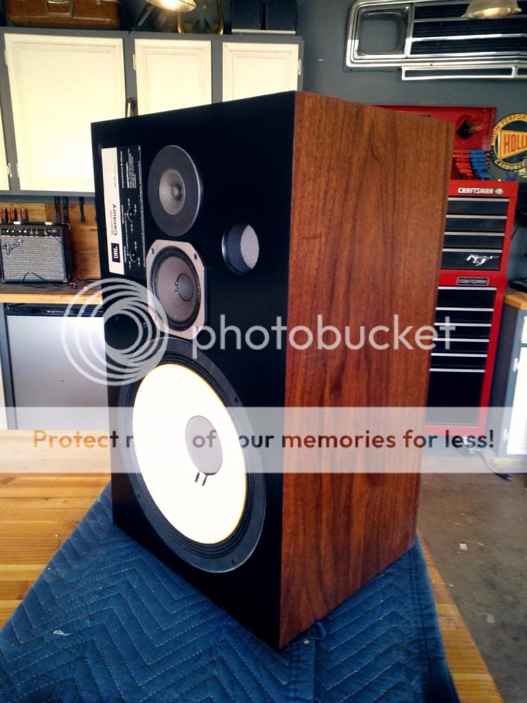

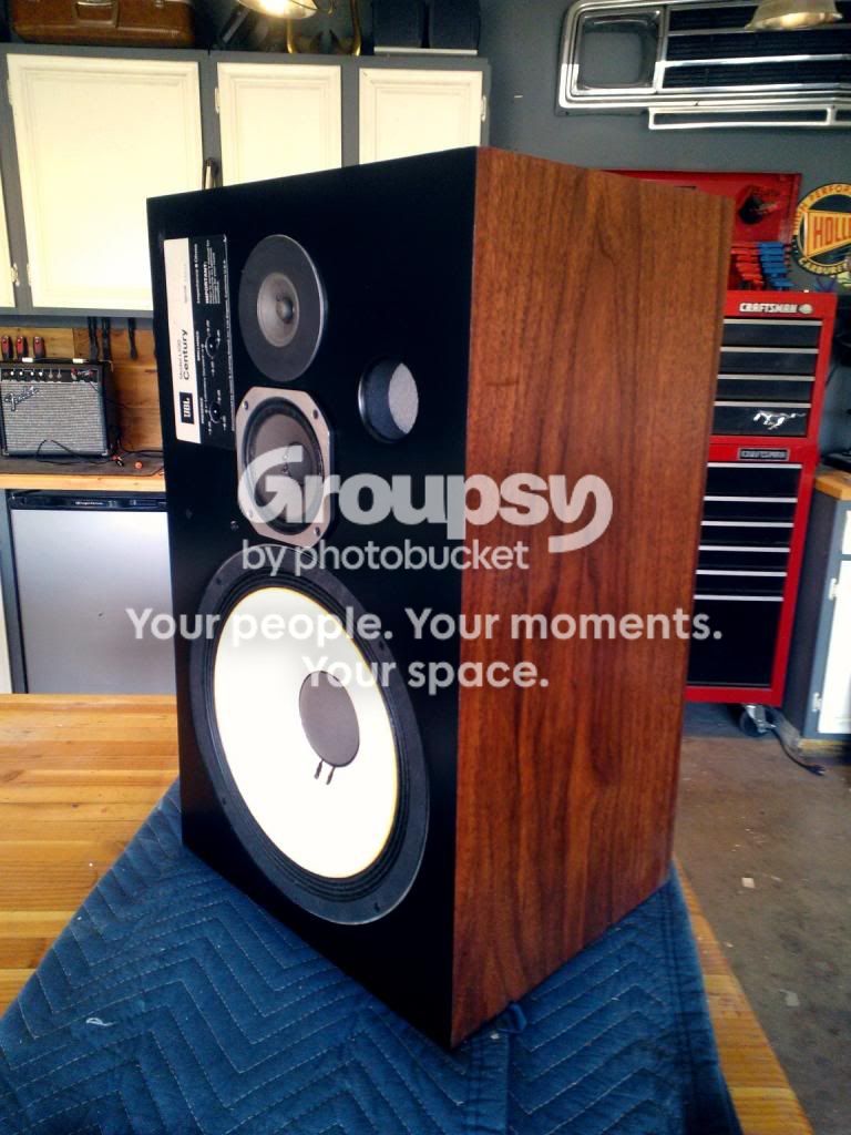

Almost complete on the JBL resto project. Another day or two, depending on temperature.

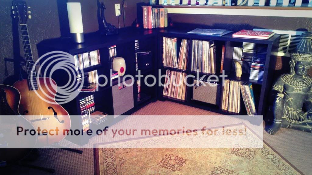

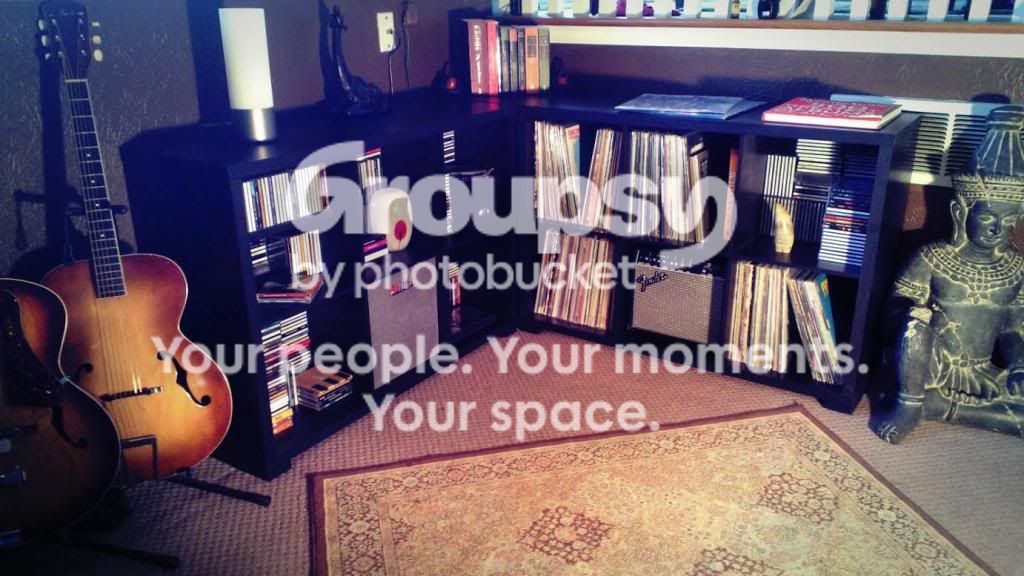

Got around to getting a new shelf setup to hold some media. Just cheap stuff from Target, similar to Ikea shelves a lot of folks use, but is made to be wide with the butt joints on the proper side.
Still have 3 shelves full of cd's in the basement, but these ones get listened to somewhat regularly stay up here.
PS- I still put them together properly...throw away those allen keys and use biscuits, dowels and wood glue.
