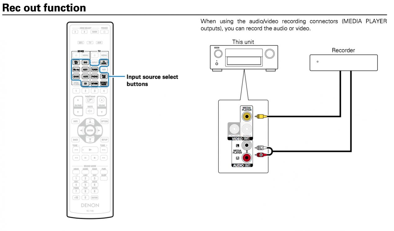

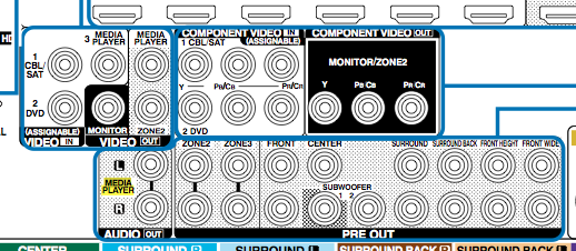

These are the only 2 audio outs I have that are not labeled as Pre Outs
1st is a Rec out
2nd is audio out for media player (yellow highlight beside the pre outs)
Should I be using one of these for output to my NAD 1700 preamp for HT
in order to use my loudspeakers on my Carver amp, and surrounds on the Denon?
I'm really sorry for so many questions, but I don't want to fry my NAD ya know?

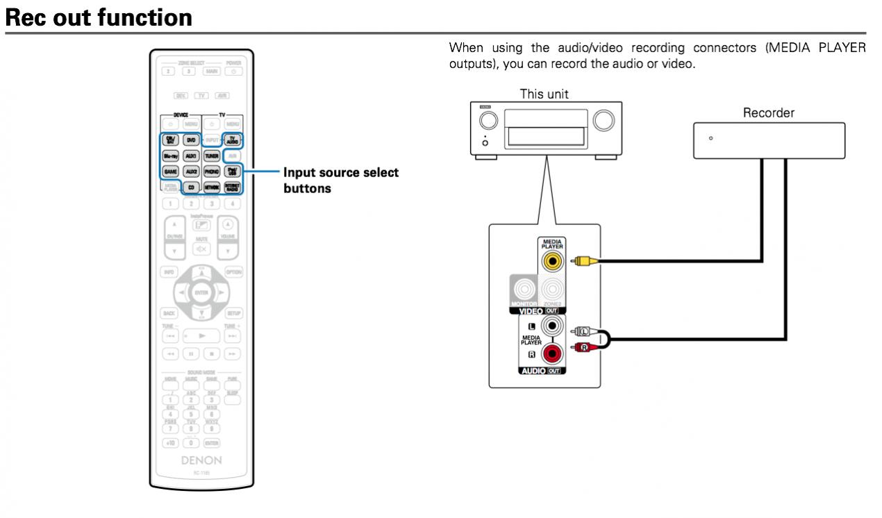

1st is a Rec out
Typically you can do anything with those kind of outputs as long as the source is analog. I am not familiar with the X-4000 so there may be a slim chance it would work with digital source but I highly doubt that would be the case. So you may be back to square one on this if you intend to use it for HT though you may try component video/analog audio.
For all those troubles, you may want to sort out what the heck is going on with your Denon(s). You seemed to be saying that you have tried two units with same results right? You could talk to their tech support and probably could insist on elevating this to talking to someone more knowledgeable than their front line customer rep. For 100% brand new units with no defects, I would bet my money on the X-4000 used as preamp vs an much older NAD1700. Don't get me wrong, I have respect for NAD too.

as the $3K T-777 which is >4V max, shoot, I thought it was 8V, darn.
The upgradable 758 and higher models, being modular design is nice. A card with Audyssey 32 can be swapped in
though we know it cannot be cheap. I should've inquired on that one. Bass Eq is not currently on the updated M-200 card
which is standard in the discontinued $4K T-787.
NAD did suggest to do a request order ticket online which I did, perhaps next week I'll hear back this time.
As to the confusion part, I cannot help you there. Giegar asked me to see what happened if I hooked up
the Acoustats to the Denon, and the SPL is similar with similar volume control as when the Denon pre outs
into the Carver. That's all I know, I was just asking him in my reply…what now, now that I've completed the test.
More than likely, it proves the NAD Normal 10V max can really peg the Carver at lower volumes than the Denon.
Also, being Fri. and near closing time, NAD was not "able" to help match an AVR of any caliber to my 1700.
Since the Carver input sensitivity is 1.7V and the Denon may be 2.5V (sorry I have only those items in my basket to compare
specs on, I do not have same test specs from same lab) it is safe to suggest that the Acoustat speakers are quite demanding
of an amp, and very much not a "green" footprint todays' in modern society.
That Denon 3808 you specd' at 8.55V sounds more promising :) Not sure I want to spend another $400 on the AVR
unless you think a cheap set of Polks or Fluance surrounds would be better suited tham a pair of Martin Logan ESLs for Rr ch ???
