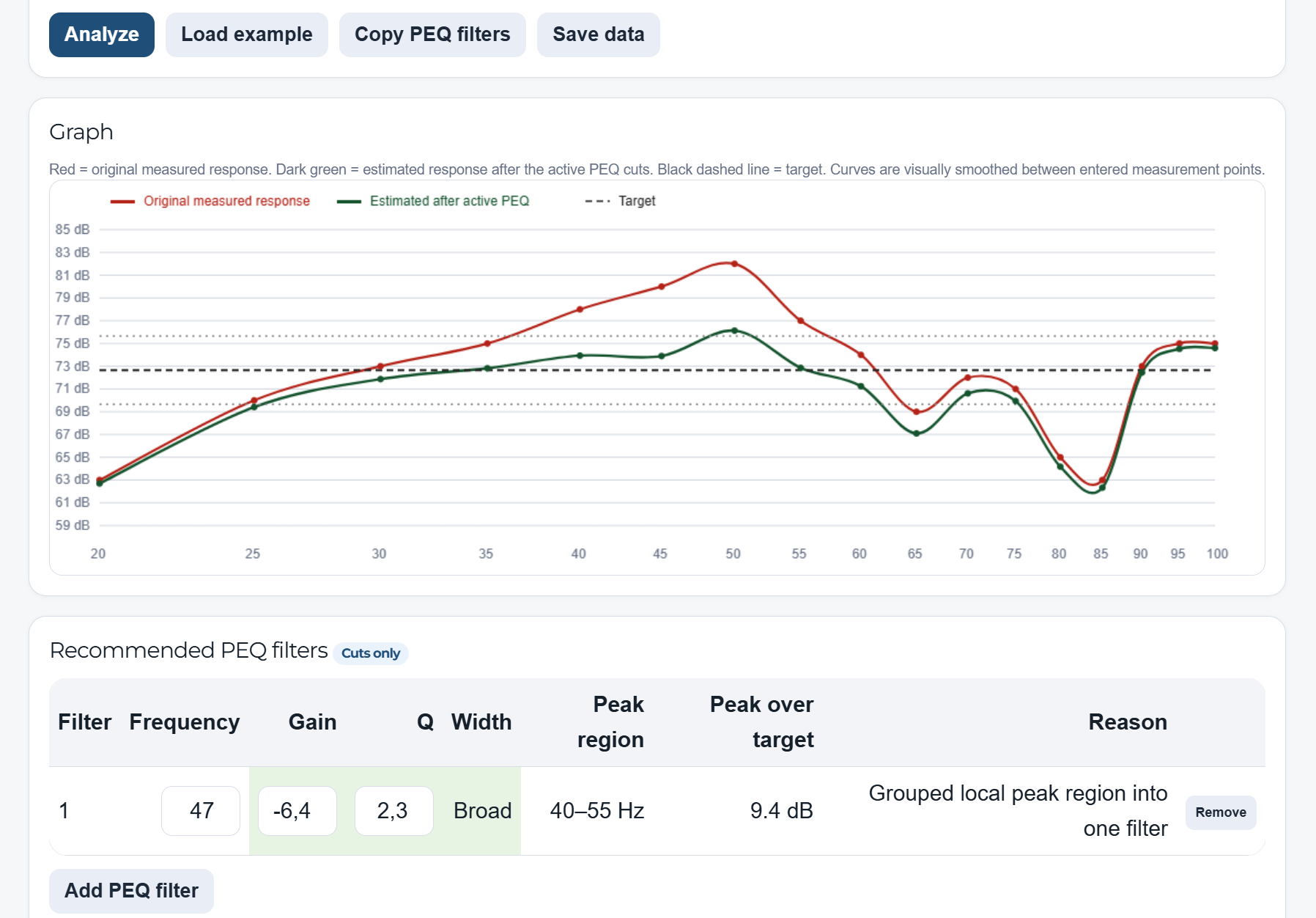

Hopefully this is the right forum, I've developed a simple but hopefully useful tool to assist with manual EQ.
So the target audience is those who
  • Have some kind of Parametric EQ capabilities in their system
  • Do not have REW & measurement microphone and/or want a simpler / more oldskool approach to measuring and adjusting
  • Do not have the competence to set the correct manual EQ and would like help with this.
Super short explanation of how it works:
It's an online tool where you can plot the frequency response from 20-100hz, easily measured using sinus tones (playlist for both Spotify and Tidal provided) and your phone.
The tool will then analyze the response, and both suggest parametric EQ adjustments, and show an estimated new response after the adjustments have been applied. You can also edit the recommendations and even add new EQ points, and the estimate will update in real time.
Finally the tool can be configured with regards to how aggressive the EQ recommendations are. By default it follows my own philosophy, which is a relatively moderate/careful approach to retain some life and bass, rather than EQing completely flat. The recommendations are only cut (no boost), but boost points can be added manually.
This was originally developed as a support tool to our own customers, but there's nothing brand specific with the tool, it will work with any unit that has PEQ capabilities. I'd be happy to get some feedback from anyone who decide to test it out! :)

Especially iphone/ipad is relatively accurate, android based phones will have more varying accuracy. But likely accurate enough for rough EQ adjustment below 100hz, which is the intended use case here. Possibly less accurate below 30-40hz.

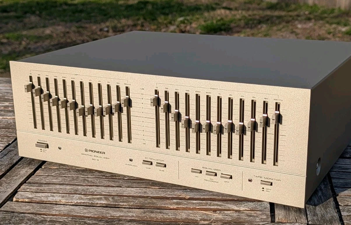

I'm sure you're familiar with the 'Happy Face' EQ curve- a lot of people used that, but didn't understand that if they boost the upper and lower ends, noise increases and it causes the amplifier to clip more easily, so they would kill their speakers. I saw that very often in the late-'70s and into the '80s. Sure, it's louder and that curve does counteract our lack of sensitivity at the upper/lower extremes, but it sounded worse WRT noise and distortion unless the volume control wasn't jacked up. At moderate levels, it was OK but it was an easy way for people to decide that it was 'better', just because it was louder when the EQ was ON.
The photo shows the Happy Face curve, raised above 0dB-
