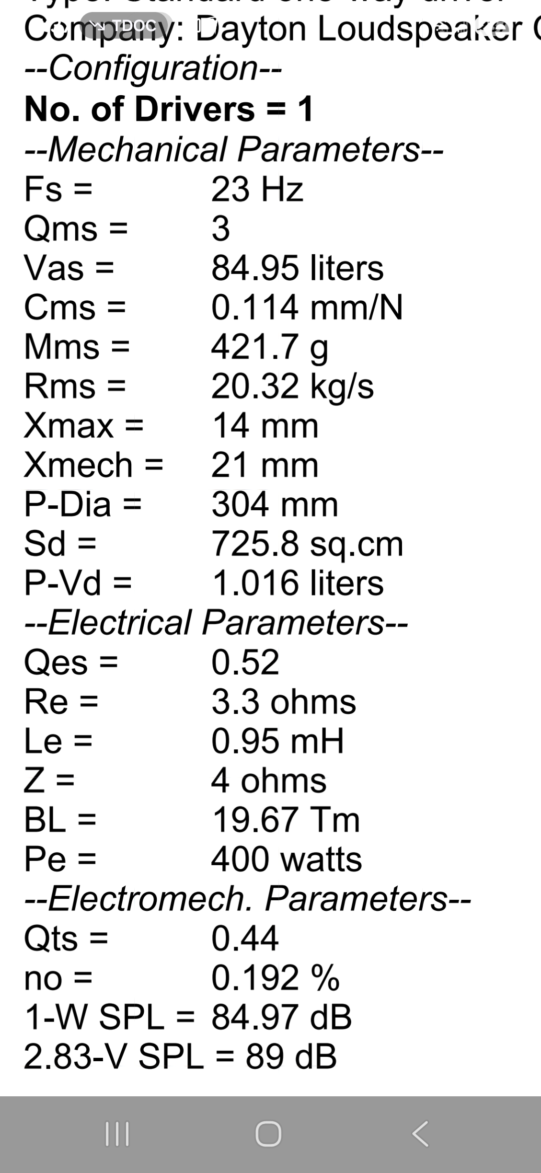

...I notices some of the t/s parameter have changed ?
I will have to update the model. They really should have given it a different model number, but I suspect the results will not be drastically different.

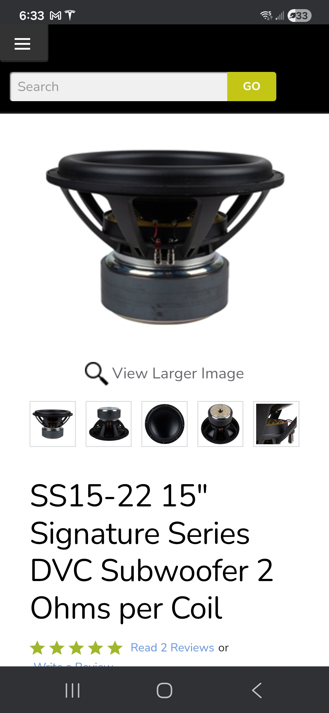

Ok,j...ust curious if you have ever tried modeling this model

This driver has a Fs of 19.5...why does Parts Express recommend an enclosure of 3cu/ft and a f3 of 27 hz ??
And what is (Vas)
Dig deeper into enclosure design- you'll need to understand other parameters on the way to the end results. There's a lot of info that creates 'deer in the headlights' reactions, at first.
Lower resonant fequency requires a very large enclosure or a very long port- think of the port as if it were a soda bottle and you're blowing across the opening and it wants to produce one note. Add water (make it shorter) and the pitch goes up, remove water (add length) and the pitch goes down- a low note requires the length and it's the same principle used in pipe organ design but there's no room in a house for a 32' or 64' pipe. The woofer in a sealed enclosure produces low frequencies if it's very large but the port is used to extend the low frequency response by tuning it (selecting the length that allows the one note to blend well with the response from the sealed enclosure).
Vas describes the compliance the resistance to movement when some force is exerted of the speaker in a specific enclosure volume- air can be compressed and a very large volume of air is very soft, a smaller volume of air offers more resistance to being compressed. In order to produce low frequencies, a speaker driver needs to move air- if it can't move much when the signal reaches it, the sound level won't be sufficient to hear it well, if at all, so the cone will need to move in & out farther (think of it as a piston). Since the cone's diameter won't increase, the only way to move more air is to increase the distance (excursion) it moves in & out.

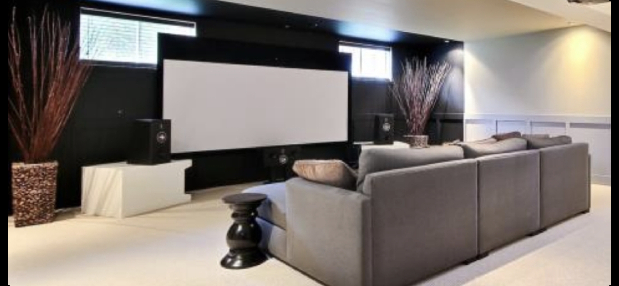

Last HT was 22x23,
next one will be 16x20x8 approx

IMO in a 16 x 20 feet room, two RSS315 subs as already recommended by TLSGuy should really be sufficient. Once installed, should you find them insufficient, you could build 2 more cabinets which you would be able to put on top of the existing ones. Then, you would also need beefy power amps that can drive 2 ohm speakers.
