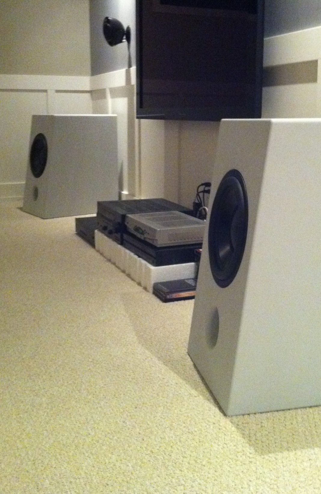

Hmm.. In 2011 I built these with RSS315 HO , 3.6 cu/ft net tuned to18hz.
Very similar to your design.
Very similar to your design.View attachment 77692
You can't arbitrarily tune a speaker to anything you want. How low it will go will always be a little above the Fs of the driver. So, you aligne the driver according to what the T/S parameters permit, and then you have to accept the resultant f3.
Oh boy !!... we where far off then, 315HO Fs is 26hz. I don't know how this affected the sound, but they did sound good
You don't need 20 Hz to sound good. Actually 30 or even 40 Hz sounds very good, ir even up to about 50 Hz for the F3
