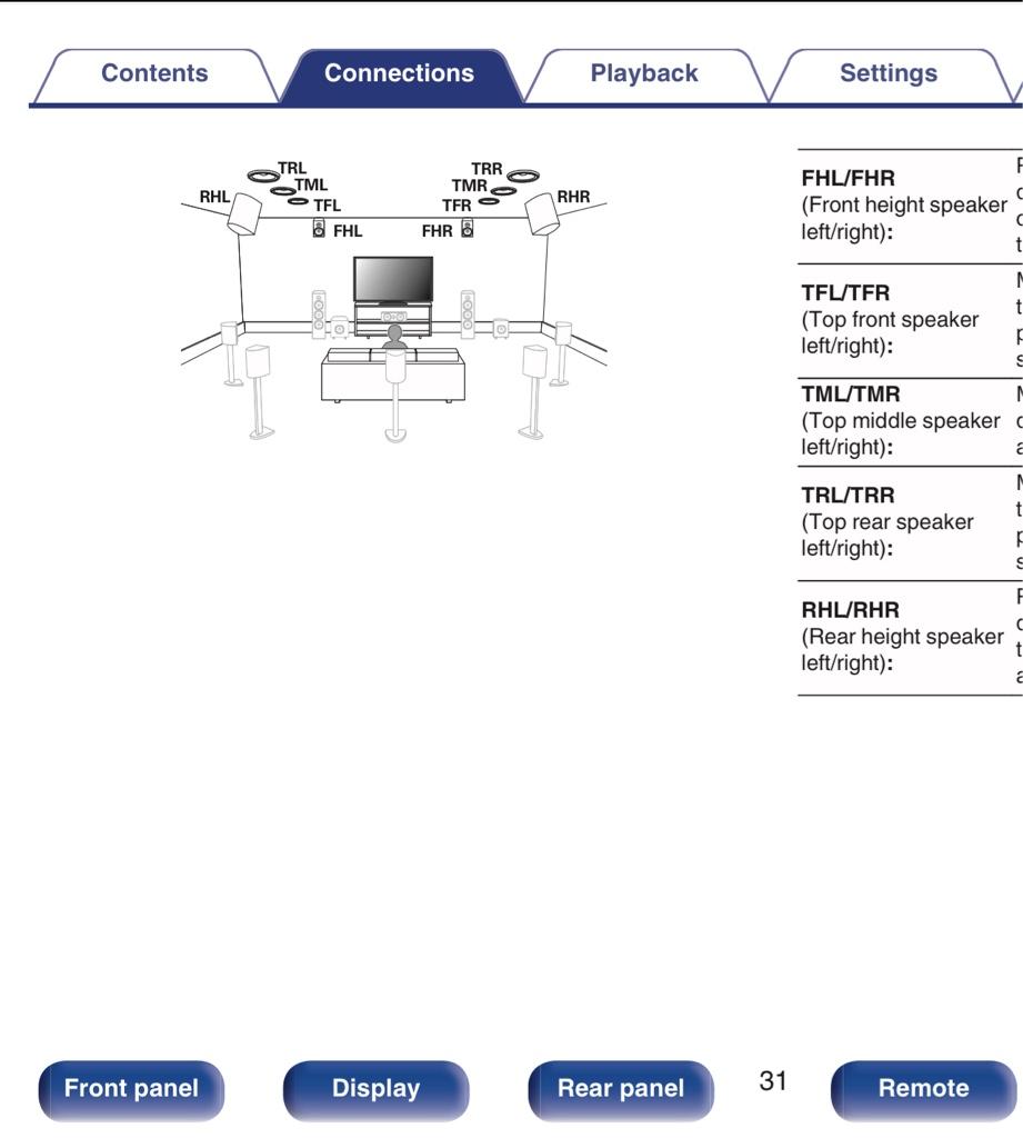

No, Dolby doesn’t use the “height” or “presence” speaker terminology though both predate Atmos. “Dolby Enabled” speaker confuses some because they should have just called it an upfiring Atmos module.
I do believe you’re right. Dolby refers to them as “overhead” speakers. They only care about angles since the renderer is based on angles. Ironically, the AVR does reference heights separately from tops seen here.
Been flapping about this shitt so long, I just lump some of it together. I agree Atmos enabled is a stoopid way to refer to upfiring modules, which could be equally confusing lol.

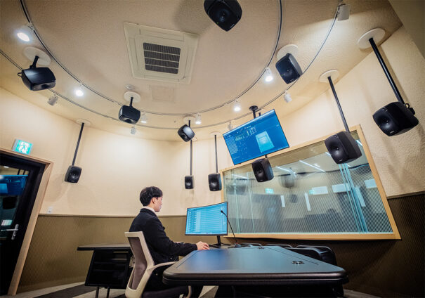

If I had a large and tall room to dedicate to it, I’d have matching speakers all the way up and around for “object based” formats. You know, like the mastering pros do. Matching surround and surround back speakers to fronts can be pulled off far more easily than ceiling mounted and upfiring “modules

I think a better collaborative between Dolby and AVR manufacturers would be nice. Like why the Fukk does Yamaha still call height/top speakers PRESENCE????? WHY?!?!?! Fukk….. talk about muddying the waters. But now it’s my turn to digress lol.

Wow, Dolby Atmos speaker placement is confusing. According to this great Dolby setup page, I'm best doing what I stated above.
The first part states my surround speakers can be 1.25 x the listeners ear level which puts me roughly at the 1' above the listeners ear level I want to be at.
It appears that 7.1 is dolby surround and not considered Atmos surround even though the Atmos signal is used. It's only considered Atmos surround when sound comes from the ceiling of the room. So they call 7.1 atmos when used with virtualized speakers. So speaker virtualization should work since my surround speakers will be low enough if I choose to use the speaker virtualizer. Surprised none of the receiver maker's say you can go 1.25X ear level as they all say must be at ear level.
After looking at this document, no way, no how will any atmos height speaker, top rear speaker, or rear atmos enabled speaker ever work in my setup. It also appears that they don't recommend rear atmos speakers until the front atmos speakers are installed. So no rear atmos speakers should be installed if no front atmos speakers are installed. Interesting as the Onkyo allows rear atmos enabled speakers, rear top speakers, and rear height speakers. Denon allows rear atmos enabled speakers with no front atmos speakers. Only the Yamaha receiver would not allow rear atmos speakers for their 7.1 receivers which is what Dolby seems to be saying.
Trebdp83
In a 5.1.2 setup, top middle would be the optimal location for atmos speakers. Top front and top rear would be the optimal locations for 5.1.4 or 7.1.4 atmos configurations.
Some simply cannot accommodate height speakers in their setup. They can try height virtualization with their 5.1 or 7.1 setups after making any necessary speaker location adjustments.

Confusing indeed. Not to mention there are at least a few different “guides” out there.
Just one note mike. The 1.25X reference is to the height of your mains not ears. I know, it’s almost probably the same thing but all the measurements and angles are referenced to the other speakers with the exception of the seated ear to ceiling measurement to find 45° fore and aft.
