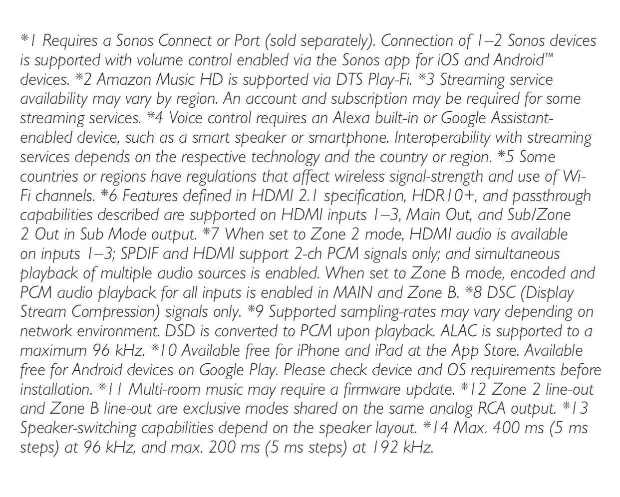

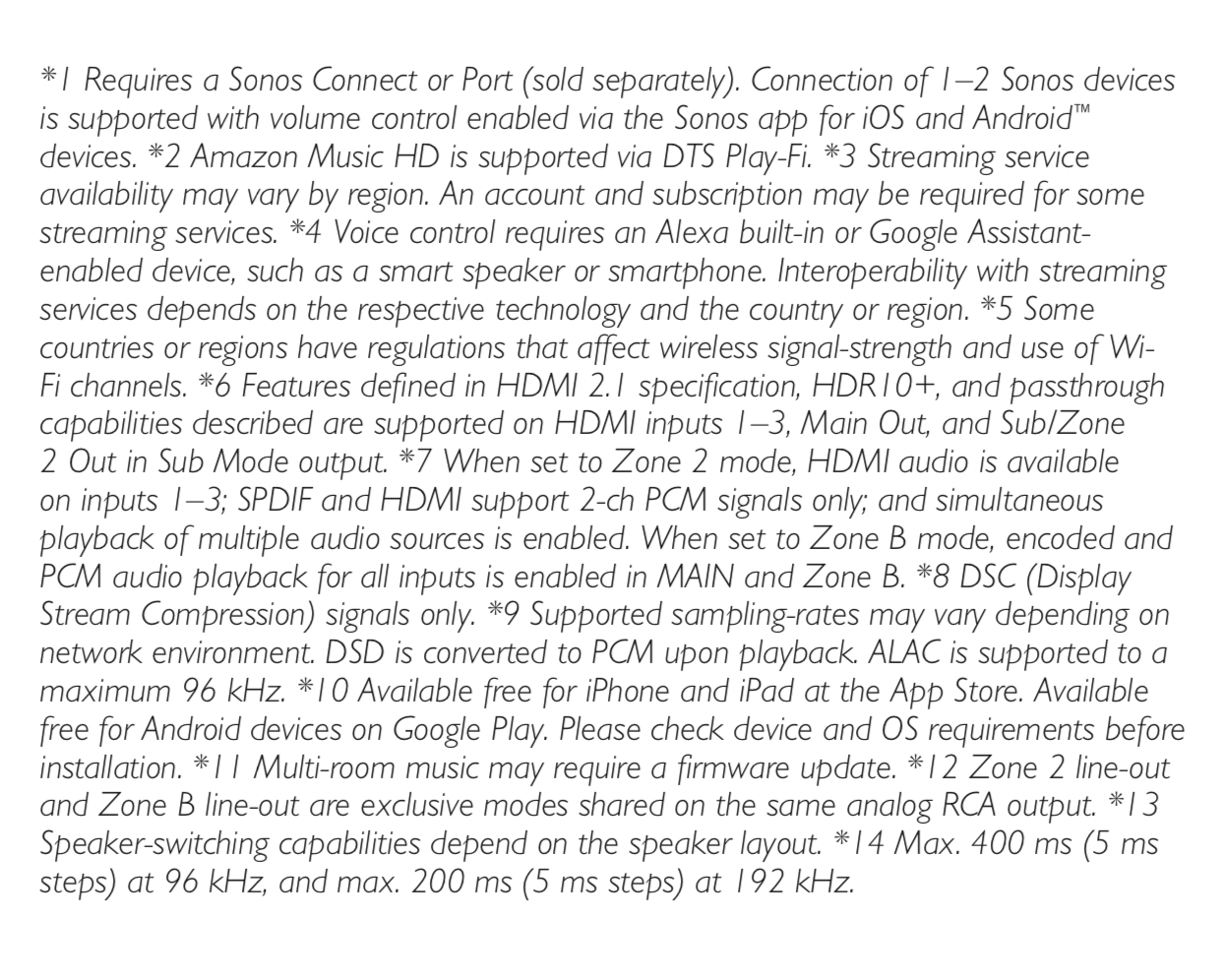

I believe that TV supports HDR10+. The Onkyo TX-NR6050 will pass an HDR10+ signal from Amazon devices to the TV BUT, they must be connected to HDMI ports 1-3. Ports 4-6 will not pass HDR10+.

I been reading through the manual and seen nothing about HDR10+ being limited to HDMI 1-3. How did you find out, trial and error?
Yes, I do use HDR10+ on Prime Video. It looks very similar to Dolby Vision, both being much better than HDR10.
Is the Dolby Vision limited to HDMI 1-3 as well?
That pretty much takes away 3 useful HDMI inputs as I thought all the HDR formats should be compatible with all HDMI inputs since they are tied to 4K and not 8K.

The manual is flawed in a few ways. I found the fine print on the product sheet. I confirmed it on my own receiver when trying to view HDR10+ material from Amazon Prime using HDMI port #4. But, Dolby Vision is available from HDMI ports 1-6.

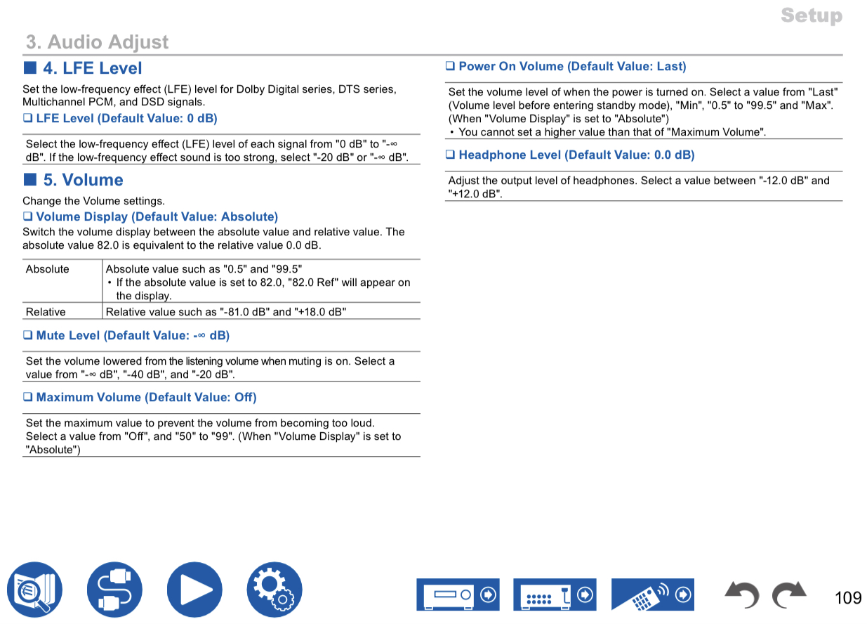

Another feature that is also missing in the receiver but is mentioned in the manual is the “Relative” (-dB - +dB) volume display setting. Only Absolute(0 on up) volume display is actually present. Some have been annoyed by the omission.

Wow, those footnotes are something. Hidden in the fine print.
Yeh, I may not be happy with no relative volume. I've always had that on my receivers that had digital volume controls.

You mean reference volume scale?

Pretty crappy the important footnotes are in a marketing sheet but not in the actual manual.
