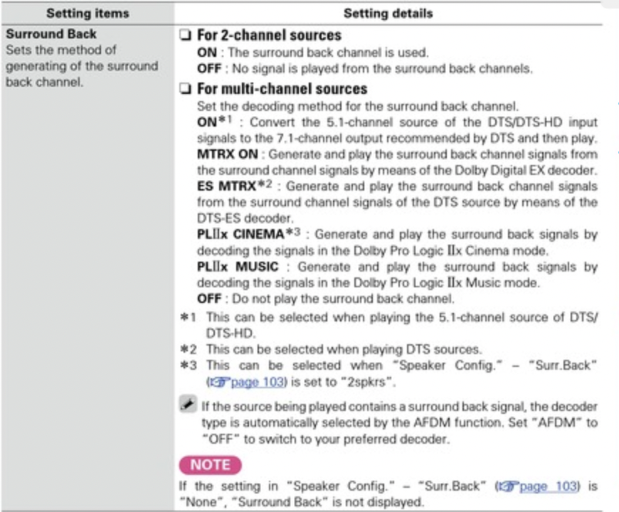

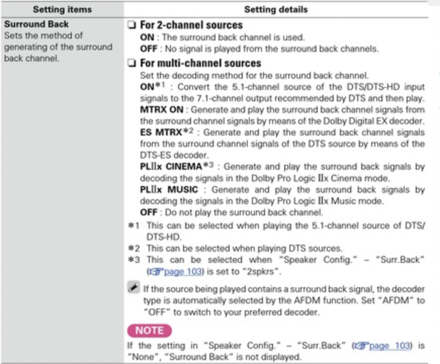

I didn't like applying Dolby PLIIx to anything on my older Denon's and not just because it changed the front panel display and added + DPLIIx to the end of everything when playing 5.1 signals. The NON MTRX mode just duplicated the surround info into the surround back speakers and did not change the display on the front panel because there was no additional processing being applied to the signal. This feature was removed and gone by the time the 2312 rolled around.

The surrounds will play if in Dolby Surround mode while playing a 5.1channel signal or if the input signal is a 7.1 channel signal using a 7.1 speaker configuration. But, in a case involving a Dolby Digital signal and a sound mode selection of just DD and not Dolby Surround using a 7.1 configuration , the surround speakers may not produce sound. I've experienced it and it is an issue going back years with Onkyo models.
The quirks of the Dolby and DTS up mixers can be eliminated simply by reconfiguring a 7.1 setup to a 5.1.2 setup if a room and speakers can accommodate switch. With the new up mixers, more is gained in a 5.1.2 setup than is lost when changing from a 7.1 setup. But, it simply isn't an option for one reason or another in many rooms. If one has elevated surround and surround back speakers that were placed many years ago for a 7.1 setup, they would need to be lowered to accommodate a set of height speakers and even need to be lowered to optimize the effects of height virtualization.

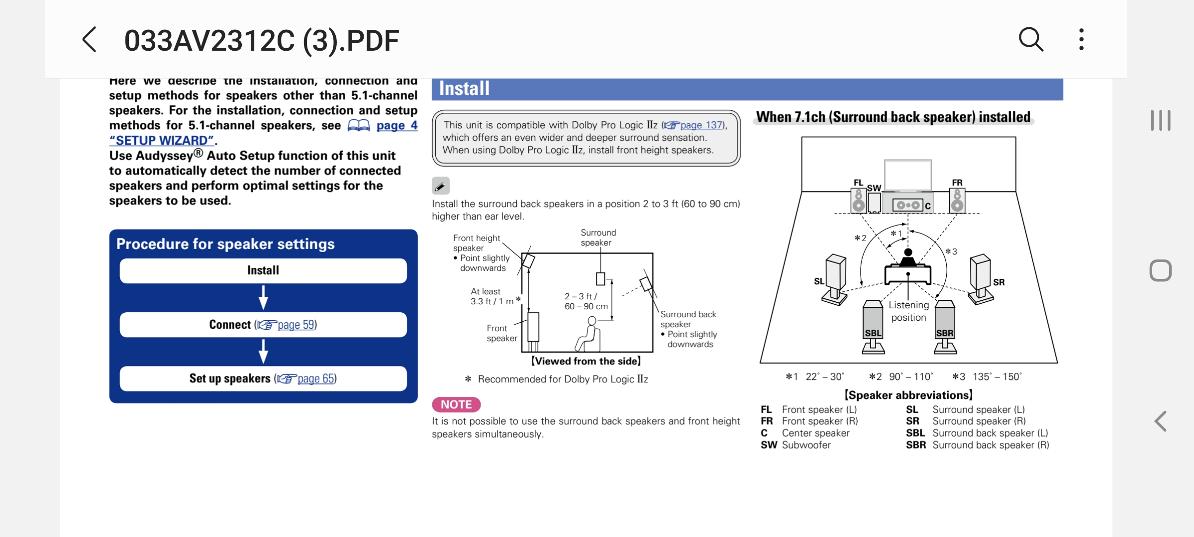

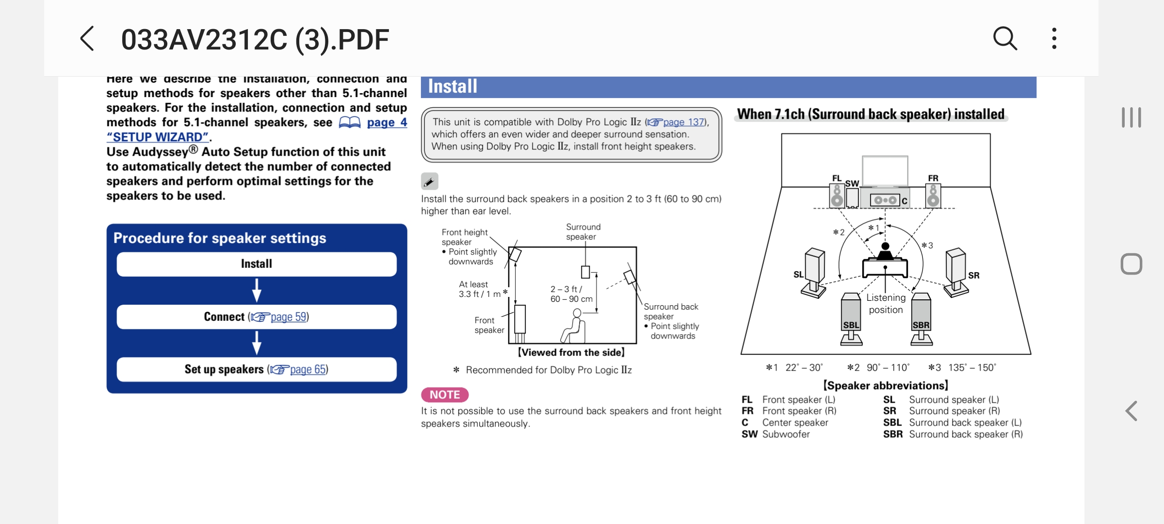

Yep very similar to my Denon AVR-2312ci

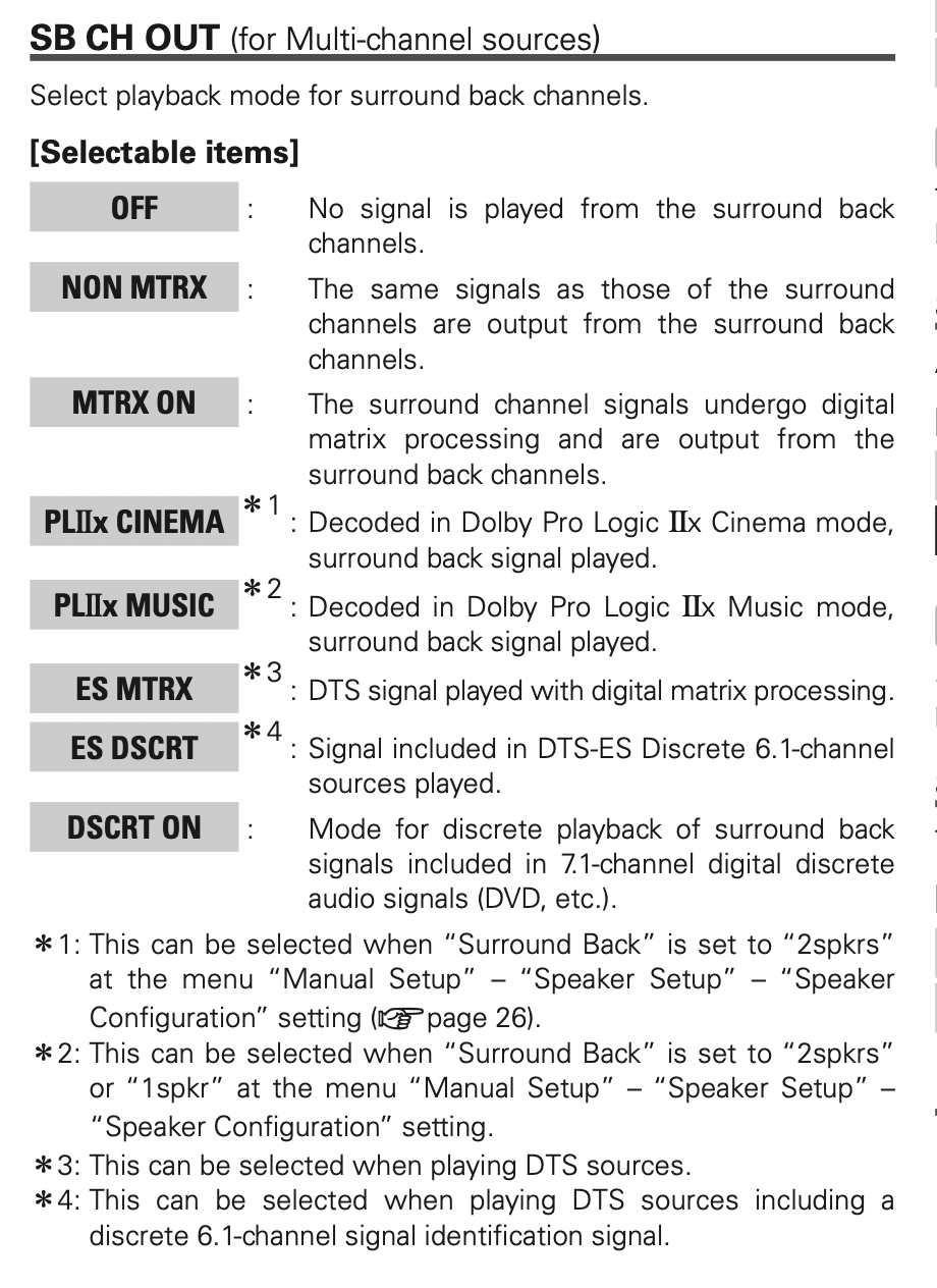

Hey Treb!
What Onkyo did you have? I had an 808, but don’t ever remember the NON MTRX etc. it was a great AVR though.
Hey Treb!
I thought he was refering to the Denon receiver. My old avr-3803 had non- matrix mode or which was surround channel info in surround back channel, but newer AVR-2312ci done away with that option.
Yeah thought he was referring to his older Denons. Looked at my 3808 manual, it does appear to have this matrix/non-matrix setting but don't remember it from delving into the setup menu....when it gets less smoky out there I'll check that out. I do remember I can set the rear surrounds a coupla different ways on that model more than my newer one.....
It’s just another in the list of things wrong with that silly manual. Even the others need to be changed to add the word SAME when referring to the sound produced by the surround back speakers in those sound modes with those dolby signals. It’s doing automatically, though maybe not fully, what could be done with the older Denons with a setting change. The first of the two pics in my last post were from the Denon XX08/XX8 models and the second from the Denon 2312CI. Don’t know why Denon didn’t just leave it alone.
Still annoyed by surround info going out from only the surround back speakers in some cases using a 7.1 configuration in the 6050. But, I don’t use it but for experimentation sometimes. Heck, the 7100 pulls the same thing apparently with some dolby signals AND with IMAX Enhanced DTS signals. I‘m over the changing behaviors based on changing modes.
It shouldn’t be so difficult to figure out exactly what is going on in new receivers when considering how things have worked in the past. Onkyo dropped the ball on the 6050 manual. Yamaha did as much with the RX-V6A upon its release but then, after several firmware updates, put out a revised manual to reflect the new features and functionality. Onkyo needs to rewrite the 6050 manual so poor souls don’t have to go looking for answers online.
Yeah I’m dumm today… was actually dozing off while going through this thread lol…
