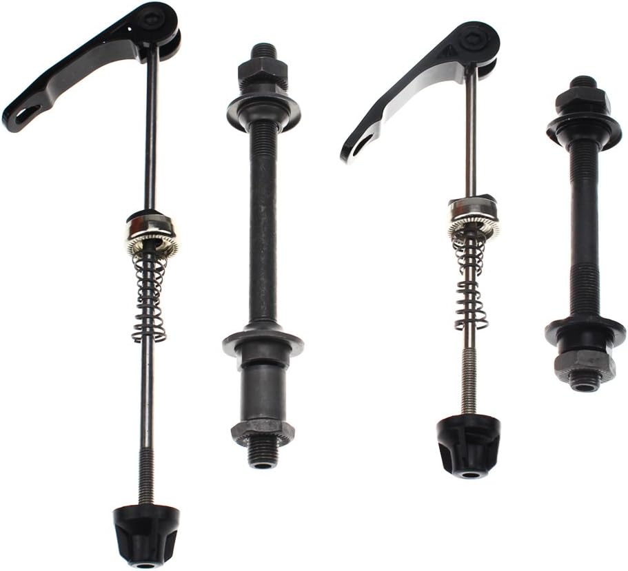

What spacers and axle rod? You couldn't get the quick release to tighten? Got a pic?
Which the quick release skewer goes through. I call it the axle rod or hub axle. If I tighten the quick release any more the wheel won't move. It still moves from side to side regardless. I call it the spacer but basically the nuts on the ends of the axle rod.
Not the exact but so were on the same page.....
Okay that clears it up...it sounds like you could get the quick release tight enough and the problem was the axle bearing adjustment (the nuts at each end are the locking axle nuts I referred to earlier). How are the bearings?
What hub models are they? Try this article for adjustment https://www.sheldonbrown.com/cone-adjustment.html
I'll get back to you on the hub model. The bearings seem fine as far as I can tell. I'm guessing it's the cones that need adjusting.
