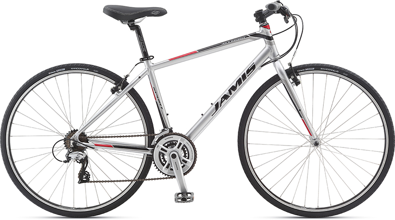

I own a 2014 Jamis Allegro Sport but have to find derailleurs, cassette, and a crankset for it. I might end up looking on craigslist if the cost is too much. Maybe a gearless bike, but loathe the thought of going uphill w/o. In the meantime it's replace the back tire with a Bell brand LOL. I can't believe I did that. Should've stuck with the Continental LOL.

Jamis Allegro Sport
Derailleurs
Shimano Acera RD-M360 rear, FD-M191 bottom pull front
Cassette
SRAM PG 820 8-Speed 11-32T
Crankset
Shimano FC-M171 triple, 48/38/28, 175mm
BB Set
FSA sealed cartridge, 68X110.5mm
Brakes
Tektro RX-1.0 linear-pull with front power modulator and Shimano brake levers

They haven't completely worn out. After five years with the Jamis it's time to replace the parts. I can probably get by for another season but would rather start looking now for deals. I ride 4-5 days to work and back. A little over 4 miles each way. The incline on the way back is about 2+ miles LOL. I'd say gradual incline thankfully.

Replacing. The sprockets on the cassette, crank wheel etc are going. It shifts but not very good.
My bad. The Jamis specifically, but if you have parts for the Surly I'd consider that too.
