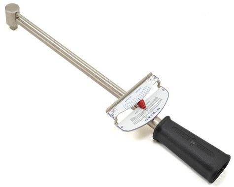

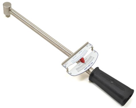

@Dude#1279435 it should be noted that for a bike, you will have both right-hand and left-hand threads in a few places. My big torque wrench can set the proper torque in both directions. That is not a given, so you have to look for that feature.
Good point. My Park TW-2 looks like this, doesnt care about direction, has a scale in both of them :) I don't think I've needed my other torque wrench except on normal threadings....
