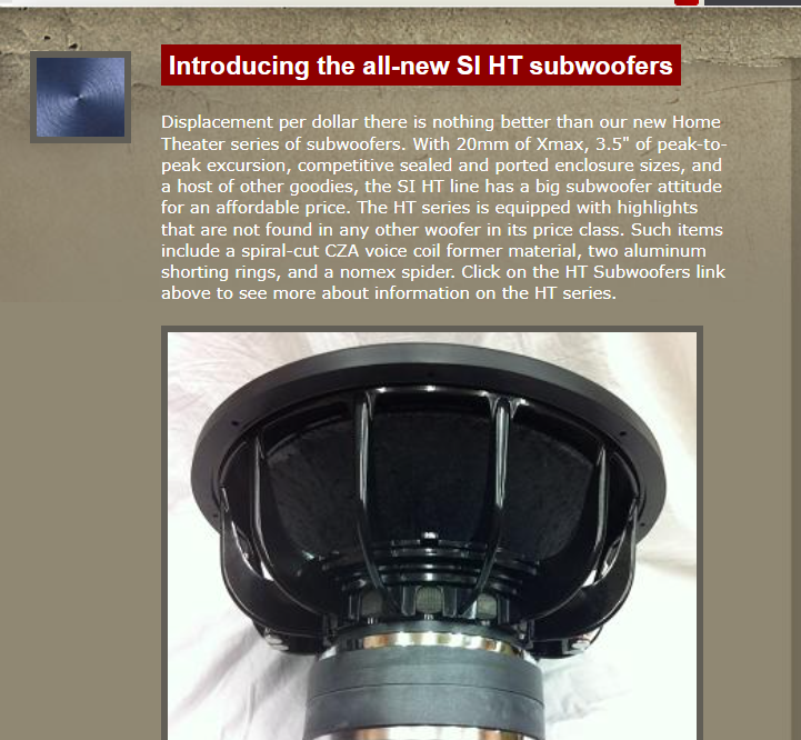

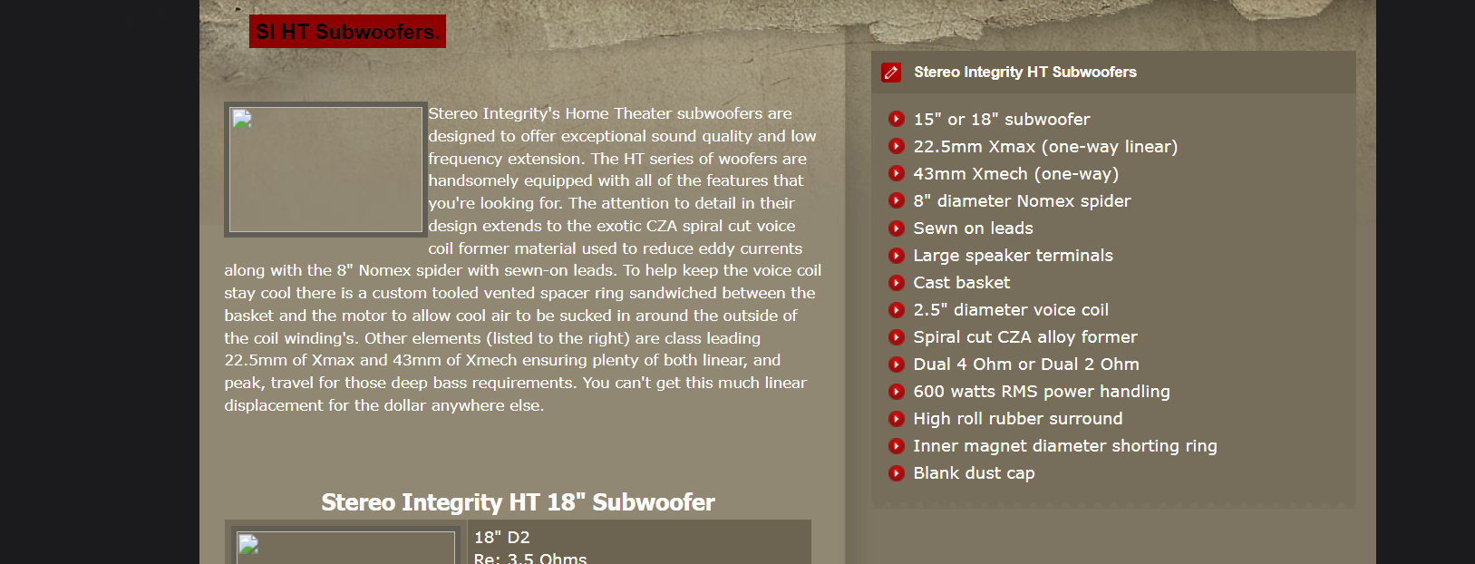

It looks like a competition car sub. I have the ht version and it gets really loud for a lower wattage sub. But it’s discontinued would had been better. Dayton has multiple good drivers that’s the brand I almost went with .

https://www.avsforum.com/posts/64273287/how can it only be 28 pounds with that big magnet? It looks like my ht model with higher power handing , Xmax . If specs hold up.
Subwoofers Specifications
Quick Info
Weight28 lbs
Dimensions (OD)15.55 inches
Dimensions (Cutout)14.20 inches
Mounting Depth7.4 inches
Displacement0.16 cubic feet
RMS1000 watts
