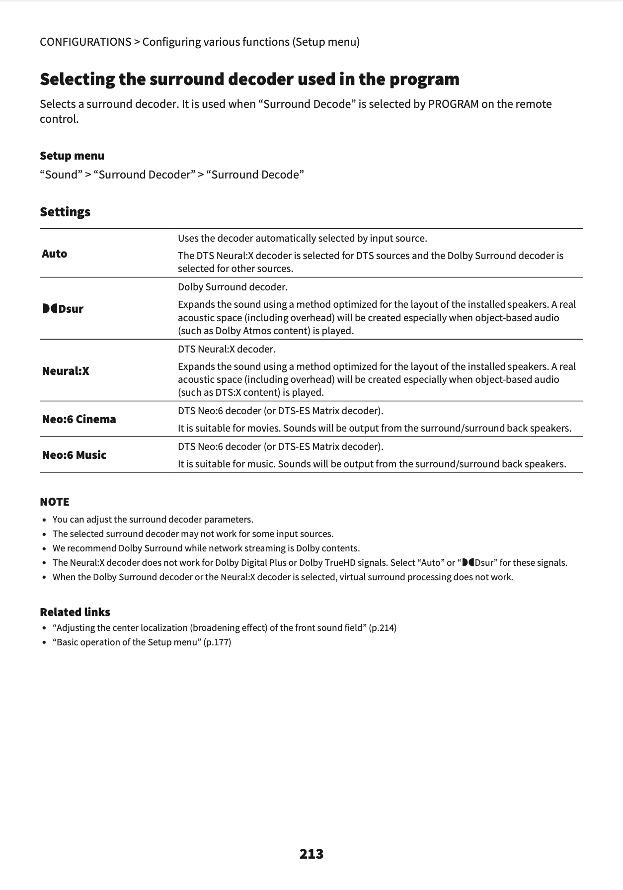

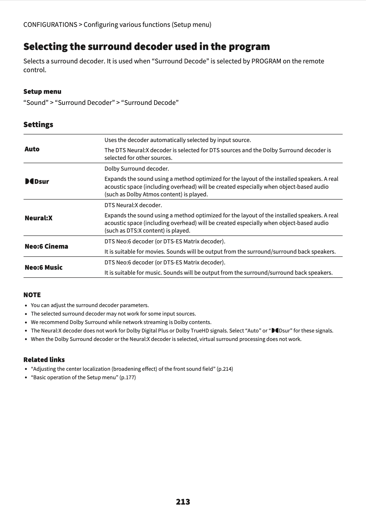

Yamaha allows the selection of Dolby Surround even when the track is Atmos. That is the case anyway with my little droid.This is not the case with other brand AVRs. Some say it does nothing when playing back Atmos tracks. Yamaha says otherwise in their manuals. I'll leave it to others to contact them as I'm kinda' over it myself.;)

“DSU” is an abbreviation for Dolby Surround upmixer. The page included in the above post is from the manual of the Yamaha RX-V6A which includes dated DTS Neo:6 and added Dolby Atmos Height Virtualization in a firmware update.
Below is a page from the Yamaha RX-A8A manual. It is very much the same, save for the lack of dated DTS Neo:6. Notice the inability to apply DTS Neural:X to Dolby Digital Plus tracks. My Onkyo can apply DTS Neural:X and Virtual:X to DD+ all day long.
While I cannot apply any other processing to Atmos tracks other than “Straight” decoding and also cannot apply Center Spread in the Onkyo, my Yamaha can apply DTS Neo:6 to Atmos tracks and also allows Dolby Center Spread.
Licensing deals enhance as well as impair features in different products from different manufacturers. Dolby has a nice menu but most of what they serve up is ‘a la carte.;)
