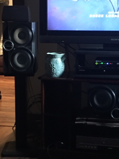

Okay, I'm just gonna come right out and ask... Why are you avoiding posting images of the actual speakers you're talking about..? Are they embarrassing to you or something?
LOL thought I avoided cameras, even tho that's near impossible with today's phones.....
Pogre
Pogre
Yeah I think he’s confused we need pictures or something!! I say op should just get something better and sell them if he does not want to waste money on New surrounds . I don’t see point of a speaker with a False woofer .
Little ported bookshelf probably produces better bass .
Rtr is a good vintage brand to look out for .

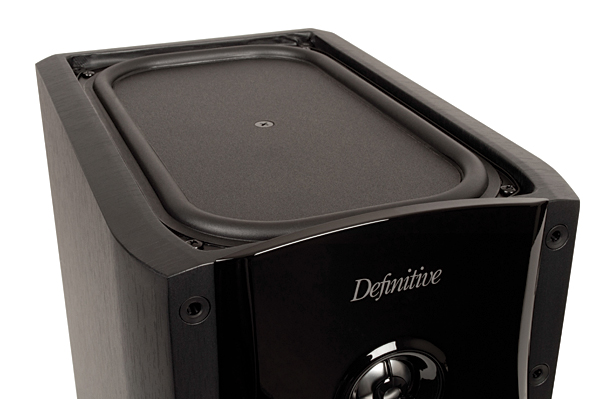

Okay, just for the record it's not a "false woofer". It's a passive radiator that's designed to move with the other speaker instead of using a port. A lot of manufacturers use them in their speakers and subs. I had a pair of DefTechs with passive radiators like that (SM55s) and I thought they sounded pretty good actually.
Wiki link explaining passive radiators.
Because I don't upload anything to the internet and I'm not about to start now when the links I provided are an exact replica of what my speakers currently look like, for anyone who still cares, if you have any new recommendations for floor or tower speakers, the least expensive you know of that still provide some quality as I often find for my listening style, the basic ones provide a clean sound.

If I knew more about speaker design I’d say replace the bottom woofer with something real and refoamed the top one .
That would probably work out worse. A passive radiator works in a "push-pull" tandem with the active woofer. Replacing it with a second active woofer will cause them both to move in sync (push-push) and there's nowhere for that pressure inside the cabinet to go. They will work against each other, and with enough power one could even get damaged.
Now there are systems which are built this way (acoustic suspension), but the woofer's and cabinet alike have to be designed for this purpose. http://www.hifi-classic.net/review/advent-heritage-9.html
