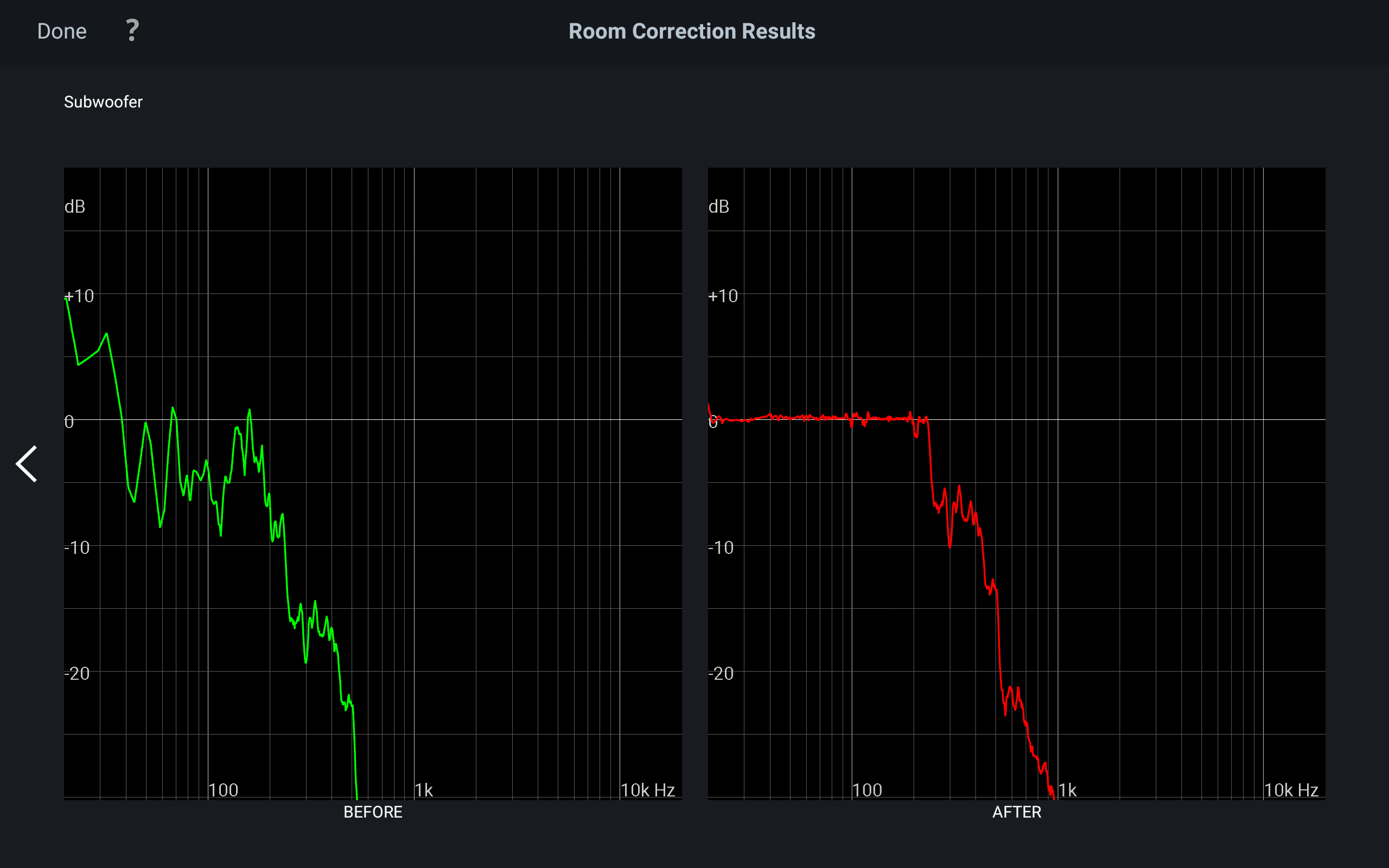

1) i stay with this sub. The last graphics from audyssey (falling at 40hz)they are permanent on a position on the corner. The weird thing is that from the whole corner ONLY ONE SPECIFIC place gives this graph and even if i turn it/push it 2 cm, it looses it and goes to a much much worse performance. So maybe it confuses the audyssey? Or it gives sub just to my 1st mic position? Dunno its very weird. Volume knob is at 35% and audyssey still gives -8db correction... is it ok?

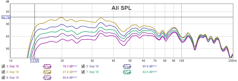

The "after" graphs that Audyssey shows aren't actual measurements. They're a target. Check this out.
I posted this so you can see the differences between Audyssey's target and actual in room accurate measurements. As far as your sub options I'd be all over the SVS SB1000. I believe it will greatly outperform what you have now. Is there a reason for a sealed box design over ported? I prefer ported myself, but they are a bit larger. Also, if you look for a SB1000 with the oak veneer you can save a couple of bucks. They're black, but to me that's a non issue.

What are the colourfull lines represent and where is audyssey?
So you are saying that my sub doesnt play as good as it shows? What i can do to measure better?

The colorful lines represent the frequency response of my subs with Audyssey's FLAT setting. Each line represents a different DEQ setting in my AVR. OFF, and ON with the 4 different reference level offsets (0, 5, 10 and 15).
I don't know if your sub is playing as low as the "After" Audyssey chart shows or not. It might be spot on. I'm just pointing out that it CAN be inaccurate. The only way to tell is to do sweeps with a good measurement mic and a program like REW (how I got the chart with the colorful lines).

What about my charts? Why your “room correction before” green line comes from up and in my chart comes from down?

What about my charts? Why your room correction before green line comes from up and in my chart comes from down?
The before charts are what Audyssey measured in your room. It uses that measurement to make adjustments for a flat response. My room and speakers measure differently from your room and speakers. No 2 rooms or speakers will measure the same.

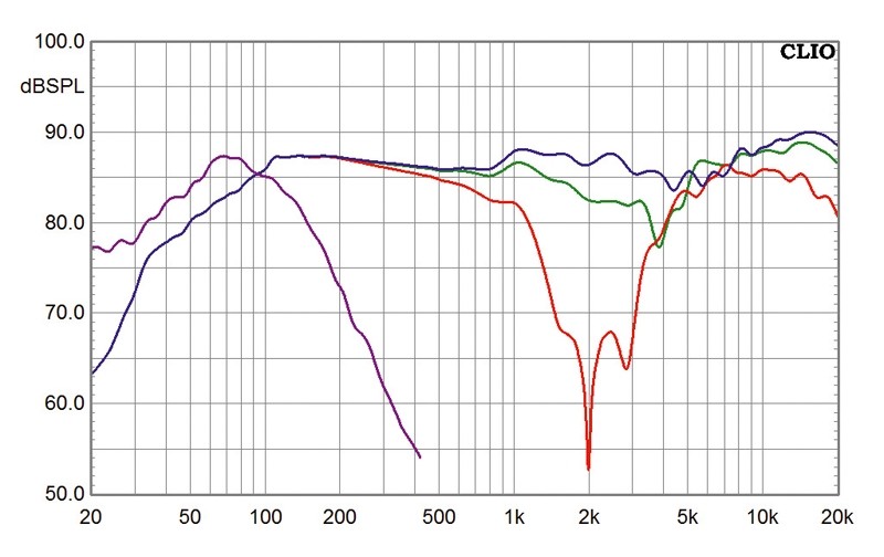

That graph shows us the same thing the graphs you posted shows us. That sub drops off at 60 hz doesn't have much below 50 hz.

The "after" curve looks perfect according to Audyssey's chart, but it doesn't measure that way when I use different, more accurate software and a mic to take measurements. The "after" chart that Audyssey shows is not a measurement. It's a target. Audyssey will do its best to get there, but you need measurement software and a good mic so you can see where it really is. We keep telling you this over and over. Those Audyssey charts are not accurate enough to go by, especially "after". "After" is not an actual measurement. It's a goal, target, prediction or what it's going to try to do.
