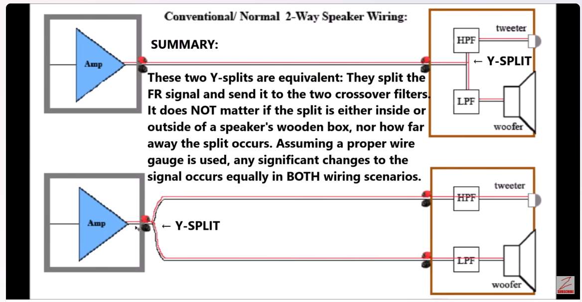

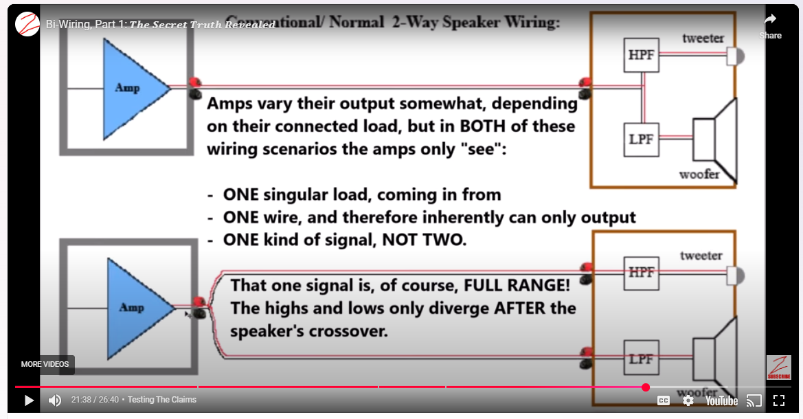

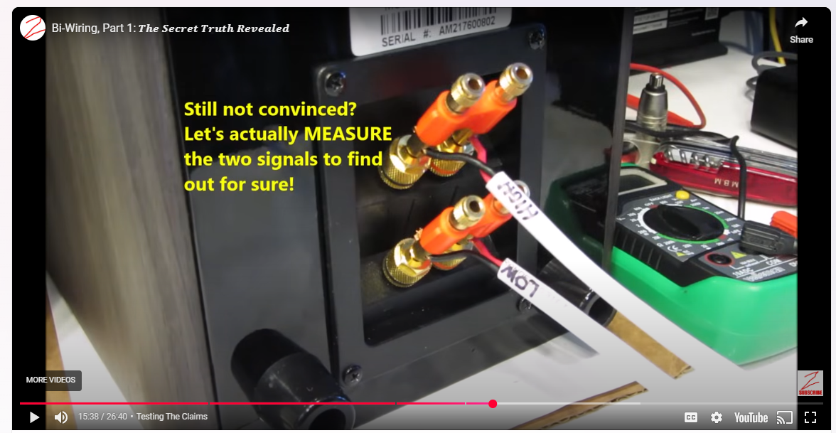

your were right about the voltage being the same, but the current in the wire is different,
Sounds like you've fallen for the exact same clever trick nearly everyone does, even EEs.: you aren't comparing the current at the truly analogous locations in the bi-wire vs. single wire circuits. Luckily I have a secondary video, called Part 2, mostly focusing on exactly this very point (best viewed in full screen mode):

No Mike, I am not one of those who would fall for such "trick", absolutely not. I tried to base my comments on electrical principles. The video you posted is irrelevant to my point, that has nothing to do with wire size, skin effects of whatever, my point is just about the fact that in bi-wire, when done the way it is supposed to be, the current (in terms of frequency spectrum) will be different and can be shown in a scope easily, while the magnitude, in amperes can be measured by a clamp on meter. Wire size of course will have effect, but again in this case, I am ignoring that totally anyway.
My issue, and as I did say I was nitpicking, is that in you part 1 video you demoed the signals were not changed in the two wire feeds, one for the tweeter, the other for the woofer. That is of course true, but you in the demo you measure voltage, that of course would be the same. That does not mean the currents in the two pair of wires/path are the same, and they are 100% not the same if you measured it at the time you did the demo.
The thing is, ff you were to measure currents, then, as you obviously know, the feed wires still have to through the crossover network, so the tweeter feed wire will not be full bandwidth anymore for the bi-wire scenerio, because then the crossover network would have been split into LPF and HPF you shown in your diagram, when the jumpers are removed.
So, in your diagram below, you would be technically incorrect to say the highs and lows only diverge after the speakers crossover, it is a series circuit, that means even before the each pair of wires touches the HPF and LPF terminals, the signal current would already have split. You can measure the currents easily with a clamp on ammeter, and I have done that just to see the difference. I think you know I am right.:)
You did a fantastic job on those videos to debunk a myth, and I don't mean to nit prick even if I seem to be doing it, I just truly want to highlight this slight technical issue in those demoes as presented, that I thought might, just might, unintentionally mislead someone to think that in bi-wire, both pairs of wires would in fact carry the exact same signal current, when that is not true, though it really won't make a difference in reality, to sound quality.
