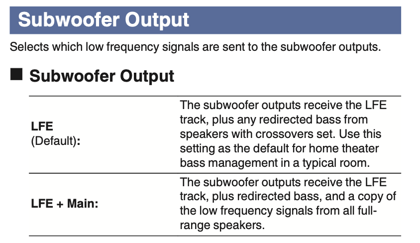

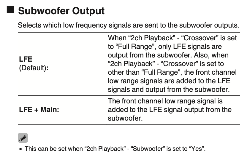

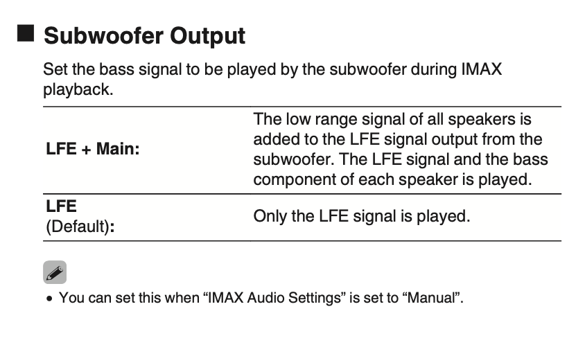

Some still confuse LFE channel info from 5.1/7.1 signals with low frequencies from 2.0 signals. While both can be output from the subwoofer pre out depending on AVP/AVR settings, they are not the same thing.
This is why Denon/Marantz offers the LFE + Main(Low Frequency Effects from the LFE .1 channel in 5.1/7.1 signals + Low Frequencies from 2.0 signals in the Mains) setting for the Subwoofer output so that lower frequencies from 2.0 signals can be output from subwoofers when speakers are set to Large or when selecting Direct or Pure Direct modes regardless of speaker size settings.
The Yamaha RX-A6A, the actual subject of the thread, has no such feature and like other Yamahas is equipped with Yamaha’s “Extra Bass” feature which should never be used when speakers are set to Small as it actually boosts bass and introduces nasty noise and does nothing for getting sound output from the subwoofer when playing 2.0 signals and set to Pure Direct.
The lack of the “LPF of LFE” feature in Yamaha units means LFE frequency output cannot be adjusted. One might assume it is set at 120Hz but who the f#%k knows?
Without all of the information concerning specific speakers and settings, I wouldn’t say the RX-A6A should not be used to power 4 ohm speakers at all. I’d just be mindful of crossover settings, PEQ settings and volume levels in the receiver for the particular speakers.
Unless one is using the 7.1 EXT. IN on older Denon/Marantz units that bypass all but volume leveling, assume some processing is being done to signals in the unit when using the LFE + Main feature in Direct/Pure Direct mode. I wouldn’t lose any sleep over it. Though, I have been up late tinkering with Spotify lossless output using Spotify Connect and Airplay among different receivers and devices. But, that is for another thread.

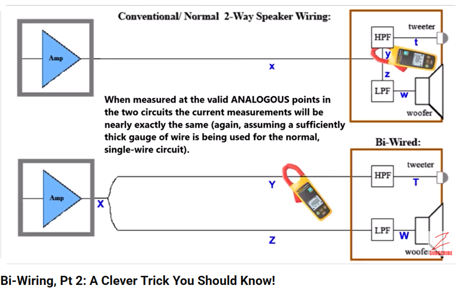

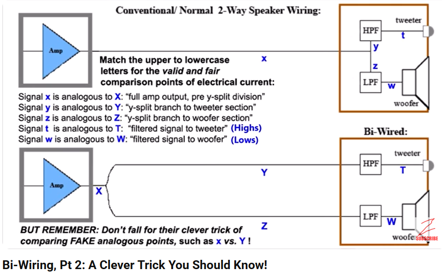

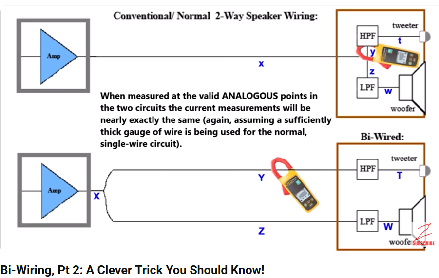

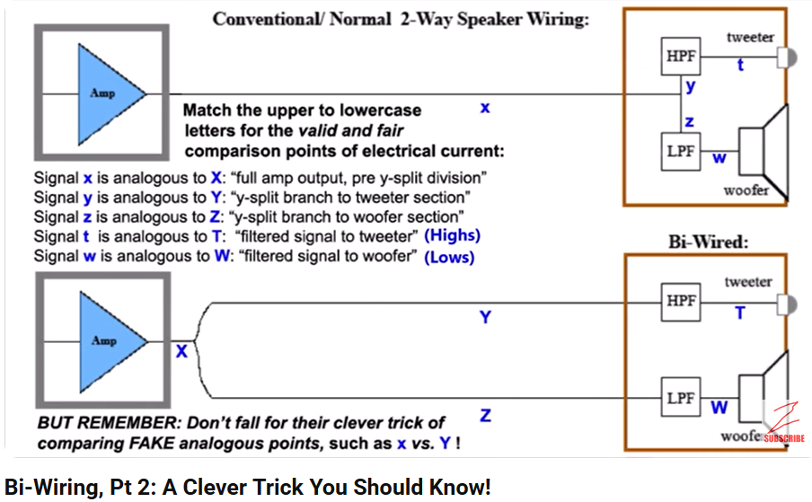

That does not mean the currents in the two pair of wires/path are the same, and they are 100% not the same
Measured as these following proper analogous points (I more clearly diagram below, taken from part 2), rather than the bogus/invalid comparison points of x vs. Y (which marketers misdirect us to with their clever trick), they are the same.
You seem to be discussing current, not voltage, yet all your frame grabs are oddly taken from my first video which discussed voltage. Why didn't you address whatever objections you (may) have with my claims regrading current from my video which addressed current, Part 2?
In any event, which of these 6 proclamations I make in it (at 9m30s), if any, do you claim I am incorrect about?
Or is your position perhaps that in this following proclamation regarding current (from Pt. 2, 9m04s) I am incorrect?
It's hard to make these sorts of videos so they are both easy to understand by a broad YouTube audience (many of whom have never examined a single electrical block diagram in their life), yet also 100% technically spot on without using shortcuts and simplified language/concepts such as the often cited (yet imperfect) hydraulic analogy. I apologize if I at points made some mistakes and, for example, used the term "signal" whereas I more precisely should have clarified if I was meant voltage, current, or both.

Measured as these following proper analogous points (I more clearly diagram below, taken from part 2), rather than the bogus/invalid comparison points of x vs. Y, they are the same.
Part 2?
Yes, discussing current, not voltage because on the voltage side is it obvious that it will be the same, the amps will amplify the same full bandwidth signal.
Because I have very little reason to object your follow up videos as you did address current, whereas Pt1, if someone only read that one, then one might think the bandwidth in both pairs of wires would have the same bandwidth content since you proved it with measurements, even included the FFT diagram iirc. But the FFTs would have shown a different story if you were to measure the current signal waveforms instead of voltage.
I did appreciate that fact, it was a high quality presentation, unlike many of the YT videos nowadays, that's the main reason why I really wanted to contact you about it in the past, but I didn't prefer to post on AVSF that much. I much prefer Audioholics because I admire Gene, an EE, and also Audiosciencereview.com as I also admire Amir thought the two don't seem to always see eye to eye, one of my regret, but...
Sure, point by point as below:
No issues at all with above.
You've got this right, that's exactly my point, that the above was technically incorrect. I highlight "technically" because for non EEs and/or someone who has some EE knowledge, it wouldn't matter, but still worth "correcting" (hope you don't mind using this term) as it might misled those reader as I mentioned before, if left uncorrected. Your "...the current measurements will be nearly exactly the same......assuming a sufficiently thick gauge....." implied that you did not address the FFT part, if you did you would have click that, because the FFT would be different, so even the magnitude could be very different depending on the music signal used.
For clarify, let me emphasized that I do understand in term of the currents (magnitude and freq spectrum) in T and W would be the same in both biwire and single wire secenrios, no arguments there, but keep in mind the believers (the technically knowledgeable ones such as the reputable speaker manufacturers clealy understand that too) never claimed currents in T and W would be different in either cases, it is so obvious, the HPF and LPF are still going to be the same in both cases. All the believers claim are the potential benefits of separating the current paths for the HPF and LPF between the amp output terminals and the speaker input terminals. I think on this specific point, you and I agreed, manufacturers, such as Paradign, Q-Accoustics, Polk audio tened to exaggerate to the nth degree.
Again, my "objection" is as I explained in my previous couple of posts, that the clamp on ammeter will register different currents in terms of magnitude that can be seen easily by using something like a pink noise, music could be used too but it might be hard to see depending on the music contents used.
Likewise, if you use an analyzer to compare the current contents, you will see the totally different FFTs between Y and Z.
Again, the quick takeaway is, when you probe X, Y, or Z with a voltmeter you are compare the voltages that would of course be the same, because the loads presented would be the voltmeter's very high input impedance, at last 1 M-ohm right?
I absolutely understand, and really appreciate of your presentations, and so far this particular one is the only one I wanted to counter a couple of minor technical points, and I hope to see more of such high quality presentations, not only by you, but also by others who would base their presentations on objective engineering facts than internet hearsay hyperbole.

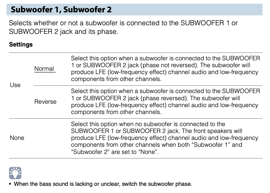

Yamaha units may not be for those who like as many adjustments as they can get concerning subwoofer settings in an AVP/AVR. They do not feature the "LFE + Main," "LPF for LFE," "Bass Extraction LPF," "LFE Distribution," "Directional" or "Bass Sync" subwoofer settings present in fully equipped units from Denon/Marantz.
Trebdp83

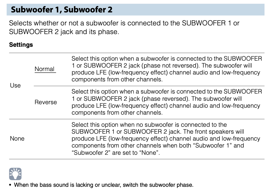

When the CX-A5100 manual was put out, Yamaha called redirected bass "low frequency components from other channels."

Redirected deep bass derived from bass management.

Denon/Marantz does call it something else here and there on different pages of the manual. But, low frequencies are low frequencies. They are either copied to the subwoofer when speakers are set to Large or redirected to the subwoofer when speakers are set to Small when those frequencies are contained in channels other than the LFE channel. Low Frequencies contained in the LFE channel will be output from the Subwoofer when present. Though, some Denon/Marantz units do now feature "LFE Distribution" to send some of that LFE channel info to the Large Front speakers as well as to the subwoofer. Yamahas have no such feature.
Denon X6800H:
