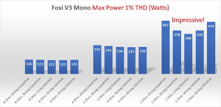

Never mind 100 W receivers, I have been using a $$59.99 (on sale) Fosi bluetooth integrated amp for months driving my so called hard to drive LS50 and to me it sounds just like all the other "real" separate power amps I have owned/or still own, including Bryston and Parasound Halo amps! So, it is important to those who just jump to tell others what they need to understand it really depend on specific applications. If one listen to some giant towers with multiple >8" woofers, nominal impedance 4ohms dip to 2 ohms, listening from 5 meters and desire reference level, they should go for something like McIntosh's 1,000-2,000 W Monoblocks, but if those speakers are in my living room, I could probably drive them with any of the AVRs I owned before, or even the tiny Fosi amp that will max out at about 40 W 8 ohm, 60 W 4 ohms.;)
So, separate amps don't really offer much more than receiver amps for real world use, but for bench tests and certain real world use they do, and there is nothing wrong preferring them as I do, for other benefits, just not audible benefits in most use cases.

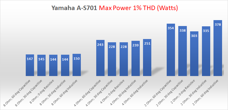

And, back to Yamaha amps, may be drum roll, please!
The entry level A-S701, expect the same for the R-S700 for the receiver version, that is 3 level below the model Gene measured:
The reviewer's (Amir, obviously) comments:
Yamaha A-S701 Stereo Amplifier Review | Audio Science Review (ASR) Forum
"It doesn't quite double down on each impedance half but it still produces a ton of power"
"I should note that the amplifier handled overloads during this test as if they were not there. No protection. No powering down. No nothing."

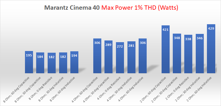

I can end this with the following, test on an AVR, expect the Denon AVR-X4800H to perform similarly:
As Amir called it "For desert, we have some stress testing by varying the phase from -60 to +60 with resistance of 8 down to 2 ohm":
Marantz Cinema 40 AVR Review | Audio Science Review (ASR) Forum
His comments:
"I should note that the amplifier never shut down even though it was pushed hard and into clipping. Very happy about that!"

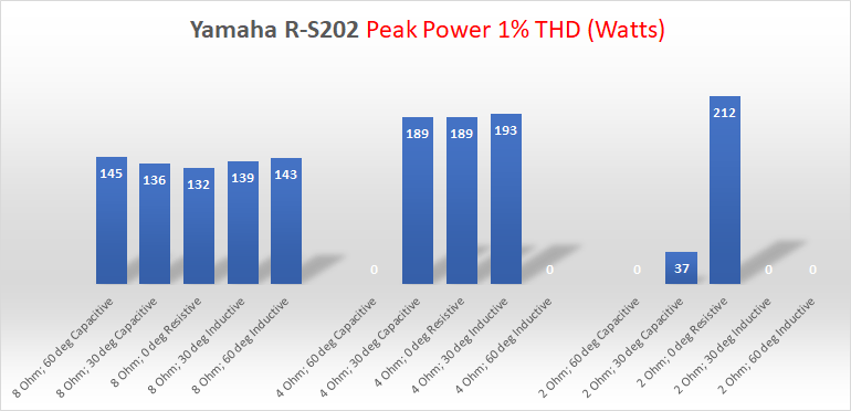

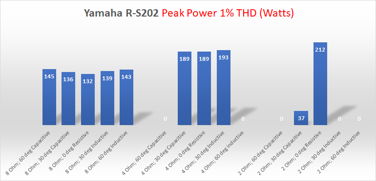

But, since the topic is about a Yamaha receiver, so let's end this post with another reactive load test on a receiver, a tiny one in this case:
Didn't end too well, but for a $200 receiver, 14.8 lb soak and wet, one can still use it on 4 ohm speakers reasonably safe, just have understand it's limit and that for a light weight conventional class AB amp, one can't expect it to do much better than specs anyway and one has to be silly to think it can handle 2 ohm loads, when many heavy weight so called high current separate amps can't do either.
His comments:
