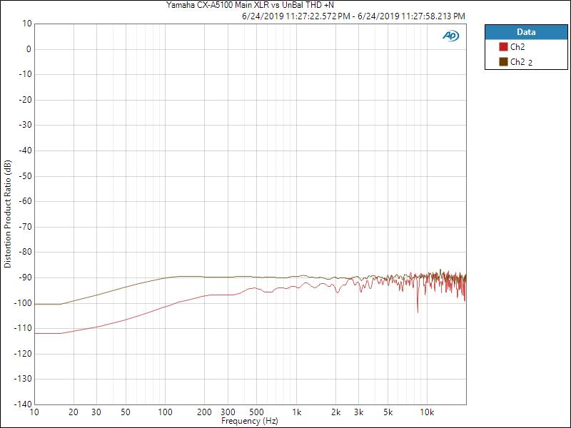

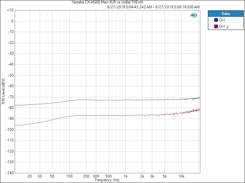

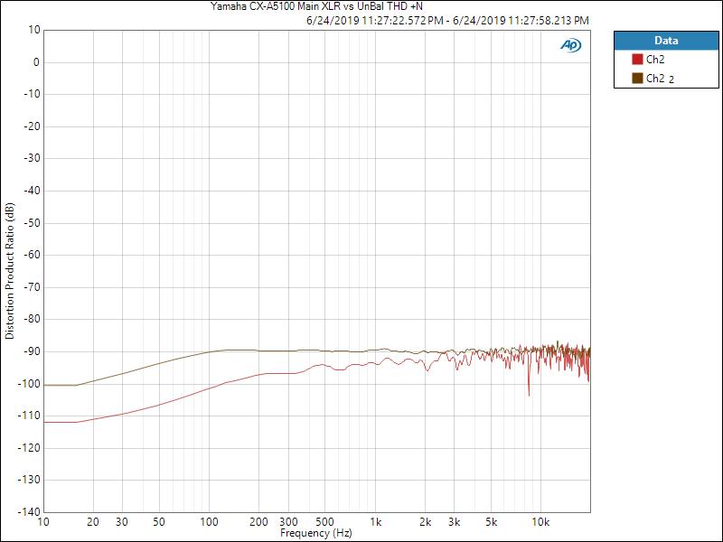

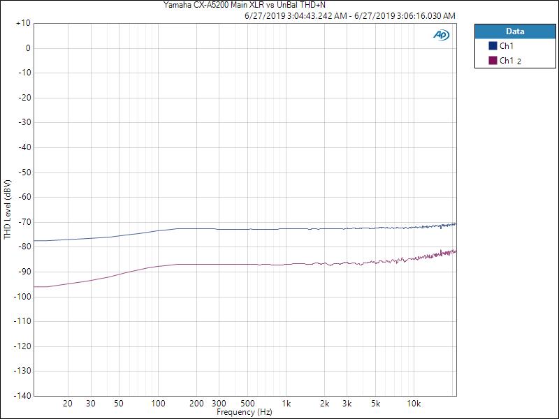

I'm sorry to report my CX-A5200 review is going to be delayed due to a tech issue I found on the product. When I was pulling measurements on my CX-A5200, I noted unusually high distortion coming from the main front channel XLR's. This higher distortion was only seen on the front XLR's and no other connections balanced or unbalanced. I also confirmed this is a new problem to the Yamaha pre/pros as the CX-A5000 and CX-A5100 did not exhibit this behavior.
Yamaha confirmed my findings and claim to be working on "countermeasures". They believe it is localized to the volume control circuitry.
Attached is a graph of the XLR & unbal from main L/R outputs Frequency Response vs Distortion for the CX-A5100 vs the CX-A5200 so you can see the differences.
As you can see for the same output level the CX-A5200 XLR distortion is 20dB higher than the CX-A5100.

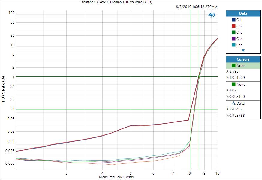

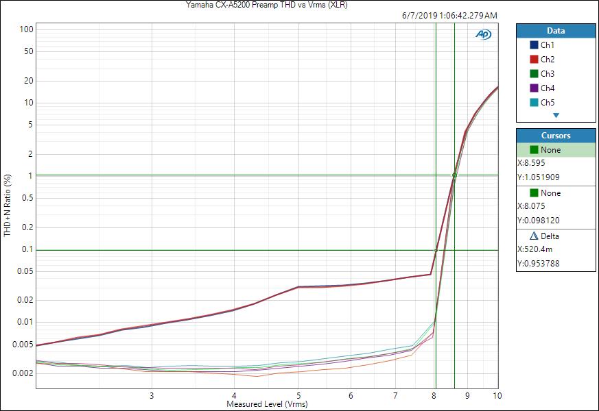

If we look closer of distortion vs output voltage of the CX-A5200 comparing XLR front L/R vs the rest of the channels, you can see how it rises with increased voltage.
The reality is, most power amps reach full power at < 3Vrms so even with these problematic outputs, the distortion is still probably below audibility. However, it's far from state of the art and is something Yamaha should be able to fix and strive to do better IMO.
