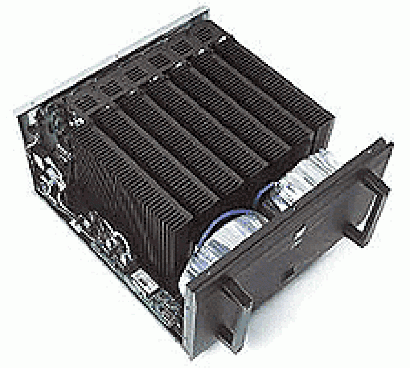

ADTG, the pic you posted for the Bryston appeared to be the 7 channel SP3, not the 16 channel SP4, can you double check please..

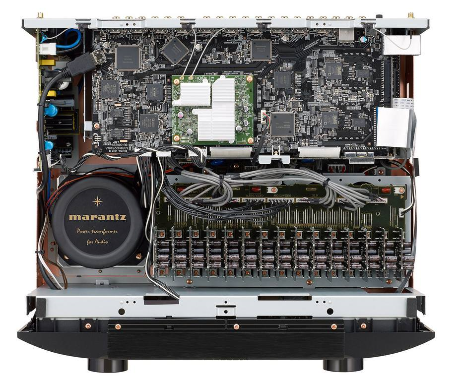

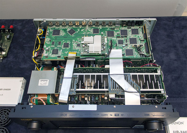

Nice looking Marantz!
It looks like they (Marantz) use a toroidal transformer instead of an EI (Denon).
Toroidal for Yamaha as well.

Yep, no idea why Denon went with EI core for $4k unit, keep in mind it depend on the individual case, toroidal tx is not always better. All else being equal, there are still pros and cons for each, and all else may not be equal because in this case the are custom made for two different groups.

Or the SP4 could have even less parts because to make room for one big 16-XLR board, they had to get rid of most of the legacy boards. :D
But you’re right, Bryston doesn’t have any pics of the SP4 internals.
Anything is possible! However, there's room if they jam packed the additional channels in.

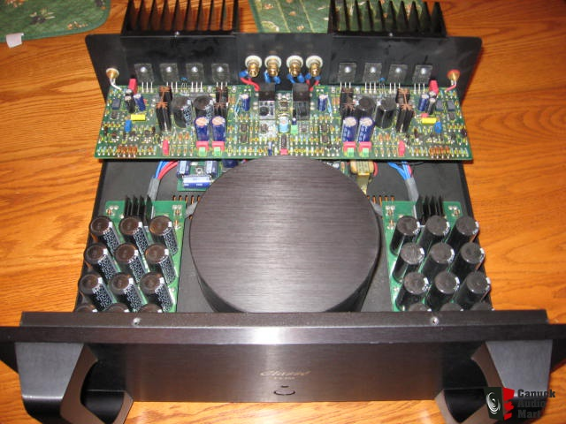

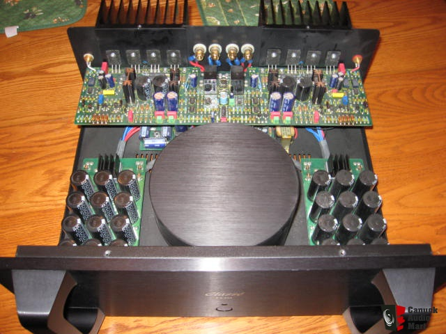

Yeah, I'm not an EE, but I've noticed that in the audiophile market, a toroidal is usually used more than an EI. I don't know if its looks or image or what. I guess there's something about that huge toroidal transformer with that proprietary cover that impresses people.
Just look at my old 2-channel Classé power amp. That toroidal weighed a ton.
Actually one of the pros of the toroidal is that it is lighter, that is, better VA to lbs ratios. Incidentally, the Denon is 13 lbs heavier.

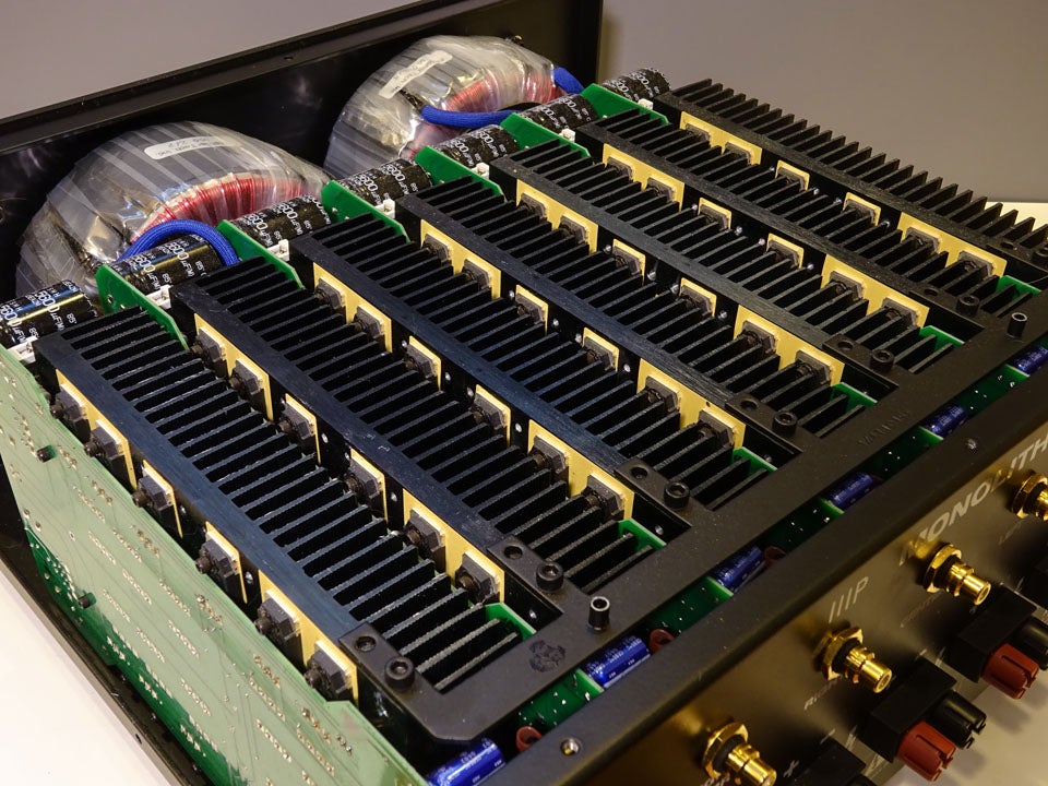

It is really unfair to compare a Processor or Stereo/monoblock amp to a high count, multi channel AVRs.
The Bryston, Theta, Datasat, ATI engineers don't have to built it for 1 or 2 grand retail, don't have to shift 10s of thousands of units just to cover the development cost and still make a profit. If they did, their reliability would tank and the vast open interiors would be whole lot busier. Even the ATI/Monolith/Emotive 7 channel amp are a heck lot more cramped and dense. The Japanese engineers are doing a pretty good job packing it in and still keeping it running reliably. :)
Try fitting all the Bryson processor gubbins inside these boxes all wired up. :eek:

It's not like for like. One is building for a cost/sale price/performance and the other is trying to design the best product it can. One sell by volume and the other sells as a premium product.
ATI are making multi channel amps at a range of prices, for numerous brands. Pretty sure they can hit a particular price point if they had to. If they have to then squeeze in the Processor components inside the same size box then compromises will have to be made. You can't just fill the space up with large heat sinks.
When ATI start putting out 11 or 13 channels amp into the volume of Yamaha MX 5200 then we can discuss if they can still do that for 2.5K and whether it is an over packed design

Without doing a parts count, especially all the circuit boards, it's difficult to see if Yamaha AVR have less parts than Denon.
But after my Denon AVP-A1 died, I got pissed off and starting taking everything apart. And all the boards and parts I removed filled up a big box. :eek:
And then you see these Pre-Pros from Bryston and ATI/Theta/DataSAT that literally look EMPTY on the inside!
And you ask, if these North American engineers can build such SIMPLE designs that look like an empty PC, why the heck can't these Japanese engineers do the same? :eek:
Did they teach them in school that AVR designs need to look like the mainframe at NASA? LOL. :D
BC the japanese stuff typically does a lot more. American processors are often lacking in features and sometimes in performance. The AVP as a preamp/processor produced some of the best test bench results I've ever measured. If only they would have refreshed that unit with immersive surround, HDMI 2.0, and a manual PEQ, I would have taken it to my grave.
Hey man! Now that’s just out right cheating! :p. Very nice. Big power supply, lots of caps, clean build = one lean mean power Machine!!

#97
Hi Mike,
Yeah, that thing was a power house, believe me. I drove a lot of different speakers with that amp and I never could get it to clip, at least not any audible clipping.

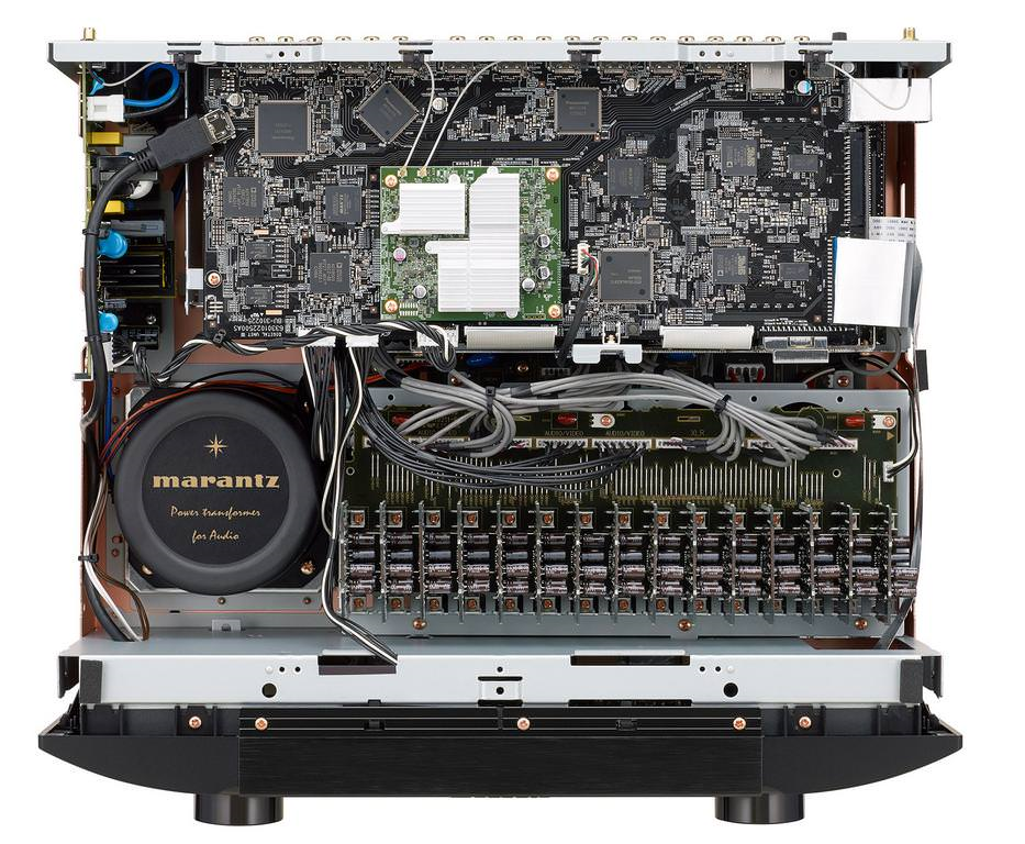

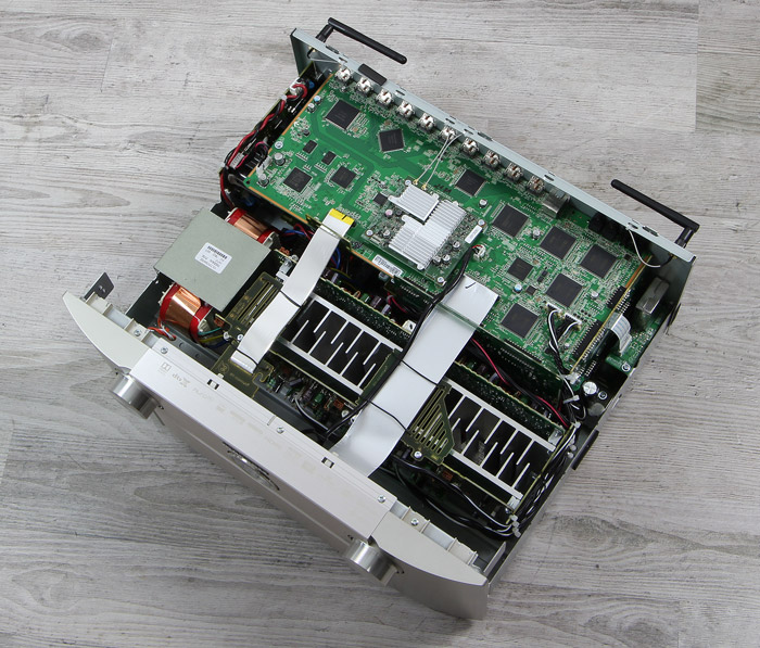

If less part is better (the @ADTG question) the Marantz HDAM thing is really silly. It is pretty obvious to me that they don't make any audible difference, and I am sure Marantz knows that too.
Look at the pictures below, they have virtually identical layout, yet Marantz has to find room to jam-packed (@ADTG's favorite:D) fit the 13 channel (so called 11.2 processing) audibly useless:D HDAM module in a box that is only slightly larger. Denon also has the audibly useless:DAL32, but at last that's done digitally so minimum heat contribution and don't take extra space.
