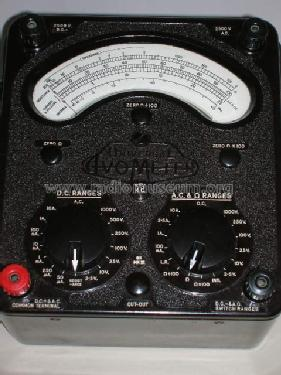

Remember the Avometer? I bet you might have one.:D That would be ideal!

I actually I do have one of those AVO meters. It is an interesting story as to how I obtained it.
I had an itch to own one a few years ago, and won a bid on eBay. I was contacted by a guy that I over bid. Well it turned out he was an expert collector/restorer of AVO meters who resided in the UK.
He told me that the AVO meter I had purchased was a very rare one, and wanted it to complete his collection. So he asked me if I would let him have it and it return he would restore a WWII RAF version of the AVO meter that he had in his possession. I agreed, and somewhat to my surprise this immaculately restored RAF AVO meter arrived from the UK. It was immaculate in every way and contained all the original attachments. It is simply beautiful. I love to think it serviced hurricanes and Spitfires and probably did. It has all its military markings. It is a gorgeous piece. I must take some pictures of it for you.
