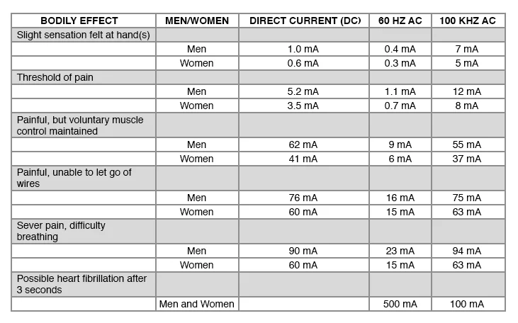

At 5 volts it would not even do that with no shoes and wet feet.
Just a cautionary note, even 5 V ac could be harmful under certain conditions, however unlikely such conditions may be, it could happen. Example: exceptionally low body resistance to ground (bare foot, wet skin, broken skin, certain floor material), non insulated aluminium ladder on wet tile, concrete, cement floor, form of contact etc...) Again, it could be a condition that rarely or may never happen but could happen. As example, in industries, 30 V ac or 50 V dc are often considered safe to touch but that is only because workers are required to wear PPE that includes approved safety shoes, safety glasses, hard hats etc., and insulating gloves for electricians, and the workers are trained appropriately to follow all sorts of safety procedures. Standards are subject to change, often becoming more stringent. For example, in Canada, the the minimum threshold for potentially-hazardous energy has been reduced from 50 V to 30 V ac. Ref: CSA Z462-18 Work place electrical safety. CSA used to consider such "safe" voltage for DC to be higher but have since removed that distinction.

Here is an interesting read from a credible site on the effects of voltage and current on human bodies:
For the OP, I would recommend he reads the entire article in order to be better equipped in his effort to engage Yamaha until he gets a replacement, or at least get it repaired and shipped both ways for free.

I just read your last two posts (after reading the first post some days ago and being curious what the final resolution was). Sorry to hear the problem is not yet resolved!

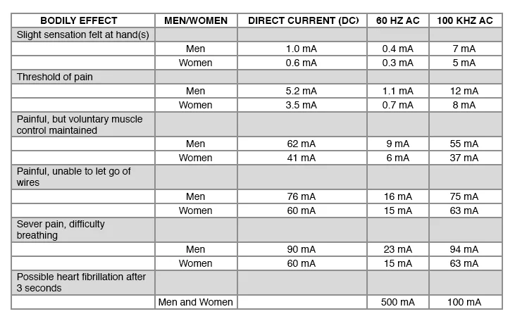

thanks a lot
