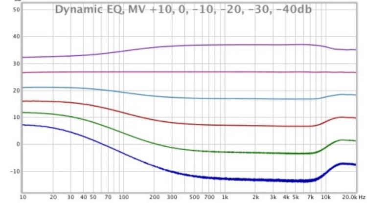

When you manually INCREASE the speaker channel levels (like by +5dB), you also increase the effects of DEQ significantly.
That DEQ graph is with the standard speaker levels after Audyssey is applied.
Ok then!
