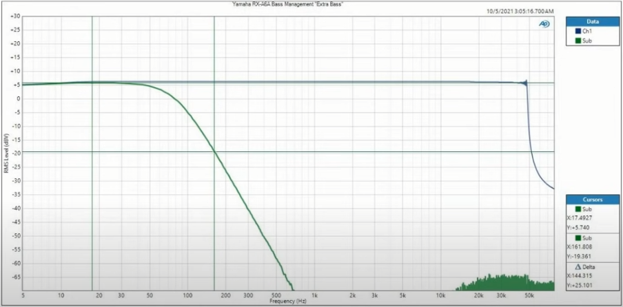

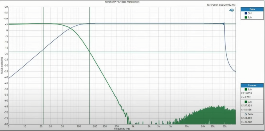

When I think I didn't get why there were Scenes...
You can have a Music scene with extra bass active but speaker Pattern 1 without any subwoofer so the amp isn't outputting bass through the LFE, and then Movie scene with speaker pattern 2 where the subwoofer is enabled. So I don't have a kind of "double bass signal" while listening to music and relying on high level input on my subwoofer to integrate bass in the stereo. Then I benefit of LFE and stereo signal for driving the subwoofer in movies.
This is GREAT !
I want extra bass because without the bass are cut of the front channel
Then with extra bass the front channel get full range
This is GREAT !
