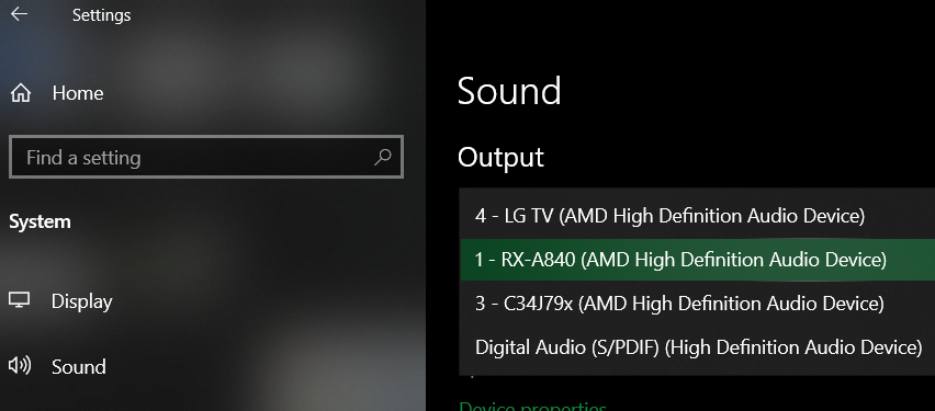

Do you mean when connecting your PC to the AVR then AVR to TV the sound is played only on TV and not through the AVR ? ...
Edit : I disabled eARC and I don't have any sound so it means the audio was going through the AVR to the TV and then back to the AVR through eARC. I am also intersted on how to get the audio to be decoded by the AVR without eARC.
Edit: in this configuration my amp is stuck to -29dB, don't have output speakers, and I can't change the volume whatever I do.
Edit : in HDMI menu, HDMI Set Control should be OFF to let the AVR decode directly the audio.
This is correct, but my TV isn't quite new enough to have eARC, it only has ARC (I got the TV just as eARC was becoming a thing). I didn't really want to turn HDMI Control off, as I like using it (I suspected it may have been the causes of my issues), it's nice to have the inputs switch automatically depending on what's happening, I could go without it as my old AVR and my TV did not play nice together when it was enabled (audio would be garbled and I'd have weird behavior as the AVR would fight the TV for control).
Edit: This also made me think how exactly my setup at home is working because it is absolutely the same as yours except that I use ARC not eARC. I have laptop connected to the AVR through HDMI, I get picture on the TV and the AVR is decoding the audio directly because the TV does not support passthrough of DTS sound to the AVR. I have ARC enabled and ARC control as well because I'm able to change the AVR volume through the TV remote. Is it possible that it depends on the content...?!
This is how I had it set and it worked with my old AVR, but it processed the sound and passed through the video, the Yamaha passes through both A/V and I can't change it's volume. It seemed to work correctly with games, videos and music on my old AVR, but it was a much simpler machine due it's age.
It also depends on how you set ouputs in Windows and in player software on PC. If you have GPU and motherboard with multiple HDMI ports, then there is Sound setting in Windows where audio output is set, as shown below. Sound can go around in different directions depending on cabling and chosen settings.
Cable 3 - GPU-AVR - sends sound directly from PC to AVR
I didn't know this, I was using the same GPU HDMI port I was using before and the settings I expected to appear just did not appear with the Yamaha, I'll have to try the other HDMI port on the GPU during the weekend and see if it has the same behavior. Cable 3 as you have set is the ideal option I'm aiming for and what I had been doing with the old unit.
Yes. Content could be set to be sent out as PCM from sources (laptop/player's software/BD player decodes) or Bitstream (raw audio is passed to AVR to decode it).
From the PC I get PCM which I suspected wasn't right, although I thought I would at least get Stereo out of it, but Windows 10 didn't seem to be giving me any options as it seems it can't see the Yamaha or was just ignoring it.
