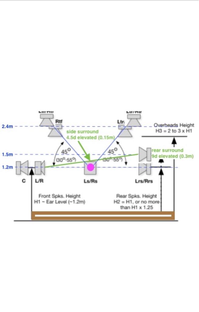

Do you think my rear speakers are the right distance away from the couch? Or further back. Right now they are basically under my Atmos. I did my best placing my Atmos ceiling speakers due to duct work and other poop in the ceiling lol but pretty damn close to perfect placement

Also, imo the side surrounds should come down a little bit. I don’t think there would be enough separation between the bed and height layers.
Yeah I wanted to put them a bit higher than stands but I know what you are saying. The guy at the store said 2 ft above ear level.
My rears can't go on the columns, there would not be enough seperstion between sides and rear. They would basically be the same speaker.
Would everyone lower the side surrounds??? That is give its an Atmos track, if it's not then they should be even higher.

Also, imo you’d get a much better experience by going .4 Atmos, and where your current “heights” are, they’re too close to the mains and should be higher, if not on the ceiling.

I would lower the side surrounds and use those back columns for a nice clean setup and be done.

It’s hard to tell from the pics but you make sense by saying they’re wouldn’t be enough separation from the sides.
For the sides, yeah you want them at or just above ear height. For pre Atmos systems higher was better, like maybe 6’ but Atmos changed that. Plus! For legacy tracks, DSU and DTSnx are great for giving an immersive experience.
So the guy from the store was right, but outdated.
Yeah I will see if I can lower it a bit. So ideally how many feet off the ground should they be?
I wouldn’t think of it as “how far off the ground”. But more like how far above ear height. Also there’s this.
Surround height(h2)should be no more than mains height(h1) times 1.25. So for a tweeter height on the mains at 40” that puts the surrounds tweeter at 50”. Considering if you have multiple viewers, going a little higher can be beneficial to clear their heads, but if the ceiling is too low, then you lose the angle. So like everything, there’s trade offs.
