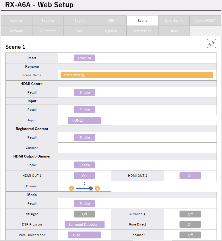

Go to the web setup at ipaddress/setup. There, in the tab Other you have the firmware update section. When available you will see in status - Available. Press start and it will update. It is the easiest way. In the picture is the web setup for my V6A but this section should be the same for the A8A or any AxA receiver.

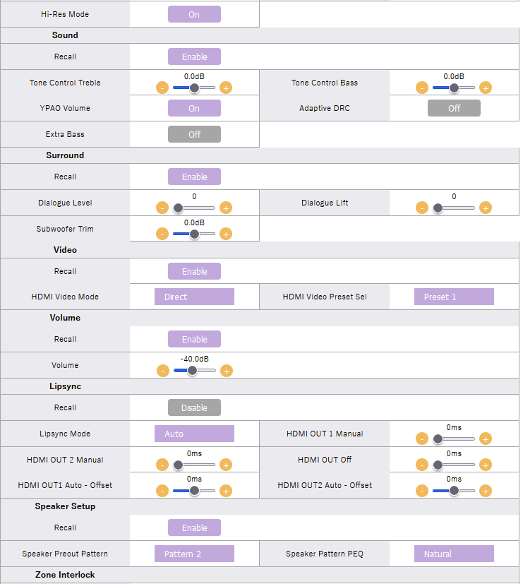

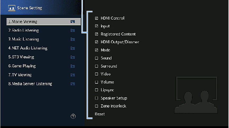

One of things I can't seem to figure out is why can't I have more control over the individual scene settings on through the remote/AV setup settings. The only options I see are the ability to rename the scene and the ability to chose which items are included but no option to then adjust each included item...
However if I use the website setup I do have way more ability to control each selected item. I have no problem using the web interface but I am going to guess that many people who buy these units are never going to even realize that there is this option...
Well, a wild guess would be that Yamaha just thought that making this UI into the on screen display will be a lot of work and probably too complicated for most of the people who use it. Probably tweaking all this stuff from the remote will be more difficult than the web interface. So they try to keep things as simple as possible in the OSD. Actually, I am glad they still give all these options through the web interface. They could have removed them from the web as well :D
Perhaps but one could also argue that with units in this level of category that the user should have more control. It just seems that they could have made a sub menu of each selected item where the adjustments could be made.I mean you are already making these adjustments outside of the scene setup and then it's copying those settings to the scene program. It would have been nice to be able to make onscreen "tweeks" afterwards.
