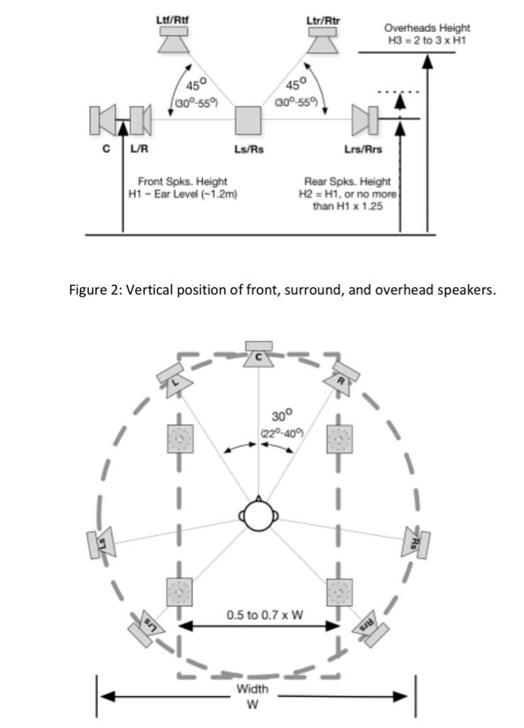

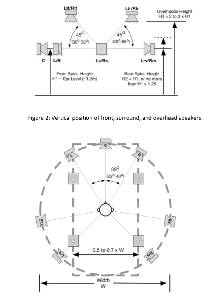

I've seen different placements over the years...
In a 7-channel Bed layer:
I think Rear Surrounds should be slightly narrower than your mains, assuming your mains are ideally set up.
Keep in mind, this also goes on the basis that your actual Surrounds are set up properly... I like more in the 100-110º area, to the sides and slightly behind the LP.
In a 5-channel set up...
There are no Rears. You Only have Surrounds (L/R) and Dolby recommends they be 110-120º to the sides and behind LP.
As always, each and every room we inhabit is unique and we all have to play withing the physical space we have available to us.
The Dolby guides are ideals. Get as close to those as possible for best results. :)
ryanosaur
ryanosaur

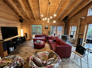

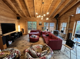

Are your rear surrounds pointing straight or angled in? I can't tell from the picture angle.
Yup... That's about what I said. ;) Rear Surround narrower than Mains if possible.
For Atmos/Auro... Tops and Heights are in line with Mains usually... I think the ideal is about 8' apart on center. There are others that will say you should spread the mains further out, still.
Again, so much depends on the room and how you are set up.
This picture is too generic and doesn’t take into account individual room variables. Like for example, the tops in line with the mains. With a low ceiling height, that would be problematic spacing them out too far.
There are better illustrations out there like this.
