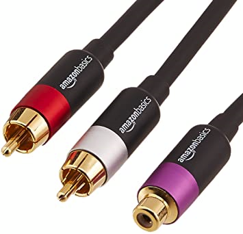

-using a single female to dual male Y RCA cable on the subwoofer end of your sub connections if they have L/R inputs will give your subs more voltage which is kind of a weak point on Yamaha AVRs.

What I think he’s actually trying to say is, the connection at the subwoofer should use both LR connections via splitter. It doesn’t raise the voltage from the AVR, but rather the input sensitivity in the subwoofer. It doesn’t allow for any more power though. Also, as I am not familiar with your subs, I’m. Ot sure you can do that anyway. Usually nowadays, one input is the “LFE” input and uses the crossover in the AVR, while the other one uses the XO/LPF on the subwoofer. If they’re giving adequate output, I wouldn’t worry about it. Until maybe someday when you upgrade them.

No.
You never want to connect both outputs from the AVR to a single Sub.
To clarify, you run a single output to a "Y" splitter, plugging Both Ends of the "Y," 1 each, into the L and R Inputs on the Plate Amp of the Sub.

This is from Mike's guide to Subwoofer Calibration and Bass Preferences....
One final issue involves Yamaha AVR's which yield abnormally high trim levels no matter how high the subwoofer gain levels are turned-up. This can be a much more significant problem than the auto-on issue. In a recent example from early October of 2021, a new Yamaha RX-A8A exhibited this issue of setting abnormally high trim levels with the subwoofer gains also set high. Some before-and-after screen shots of trim levels, showing the problem being solved with Y-connectors, are illustrated on Page 218 of the Guide thread. If you believe that your Yamaha (or Onkyo) AVR may be exhibiting similar behavior, it could be worthwhile to look at the pictures on Page 218.
Apparently, this can also be an issue with Onkyo AVR's. The typical voltage sent from AVR's to subwoofers is about 2.0V or slightly higher. I'm not sure what the voltage coming from some Yamaha AVR's is, but I have been informed by AVS member @fattire that with some Onkyo's it is only 0.9V. If the subwoofer receives substantially less voltage than the typical 2.0V, then its performance may be adversely affected, and that limitation may show-up during calibration. The subwoofer trim levels may be set too high even with very high subwoofer gain levels. That can be an indication that the subwoofer is not able to reach its normal output potential.
Where this problem is believed to be occurring, the way to correct it is to use a Y-connector into both sub inputs. That will double the voltage going from the AVR to the subwoofer. So, using Y-connectors can allow subwoofers to turn on automatically in some cases, and they can also be used to allow the subwoofer to achieve its full operating performance. Once again though, the Y-connectors are only effective where the voltage coming from the AVR is insufficient. They won't improve on the inherent performance capabilities of the subwoofer. Its own amplifier will determine the subwoofer's inherent capability.
This is an example of the type of Y-connector which would be used to increase the voltage going from the AVR to the subwoofer:
Amazon.com: Amazon Basics 2-Male to 1-Female RCA Y-Adapter Splitter Cable - 12-Inches

In addition, if you still use the RCA "Y" splitter cable, you have the potential to boost the sub's output signal when plugging into both the red and white RCA inputs on the back of the sub. If you choose to do this, please note that connecting both inputs in parallel will double the input voltage which equals a 6dB boost in output. However, the input impedance will then be effectively "halved" and that could potentially cause loading problems for some sources (receivers, amps etc.). Overall, it is not recommended to use a Y-splitter on any of our powered subwoofers that were manufactured in the past 10 years or so.

OK so don't use a y splitter! Good to know! I can always raise the DB manually anyways.

If you use the auto on feature where it is available (as opposed to a trigger), and it does not activate when a signal should be sent to the sub, using the Y splitter is a good trick to try.

The only real reason to need a Y-splitter is if you are having a problem getting your subwoofer to turn on when in standby mode because of a low input voltage at low volumes. Other than that there is no real benefit from it.

Again, The Y splitter doesn’t raise the output voltage from the AVR, because it can’t. The AVR will put out what it puts out. Iirc 1.4v was common for Yamaha, and holy cow! Didn’t know Onkyo ever had output voltage of .9v, that’s insane. I always thought they were Over 2v. Interesting.
I believe we are mostly in agreement, especially with gain structure.
If a user has problems “waking” the subs, then making sure the trim is high enough without going positive is ideal. As far as reaching a subs full potential, splitting the signal at the subwoofer increases the input sensitivity, meaning that it can reach full potential with less gain. It does nothing to increase total output, or performance in general.
Basically we’re talking about compensation for Yamahas weak output voltages from the pre outs. This is also a problem with driving amplifiers too.
