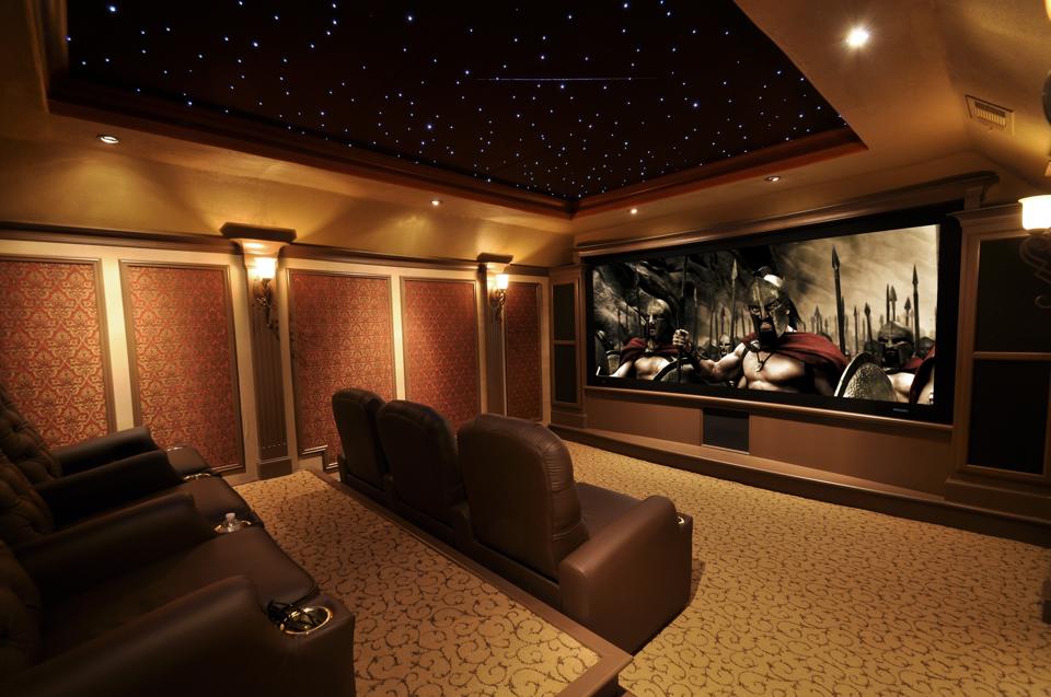

FWIW - I found a picture of someone elses' theater that is similar to what I have in mind, at least for the main towers. I'm thinking the closeness of the adjacent walls will have more of an impact on sound quality than anything else.

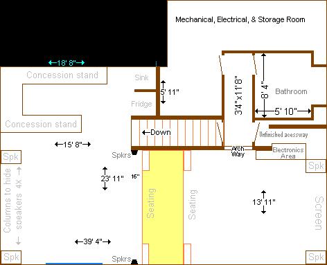

I also found the crude layout sketch for my room.

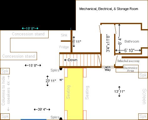

How are those apparent in-wall speakers similar to the towers you're considering? Do you have a link to that system's details?

No. I don't. I'm just using the picture to give a general idea of how the doors will be constructed. The speakers would be placed immediately behind the speaker cloth in the doors.

You had earlier said your room is roughly 13 ft wide, 40 ft long. Your diagram shows roughly 24 ft wide × 39 ft long. I assume the diagram is correct. Right?
What matters most is not how long the room is overall, but how far the seats are from the 3 front speakers. I think the Salk Song3s can easily handle that size room. The web site recommends 50 watts as a minimum, but these speakers can easily handle much more power for a larger room such as yours. I suggest looking for power in the range of 150 to 200 watts per channel.

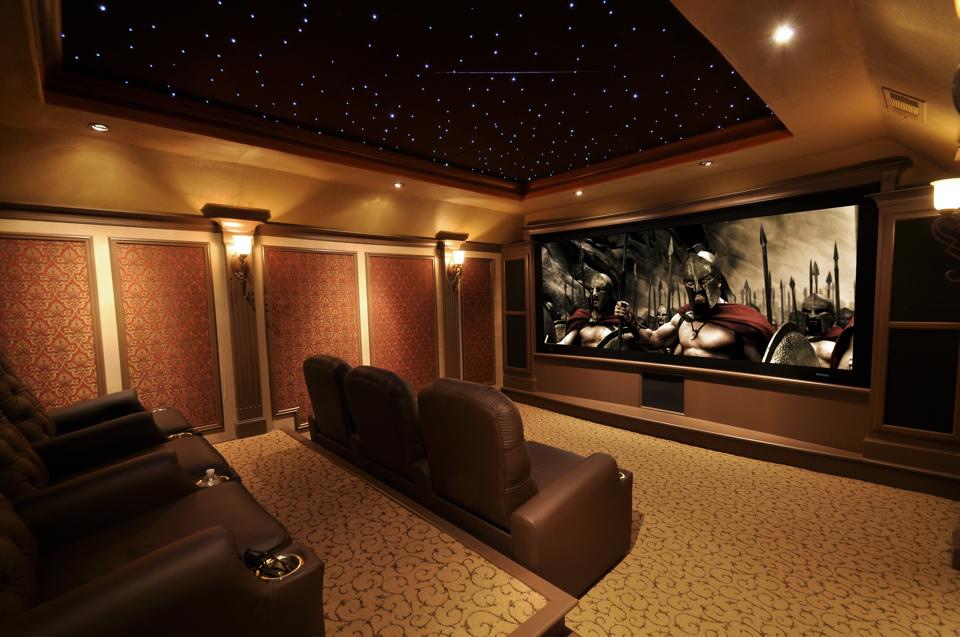

Behold my awesomeness Google-Fu mad skillz!
That photo is from custom (designer) built HT in Mc Kinney, TX (Dallas suburbs) .
They have used In Wall Klipsch THX Ultra speakers
It was sold last year for what I consider living near NYC is laughable money all considering.
http://www.zillow.com/homedetails/1005-Barre-Meadow-Ln-Mc-Kinney-TX-75071/83739711_zpid/
Rest of build and details are here (and before/in-process and after images there)
http://www.theateradvice.com/before-after-media-rooms.php#demo
Dallas Theater Demo Room
Our Demo Home theater installation in Mckinney Texas is extreme and very custom. However not all of our clients do media room installations like this in their homes. But it is easy to pull aspects from our THX demo theater to use in your own home theater. This room on top of the home theater design aspects includes acoustic treatments on all sides of the room and in the cabinet. Huge 133” Stewart Filmscreen that is 2.40:1 ratio with anamorphic lens. Acoustic fabrics covering speakers, custom seating and much more. Come see it if nothing else than to see that we really are the best and we are the only ones that can prove it.

Swerd – I don’t think you’re looking at the plans correctly. Yes it’s 24ft wide but that’s the back of the theater where the concession stand is. The screen wall is on the opposite end of the room.
The ears in the first row of seats will be approx. 12ft away from the front of the speakers. As for power, I already have 2 Outlaw Model 7900 amps. As far as I can tell, they’re simply a rebranded version of the ATI 6707 Morris Kessler Signatures which are 300wpc into 8ohms.
