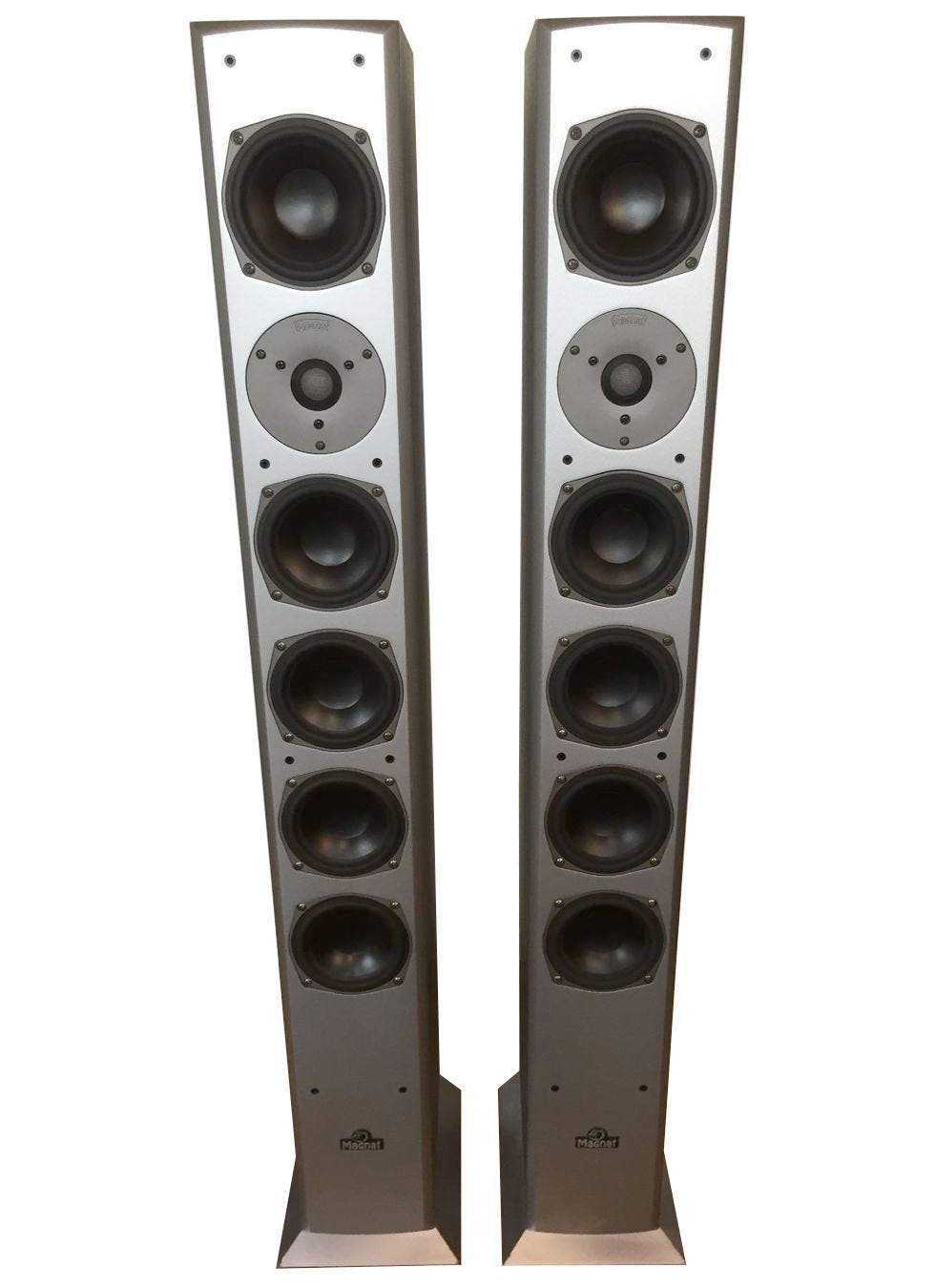

Sometimes it's not about the Watts but about stability into the reactive load.
The Quad 606's aren't super powerful - but they ARE super stable - and with the Gallo CDT tweeters showing 1.6ohm capacitive load... that becomes essential.
So you could allocate a 606 to the tweeter and use AVR onboard amps for the woofer (as an example)
You might want an "ordinary" amp capable of handling the relatively "ordinary" load of the woofer with loads of Watts.... but then something like the 606 for that reactive tweeter load....
Active speaker designers are making these sort of decisions all the time nowadays.... and having asymmetrically powered speakers is becoming the norm. (with the details of that asymmetry varying based on the requirements of the speaker/drivers, etc...)

Why would you use the more powerful Quad 606 for the tweeter which only needs a couple of watts, while a woofer needs a lot more power? By the way, the 606 has a higher power rating than any of an AVR amps, and surely is more stable as well. If only 2-3 watts of power are needed, an AVR amp should be able to handle a low impedance tweeter. Otherwise, a 4 ohm 10 watt resistor could be added in series with the tweeter.

What utter nonsense, absolute bilge from start to finish. What an absolute waste to have a Quad 606 powering a tweeter! The 606 and 909 series Quad amps are among the finest power amps that have ever been produced. If you have one, just use it to power the whole speaker.

Why would you use a 606 on a tweeter that won't present a difficult load to it? SHow the Gallo tweeter and explain why it should be used if it actually presents a 1.6 Ohm load. While you're at it, I would like to know why Gallo can't be bothered to design their CDT tweeter to have a voice coil that doesn't present a difficult load.
BTW- the passive crossover on a tweeter should be able to remove the frequenies that cause the difficult load and when did woofer loads become "relatively ordinary"? Of course, the standard response will be "Because passive crossovers cause phase shift and takes away the best parts of the sound....."- good, reliable speaker design should include components that won't cause amplifiers to puke, not force the users to search high & low for an amplifier that will survive being connected to them.
