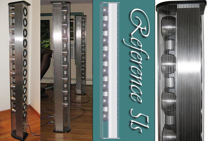

Take a look online at the CDT tweeter - it broadcasts like a semi-omni design covering around 270 degree horizontal arc...
Every designer balances various competing priorities - Gallo designed intentionally for a wide dispersion design, producing a very unique tweeter - and a very specific set of challenges in terms of the right amps to drive it.

Gallo when still run by Anthony Gallo (10 years ago?) - was building very high value high end speakers - the reference series competed with speakers substantially beyond its price point... plenty of reviews online..
My own observation, is that they are one of the few reasonably priced (at the time!) speakers, which had a midrange transparency approaching what I could achieve with my previous Quad Electrostatics. (which were disapproved of by my partner due to their "overwhelming" presence in the living space...)
Subsequently (starting with the reference 3.5, and then the Strada models) - the pricing of the Gallo speakers rose substantially, more in line with their competitors, and the company was sold by Anthony Gallo....
There has been no subsequent R&D by the Gallo brand in speakers - they have continued with the existing Strada design, discontinued the Reference floor standers and the reference AV series, and focused on "lifestyle" speakers.... :( .
So they are a slightly exotic speaker - with specific requirements, but one who's sound I particularly like, and the wide dispersion suits the room they are in, and our listening preferences.
And I have learnt to feed them with appropriate amps!! I already had Quad 606 amps at the time, and subsequently tried higher power Crown XLS2500... with no real additional benefit from the power - but connecting them to an Integra DRX3.4 immediately showed what an amp that really cannot handle that type of load sounds like... not good! - using the DRX3.4 as a pre feeding into the Quads or Crowns completely fixed that issue.
And yes some of us like what can be categorised as "left field" speaker designs with atypical requirements...
I also have more "traditional" speakers, and prefer the Gallo's in my main setup.

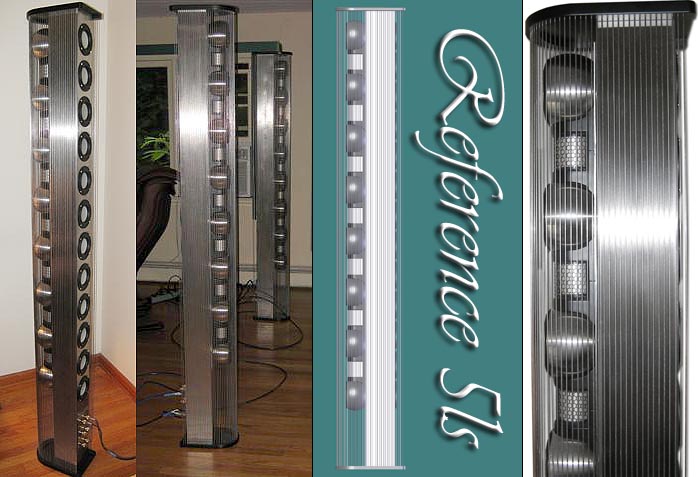

I did look at them online and installed/heard one of their models when I worked for an AV integrator in 2005- not impressive. Little speakers that reminded me of the Phantasm Sphere didn't impress me. It's not that I don't like small speakers, but for me, if they don't produce full sound and somewhat convincing illusion of soundstage, what's the point?

And he even issued the very rare flagship 5LS model.... which I would dearly love to get my hands on!!
Anthony Gallo Acoustics Reference 5LS Loudspeakers
But that is all history now... the brand is (now) a lifestyle brand with these high end efforts abandoned.
The Strada is the only holdout from the high end efforts of Anthony Gallo.
Wow those are epic line arrays . Seems surprising But lifestyle brands are going after maximum profit. I was surpised Bose once made towers and large speakers ages ago to 321 to now soundbars. I still haven’t Had a pair of there headphones. They are so expensive.
PENG
That thing is going to be highly capacitive, so not friendly to avr amps especially the lower tier ones but as always, it depends on other factors too, for example if one never turn the volume pass say 50 dB below 0, then all may be good, and obviously -50 is just an extreme example to make a point.
I think your Quad amp may be quite suitable for the CDT because they apparently don't use a lot of negative feedback anyway, so less prone..
Incidentally, Quad also make electrostatic speakers right? So I guess they know how to deal with capacitive load lol.
At one point in the 80's I was looking quite seriously at their baby bookshelf direct/reflecting speakers (201, 301)... to replace my very first (high school) speakers the old Tandy/Radio Shack Minimus 5...
Their entire direct / reflecting range, was topped by the 901's - but there were very nice more traditional floor standers and bookshelves in the range below the 901, and they were pretty decent speakers!
