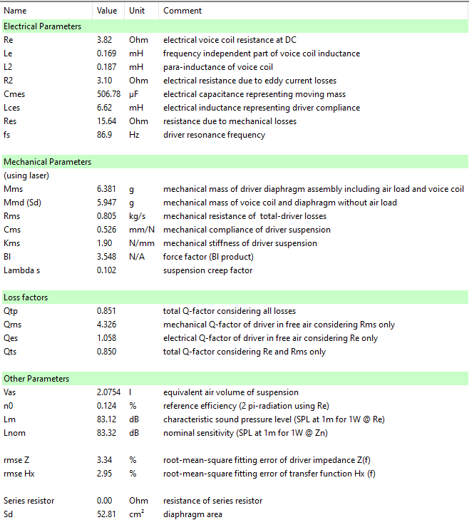

Thiele-Small and Large Signal Analysis:
Using Klippel’s Distortion Analyzer 2, Linear Lumped Parameter Measurement Module, Pro Driver Stand and provided Panasonic ANR12821 Laser along with Klippel’s Training 1 - Linear Lumped Parameter Measurement tutorial, I measured this drive unit’s impedance and small-signal parameters. Below are the results.
The few standouts to me are:
  • High Fs of ~87Hz
  • High Qts of ~0.850
  • Low Sensitivity of ~ 83dB
All of these parameters translate to a speaker that needs to large enclosure (so the Qtc will not be any larger; as the Qts itself is already relatively high), high low cutoff point (due to high Fs) and low sensitivity (even though the on-axis average SPL is ~ 85.5dB, the SPL in the bass region is in the low 80’s).

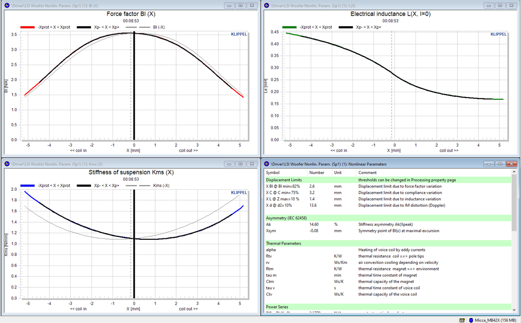

Using Klippel’s Distortion Analyzer 2, Large Signal Identification Module, Pro Driver Stand and provided Panasonic ANR12821 Laser along with Klippel’s Training 3 - Loudspeaker Nonlinearities tutorial, I measured the linear, nonlinear and thermal parameters of this drive unit. Below are the nonlinear results.
The linear excursion is capped at 1.4mm one-way due to inductance variation. It’s rare I have a mid/woofer be limited in excursion due to inductance. And in a speaker like this; one that is most likely to be used from 80Hz all the way out to 20kHz, that is a problem. This result indicates the mid/woofer will have a very high level of mid-to-upper frequency distortion if the cone is asked to play content near Fs due to high inductance. And with a bookshelf speaker like this, it should absolutely be crossed above 100Hz to limit any playback near the Fs of 87Hz.

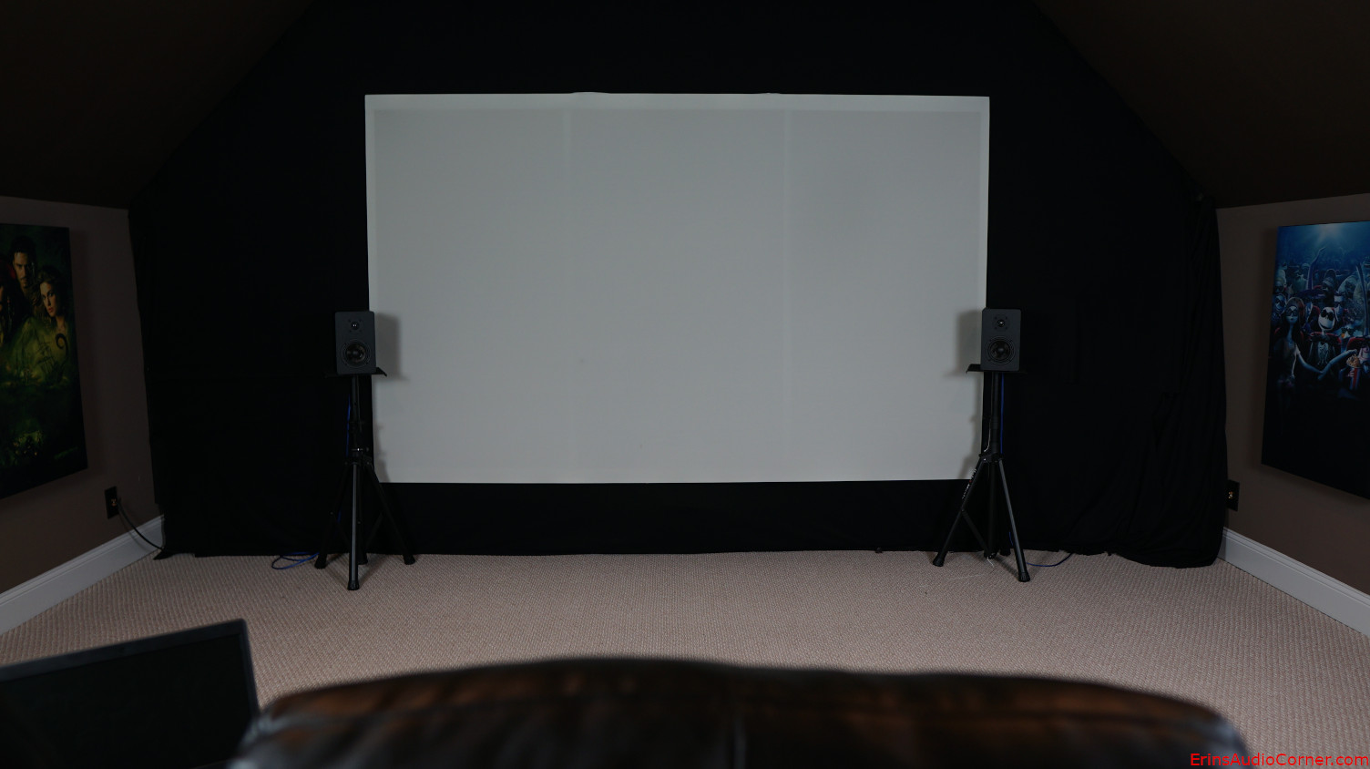

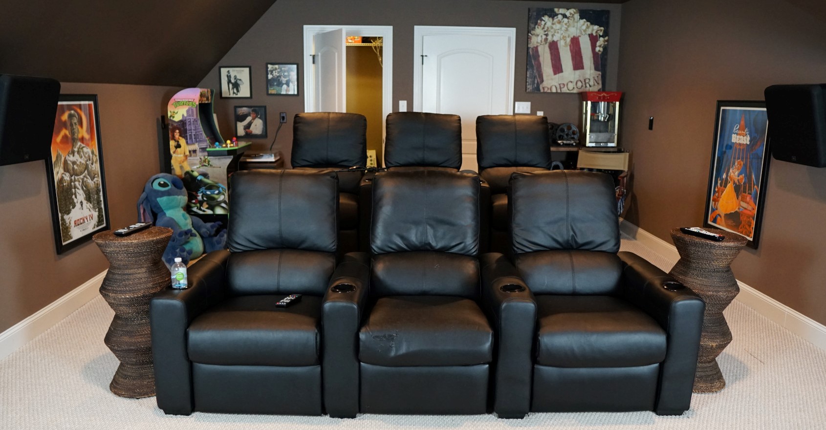

Before I dive in to the subjective feedback let me first give you the layout of my room…
room layout
room 1

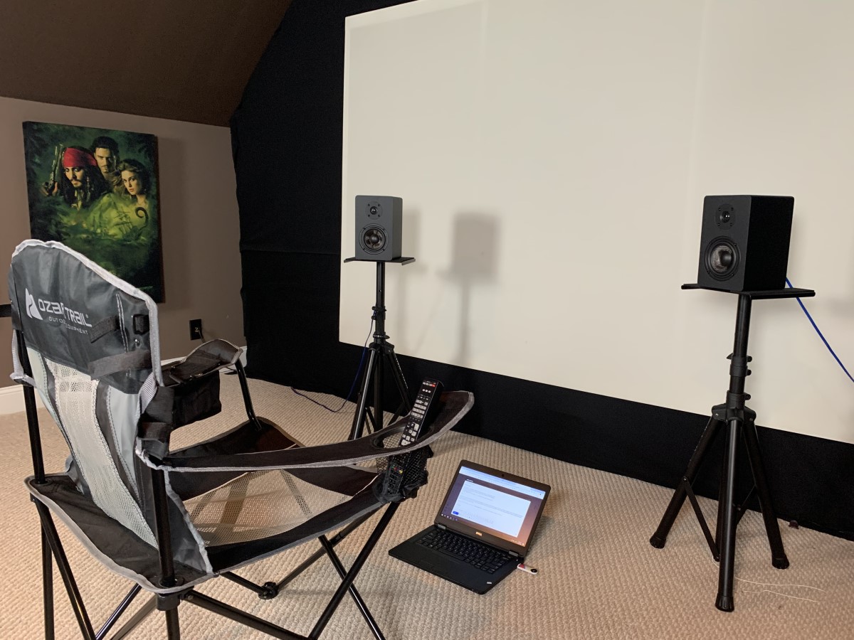

And here is the nearfield setup (with the lawn chair in all its glory).
room 3
room 2
I don't like seeing speakers when watching a movie. So, I built a false wall and used an acoustically transparent screen with speakers behind it. The wall is only 2x4's; no panels of wood or anything. Just a skeleton of a wall to give me something to attach the screen and acoustic treatment to. There is 2-inch wedge foam affixed to the 2x4 studs and between the false wall and back of the room are the front speakers (L/C/R & 18-inch subwoofers).
