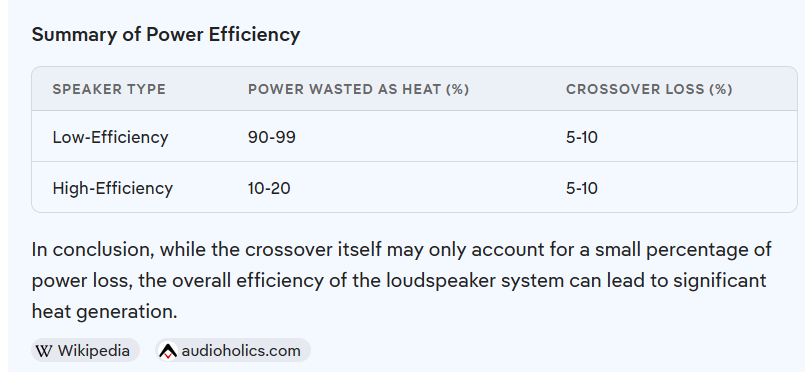

According to one of the world experts on bi-amping (the legit variety) the main benefit to the use of an active crossover over passive is they effectively provide full amp power with no waste. In a normal single amp scenario the loudspeaker's passive crossover elements are never 100% efficient so they gobble up, let's say, 5% of the incoming amplifier power and wastefully turn it into heat instead of music signal to send to the drivers. But in active biamping instead an amp goes straight to the voicecoil (because there is no speaker crossover) so nearly all of the power amp's signal gets there intact (assuming the speaker cable being used is adequately thick). Still these gains are rather modest. He said he measured it as being around 1dB in real world use or at the very best 2dB, tops. Far better is to simply get a fundamentally doubly powerful single amp and wire it conventionally with one wire, which achieves a solid 3dB greater maximum potential output. [And it may cost less than buying those two lesser power amps.}

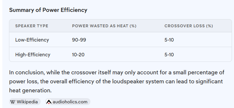

The loss of power in a passive crossover is much higher than you think and generally 3db per order. So in most passive speakers at least half the amp power is wasted and usually more. In addition in many commercial speakers the components are undersized, with too narrow a gauge of wire in the inductors. This results in the wire heating and dynamic compression, which also changes the crossover point to an extent depending on the power demands. The lower a crossover point, the larger this problem becomes. It is much less of a problem the higher the crossover point, due to lower power demands as frequency rises.
So, my practice is to use active crossovers in the lower crossover points in my reference systems. I have trouble justifying an amp to drive a tweeter. In my passive designs I use far more expensive and larger inductors than would normally be found in commercial speakers.

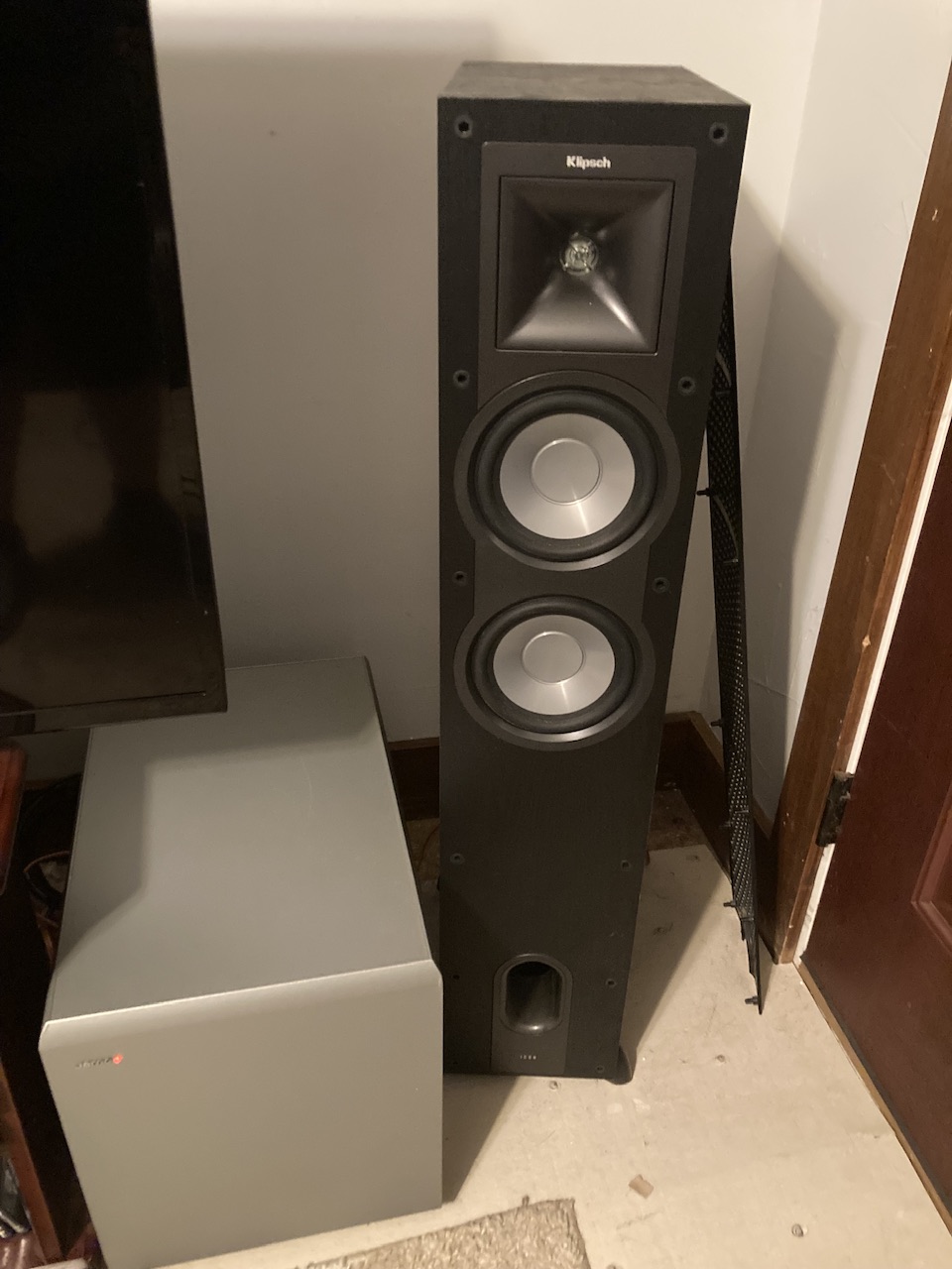

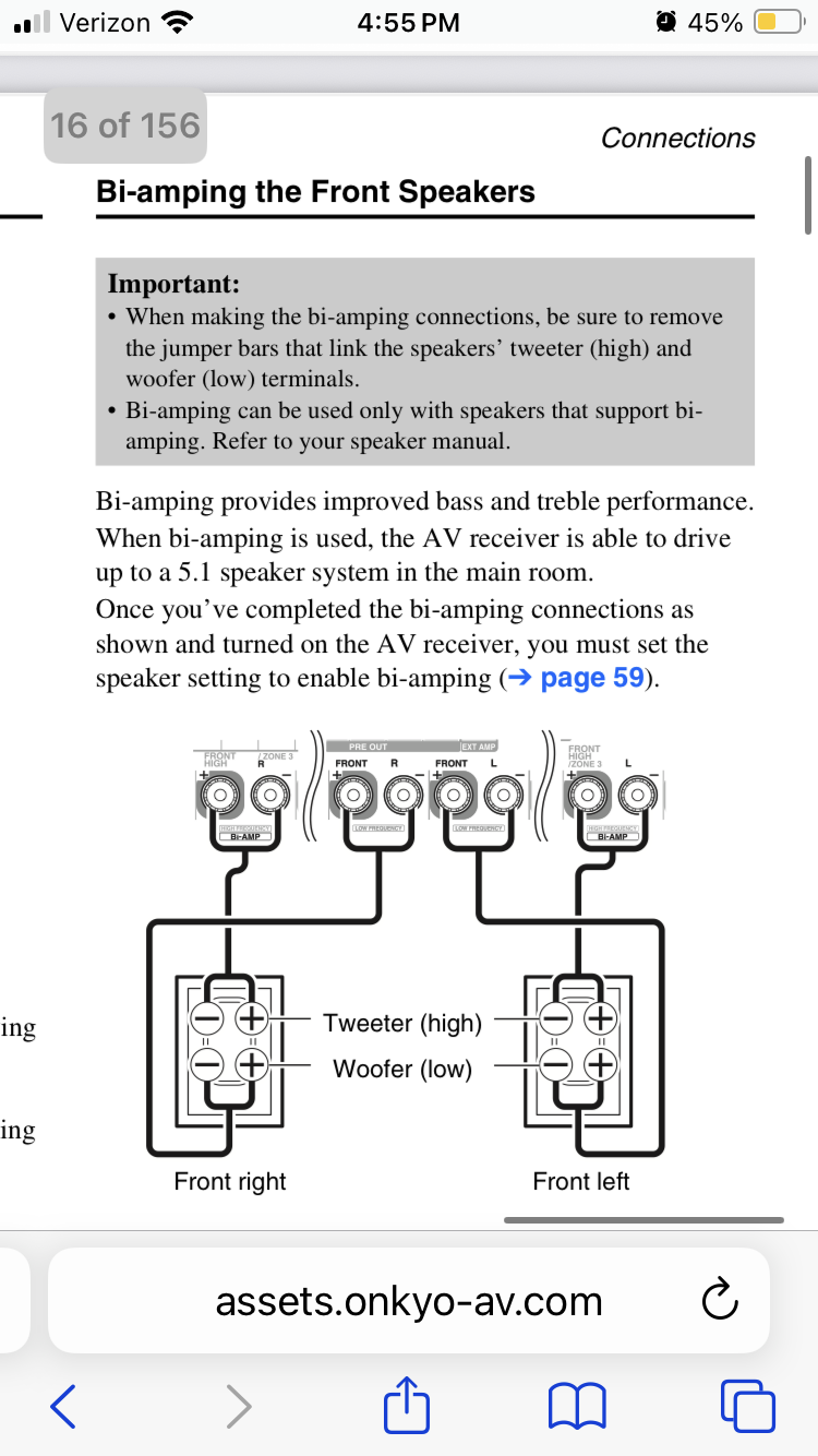

Yeah yet tons of models include the ability I’m sure 99% are passiveeven my old klipsch icon kf26. And lots of avrs including both ones I have this is one manual. Claiming it increases performance. So these companies all feed into the myth keeping it going .:cool: Companies make ultra high end cables special for doing this also and regular usage.

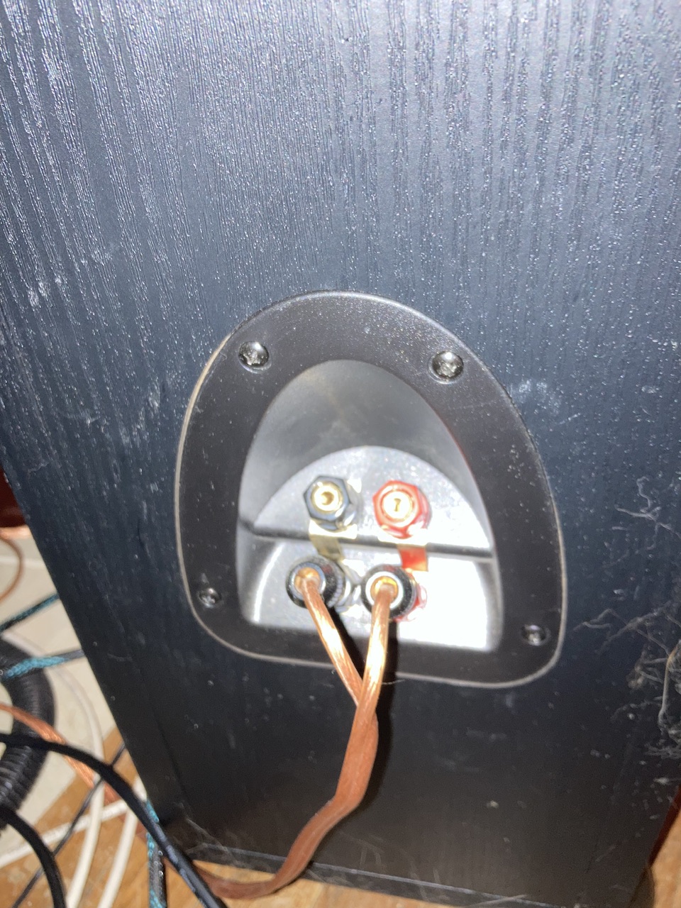

I have them hooked up the normal way. Using Dayton 14awg cables seem discontinued now. I considered getting 12awg but never did , not sure I’d notice anything different?
I’m sure it would be pointless to bother with a majority of speakers. But lots of people probably do it because they have extra cables lying around and amp channels unused. I’ve tried it before and couldn’t notice a difference.

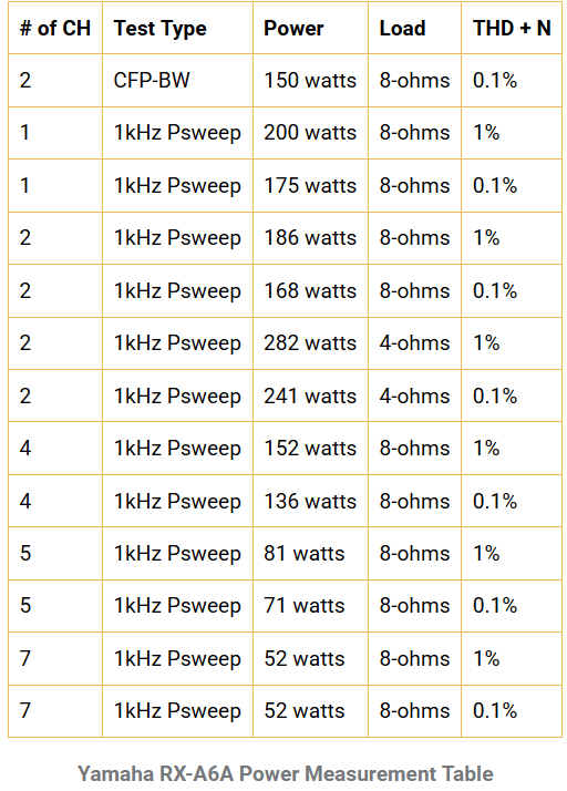

The vast majority of AVRs lose power per channel the more channels you activate/drive (some brands more so than others but almost always by considerable amounts) so to answer your question: YES, you'll likely lose power!
Here for example is the Audioholics review breakdown of a somewhat recent Yamaha showing how its power per channel plummets as you increase the # of CH driven:

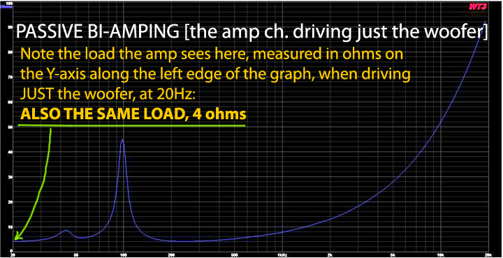

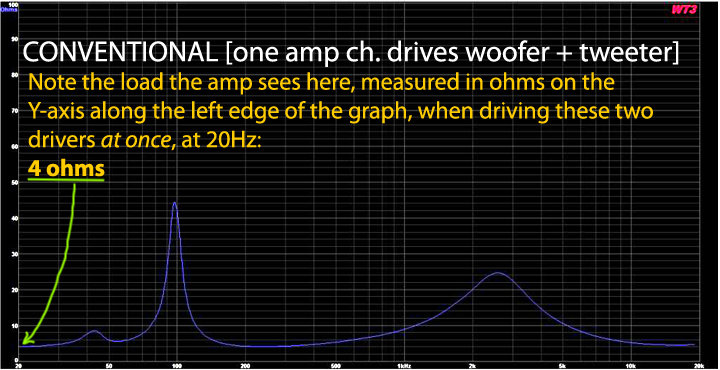

I demonstrated this with data in the AVS forum. What I proved is that when using a fixed test tone frequency I selected of 200Hz, into a speaker presenting a 4-ohm load with 0 degrees phase angle at that frequency, there is no change in the maximum possible output of it simply by disconnecting the HF input section of the speaker, i.e. removing the gold jumper bars on the speaker's terminals (the change the amp experiences when switching from normal single amp wiring scenario to passive bi-amping just the speaker's LF input alone).
I show that according to Gene's measurements of a particular Denon amp channel (driving 4-ohms) the maximum output at this frequency into this particular speaker's load of 4-ohm with 0-degrees phase angle, under FTC's rules, is 267 watts when using either one amp or passive bi-amping by buying two of them. [Don't let the fact that the data comes from a multichannel amp, an AVR, fool you. Pretend for the moment that to accomplish your passive bi-amping mode you buy a second one.]
To determine the maximum output of an amp at a given frequency used in isolation, you need to know three things:
- what amp is being tested,
- what incoming frequency is being tested, and
- what is the load the amp "feels" at that frequency (shown w/ curves of a particular KEF under the two scenarios)
It's pretty simple: If these three things stay constant then your maximum possible output at that frequency can't change!
