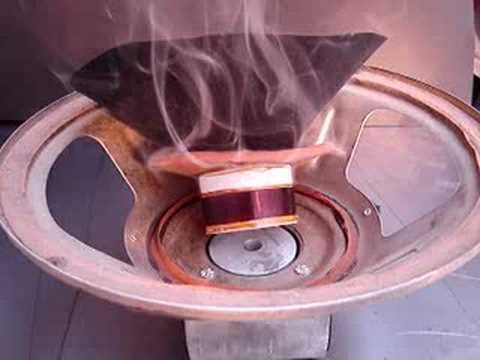

What strikes me as strange is the use of ferrofluid alone to keep the former in place. The spider is more used to restrict the moving assembly to just one plane of motion. It isn't used to much to restrict excursion. I don't understand how the moving assembly could just be suspended in ferrofluid and stay in alignment all the time. The only way I can see this working is if there is some repulsive magnetic force acting on the VC/former all the time that holds it in position. If they had managed to pull that trick off, that would be neat, but I don't see anything like that mentioned in the patent.
The patent only addresses this issue with these statements: "If the elastomeric ring, and the frame, are manufactured with reasonably good precision, the cone will oscillate in essentially a true axial direction, so as to exert minimal constraint on the voice coil motion. The magnetic liquid located in the magnetic gap, will exert sufficient guidance on the voice coil, to ensure that the voice coil will move in a true axial direction." That doesn't seem sufficient to solve that problem. Maybe I am just thinking of higher excursion types of drivers, and that solution is enough for lower excursion drivers.
shadyJ
Speaker of the House
Staff member
Doing some more looking, it does seem like the ferrofluid in the gap does have some kind of centering force, per this ferrofluid manufacturing website: "
The presence of ferrofluid exerts a uniform radial centering force upon the voice coil in the air gap. The magnitude of this force is dependent upon the strength of the permanent magnetic field and saturation magnetization of the ferrofluid. The greater these values, the stronger the centering force. Reduced scrap rates on the production line, reduced field returns and reduced distortion (due to the suppression of radial and rocking modes of the voice coil) are some of the well-known benefits of this centering force.
In recent years, the availability of high saturation magnetization ferrofluids have allowed designers to completely remove the spider, relying on the ferrofluid to center the voice coil in the air gap. This technique not only yields lower cost and a simplified production process; it also removes the well-documented nonlinearities present in all spiders, resulting in lower distortion. In general terms, the saturation magnetization values of ferrofluids used in spiderless designs should not be lower than 33 mT
Interesting stuff!
Verdinut
Verdinut
I can't believe that a fluid would have a centering force. Have you ever seen a woofer of even a mid-bass driver using a ferrofluid to replace a spider. Ferrofluid material is usually used for tweeters to dampen some resonance and to cool voice coils. IMO, their purpose is not to center a voice coil in a magnetic field. I just don't believe that.
Several web articles comment about the possibility of voice coil centering. They mention the possibility because they're not convinced either. How can a fluid hold something to a specific spot? I need more scientific proof.
How long before you need to change fluid in such a driver? What volume of ferrofluid is involved in a woofer vs mid vs tweeter ?
Verdinut
Verdinut
Although it's possible, I've never heard of a woofer using a ferrofluid to keep its voice coil cooler.
