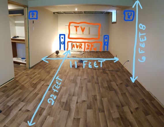

So far this is my HT room. I am working on refreshing it. This is my setup. There will be a couch in the middle to accomodate 3 person. ATM it doesnt look like i cant put a sub in the front because of lack of space. But i still can modify the fourniture to accomodate one sub in the front if this is necessary.
I was asking you a drwing because my english is very bad, and i want to make sure i got your info corectly.

So yes one sub is usually in the front. (or possibly in front of one of your main speakers is close enough) Not doing that is less of an issue if your center is capable of a clean 80hz crossover.
The reason is when watching TV or movies, 70% of the sound including 99% of the dialog is from the center speaker. The brain can get used to pretty much whatever in a few months but you typically will notice if voices sound weird.
The obvious other location to try is behind your couch. Sideways if that saves space.
I believe some people have done 2 subs behind the couch. Like @Danzilla31 had at his old house.
What I experienced is near field is awesome but it's trickier to integrate with the front 3 up front I achieved my best results with one near field behind the couch on the right and one on the front wall in between the center tower and the left speaker. Those were the two best spots in my room and it sounded wonderful paired like that.
