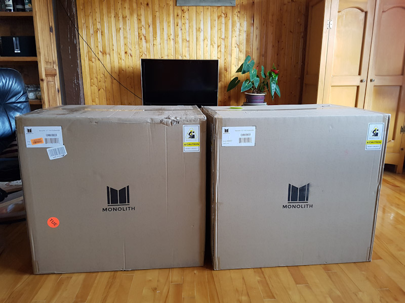

what a surprise when i got home this morning after my 7 days of hiking in the wilderness :D
BTW... no this is not the TV i use for my home theater :p
