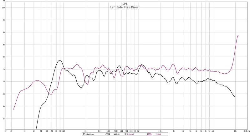

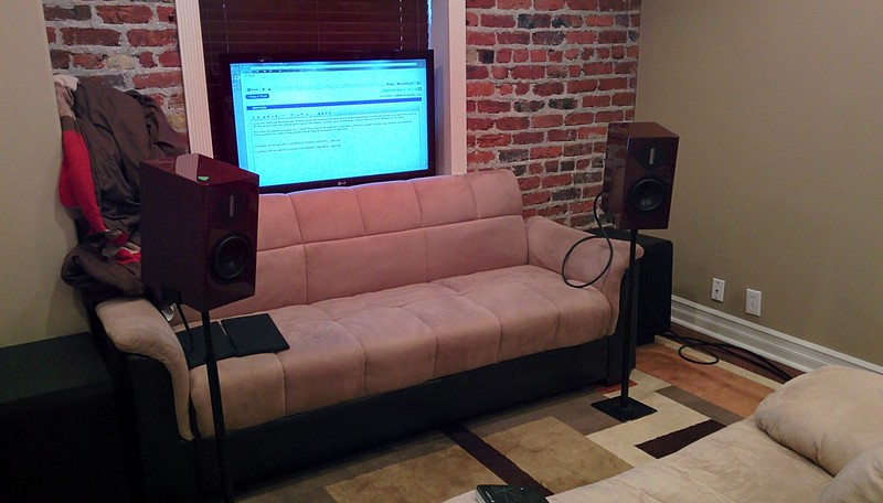

This is how the speakers are setup now, I moved them closer to the center and raised them by 6 inches compared to the Behringer Monitors. Also moved the listening position to create a 5ft equilateral triangle. I'm using the comforter as a temporary room treatment LOL! Massive improvement on both sides.

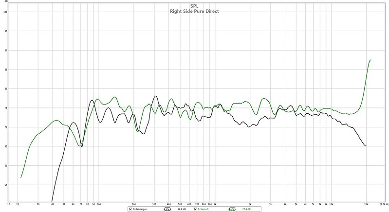

Ignore the 15KHz and above because I forgot to switch the soundcard calibration file and so the measurement shows the reading peak up to match the card's drop off. Not correct since I was sending digital signal to the receiver via HDMI. Gonna do these again since I'm still playing with the setup and calibration.
