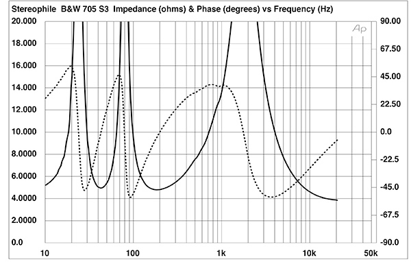

G gnorthern Junior Audioholic Jan 28, 2025 50 0 6 71 Feb 13, 2025 #21 Bowers & Wilkins 705 S3 loudspeaker Measurements | Stereophile.com On second look I got faked out by the steep negative phase angles. They always occur at times of higher impedance, so not so bad.
TLS Guy Audioholic Jedi Oct 30, 2007 27,295 0 113 79 Eagan MN Feb 13, 2025 #22 gnorthern said: Bowers & Wilkins 705 S3 loudspeaker Measurements | Stereophile.com View attachment 72181 On second look I got faked out by the steep negative phase angles. They always occur at times of higher impedance, so not so bad. Click to expand... Not very good though. There are some negative numbers where the impedance is not very high. I think the Paradigm is the better and safer speaker for you. Reactions: gnorthern
G gnorthern Junior Audioholic Jan 28, 2025 50 0 6 71 Feb 13, 2025 #23 Again, thank you for all your help. I put money down on the Paradigm Premier 800Fs earlier today based on yours and other's help and just posted an ad on Facebook for my old speakers. As you said, "Not very good though." Reactions: Antares
