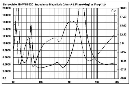

Generally B & W speakers are not a good match for receivers. They tend to have impedance dips and adverse phase angles. I can not find an impedance curve or phase angles for those speakers.
The impedance curve is how the impedance of a speaker varies with frequency, the phase angles are show the variation of the phase angle between current and voltage.
In a resistor the current and voltage follow strict ohm's law, and the phase angle is zero. Speakers are inductive loads, so current and voltage are not in the same phase and this phase variation varies with frequency. When there is a high negative phase angle then the output transistors have to provide a high current, for what is known as the apparent power. This power is given back later in the cycle, but the power has to be provided transiently and amps tend not to like it.
Here are the impedance curve and phase angles of a B & W 802 D speaker.
The solid line is the impedance curve and the dotted line the phase angles plotted against frequency.
You can see that the impedance drops to around 3.6 ohms around 80 Hz, well in the power band and also at 700 Hz. Now the phase angle is about -60 degrees when the impedance is around 4 ohms. This is the type of situation that is an amp stress.
Here is the impedance curve of my 3 way speakers in our family room.
The red line is the phase angles with frequency and the blue the impedance curve. Those are essentially 6 ohm speakers. I designed these speakers and impedance compensated the crossover circuit. The only significantly negative phase angle is when the impedance is very high, as it is right over one of the tuning peaks.
So those speakers is an easy drive for an amplifier, whereas the B & W is a torture test.
So, I have to caution you about matching B & W speakers with receivers, as they are prone to be receiver busters.
I know this is complicated, but understanding all this helps keep you out of trouble.
I said I understand that but double checking. So around 1.75k impedance goes up to about 22 ohms?
The impedance rise won't upset your receiver, it is low impedance plus highly negative phase angles that damages amps.

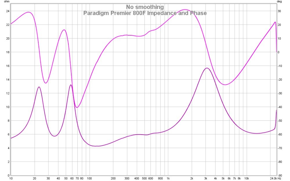

Can you post the measurements of that B & W speaker?
That paradigm speaker was reviewed by Shady J on Audioholics and those Paradigm 800 Fs measured very well.
The lowest impedance is 4.2 ohms at 110 Hz, but the phase angle is only -20 degrees. For a three way speakers phase and impedance curves are well behaved and should not damage your receiver.
Those Paradigm speakers will be a big upgrade from those Klipsch speakers. So I would snap them up.
