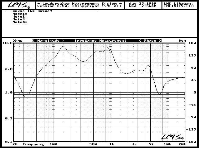

By the way, between us, don't show @TLS Guy (an experienced speaker diyer) the impedance graph, if he sees it, you will tell you to get rid of those "poorly designed" speakers.;) And if you believe him, don't throw them out, just send them to me.
Dr Toole would say the same thing, poorly designed. ;)
