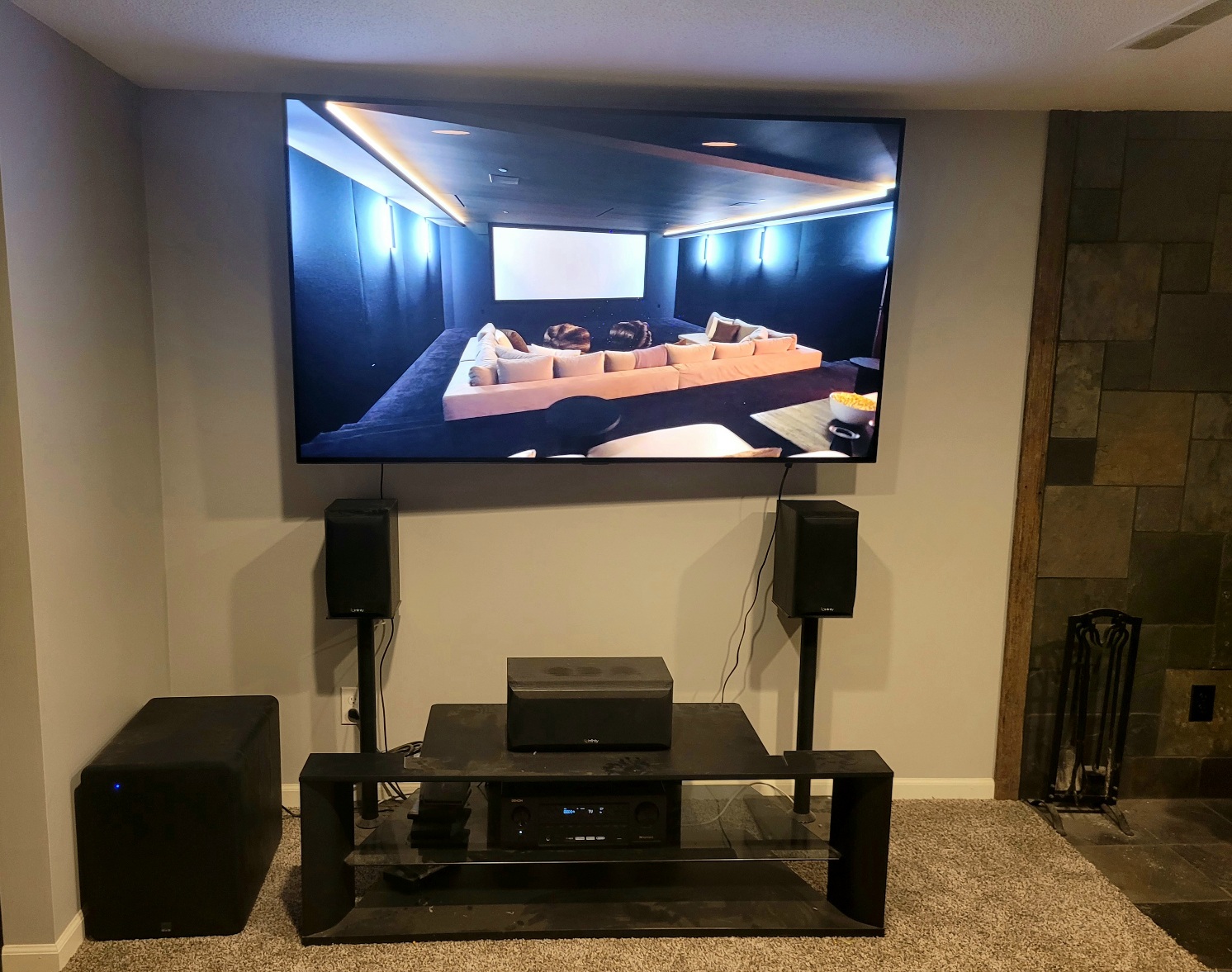

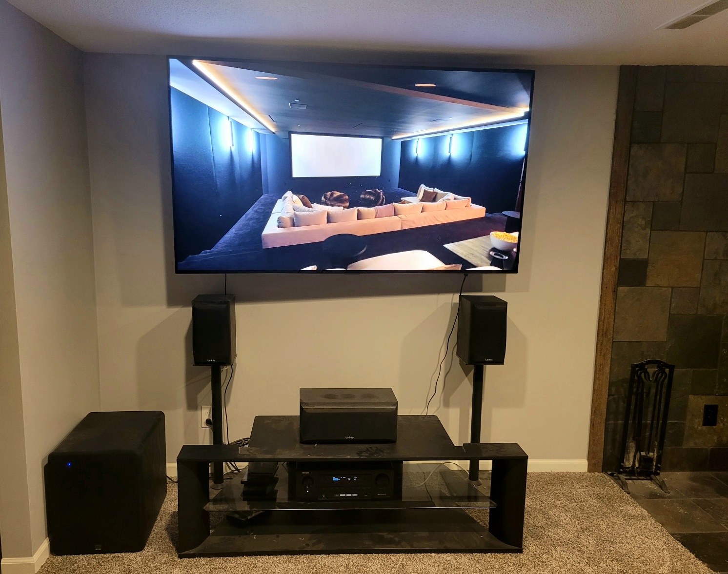

Both really and those two pics don't seem to show the whole story....what are the two speakers under the tv, tho?
Both the shelf speakers and center are some older Infinity Primus, with my reciever being a new Denon AVR-X1700H.
Dang, didn't even notice that was a center. The placement of all three is pretty bad, probably the root of your problem.
rockhound100bopd
rockhound100bopd
Yeah it's only a 3.1 system. I would like to turn it to 5.1, but the room is pretty narrow and would be hard to run speaker wire everywhere. Should the 2 shelf speakers be wider apart? Or should the sub be behind the LP?

Well as noted, multiple subs are most effective for smoothing bass response throughout the room, while also adding headroom and reducing distortion. My thoughts are usually to buy the single best sub you can afford now, and then start saving right away for a second one. If the pb1000 was ok, then you will be very satisfied with the 12s. Then just get another as soon as you can. If it were my room, I would work on the front wall and speaker/tv placement. I would recommend lowering the tv, and moving the mains to the sides of the tv. Any pics of the back of the room? Might be able to help think of some way to place surrounds.
I might have to put a couple shelves up to hold the speakers and reciever, and get rid of the old TV stand. This would make room to the outside of the TV and room for the sub towards the middle.
There is quite a bit of room behind the main LP as seen in the pic. It is taken about 20' behind the LP. Excuse the mess, its Christmas with 5 kids...

Thats a big space...maybe something like the Heco 1000 towers that can be had at half price on sale.
Not to sound demeaning, but your current speakers are about as bottom of the barrel as it gets.
Adding a top notch sub to those will just make them sound even more inadequate.
I would bet that your current sub can be coaxed into much better performance also with a little work.
