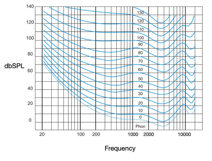

Loudness is one thing, intensity is another- what we hear can sound loud when it's actually not, but the intensity makes us believe it is loud because of our increased sensitivity centered in the 3KHz-4KHz range, but we're also more sensitive in the range from 1KHz-5KHz, compared to the ranges above and below. The chart shows typical human hearing sensitivity (only one of many, with varying results- I'm only showing it to make a point)-

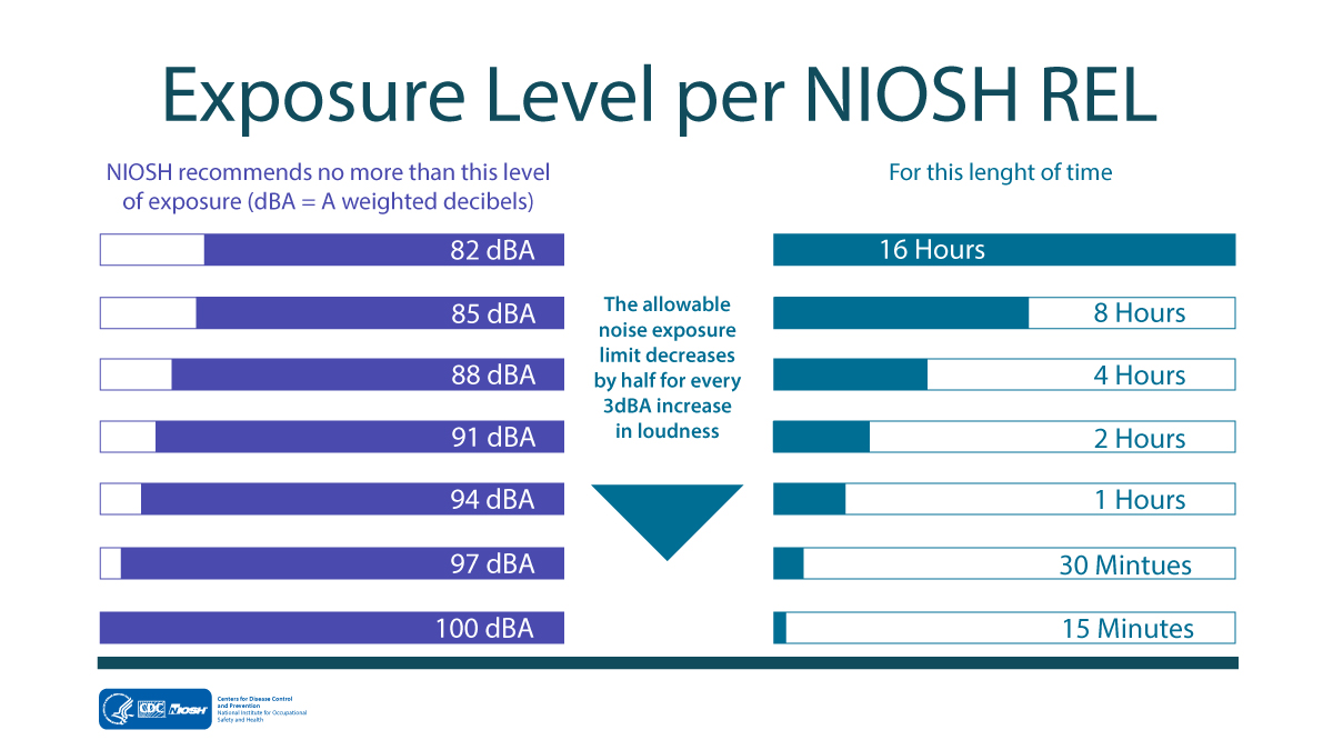

This image is a CDC noise exposure chart- you should note that it doesn't show anything above 100dBA and that's because there is no amount of time for exposure to that SPL which is safe for a person's hearing. Now, increase it to 150dB and the damage occurs immediately. It's permanent, too.
