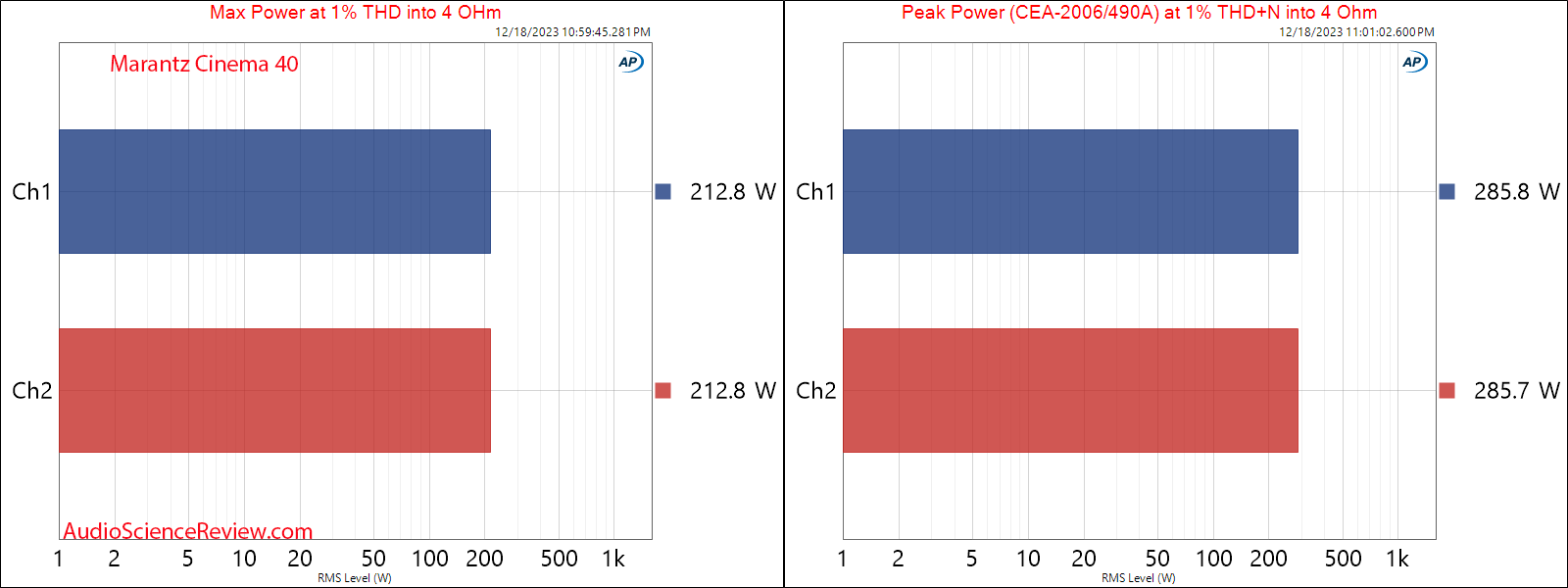

The C40 will not be able to drive such speakers on a continuous level at reference level and it will fail if you try too often. Again you have done the right right thing adding the XTC power amp.

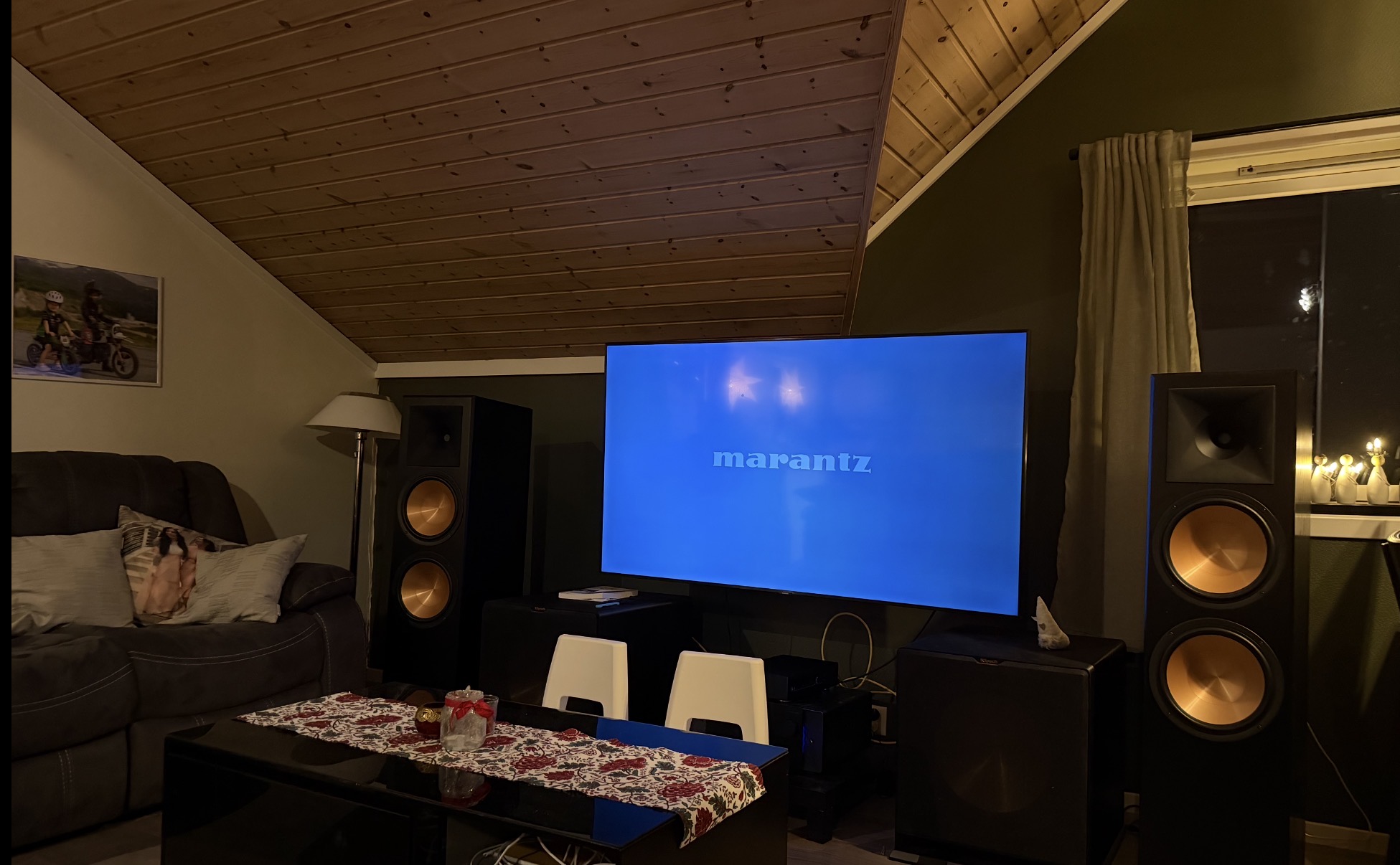

I have about 3,5 meters from the speakers. The calculations you have done are pretty much spot what I see now, and I don’t need to go past -10 to achieve what i was aiming for.
From the first measurements you are referring to, I basically have nothing left of the setup. I have remodeled the listening position 90 degrees so that the slanted roof is now towards me and not sideways. The 80W denon is gone, and replaced with the M40. The rp-280’s are replaced with a RF7’s and I also have a power amp I did not have before.
Everything has helped but the power amp had the most impact by miles for sure.

I did find at least one error in my post but fixed it. Regardless, the C40 cannot do the RF-7 justice based on your use case. Of course it can do a good job for some users but not for you. That part is obvious and I provided the underlying facts in my post. Your amp has impressive specs, congrats, and enjoy the music.

Just thought I post how this ended if anyone reading is interested. So I upgraded the Klipsch RP 280F’s to RF-7, same problem, upgraded the 80W Denon receiver to Marantz Cinema 40 with 125Wand it was better, but still an issue with sound quality starting around -8 - -5 db deteriorating.
My understanding now is that I was not running in to clipping but my receiver really did not have proper control of the speakers.
Finally I got a XTC A2-400 power amp and then it was night and day. Clarity and quality was a massive step up, and now -10dB on the Marantz the experienced loudness is about the same as 0 was before. It just seems so effortless for this amp.
It was a long way, but super happy how it worked out. Hope somebody takes some measurements of the XTC because to me it is an impressive product for its price?
So lesson learned: Receivers and large speakers do not pair well contrary to YouTube reviews.

Interesting question. Are the RF7’s wortj it? Well knowing what I know now I guess for the price I would actually be looking at other options like a used pair of the Arendal 1528 as they would not be to far off actually. (I’m in Norway and it seems a popular choice around here). I like the sound but they are not what they advertise them to be. Well let me put it this way, I wouldn’t swap back now for sure. Had I gone straight to a power amp from my old Denon I might actually still have had the rp-280s as I’m not to concerned with brand/size etc. I just want the system to be able to do what I want at a reasonable price.
I’m sitting at about 3,5-4 meters.
I underestimated the power need by a lot, and it is clear that you don’t need to go in to crazy volume before you get provlems with an AVR on the RF7.
It was a bummer really as the swap in speakers really did nothing and also the change to a bigger AVR did not do much either. I was looking at YouTube reviews as I really do not have good knowledge about this stuff and many run the speakers on lots of AVR’s and give them a thumbs up. Either it is for clicks or many simply don’t know or understand. Even though you are not running in to clipping you can really tell the AVR and speakers are not having a good time. If I knew the impedance of these speakers was this far of the spec, I would definitely have gone about this another way.
The plus side about this ordeal is that I learned some new things so it was not for nothing.

That's why the output in watts are not very useful, it allows us to compare outputs among similar models of popular brands but even then one has to know some basics in order to compare apple to apple.
The 125 watts is specific on 8 ohm nominal resistor load and at 0.05% THD+N or less, 2 channel driven, audio bandwidth as you stated. We have no idea about the duration, do they go by the latest FTC rules, that would be for something like 10 minutes and under a specific test conditions, or they go by shorter, or longer (I'll be surprised..) duration, and what happened when other channels are driven albeit not continuously at equal output?
Tests often show something like the C40, or the AVR-X4800H for $1,000 less, could in fact push >200 W into 4 ohms for short duration, so in real world use it likely can handle the RF-7 fine, as I said for many users but not the OP, because of his listening habit and distance. If I had those RF-7, even his 80 W Denon might be fine, but I never listen to music with volume pass -15 and rarely pass -20 and my mlp is only about 3 meters.
According ASR test bench:
Again, the higher "wattage" measured would be useful in terms of short term demands such as those from action, horror movie tracks, and for music that has high DR moments, but not for high demands on average or long duration peaks. I think we both know that kind of caveat, just want to be clear here that's all.
Marantz Cinema 40 AVR Review | Audio Science Review (ASR) Forum
