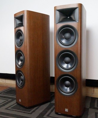

I was thinking something like the JBL HDI 3800 as a formally similar alternative to RF-7. Legit 'big room' speaker. Great measured performance (linky). Better than the Klipsch? Haven't seen any measurements of those, but I'd wager so. JBLs are less expensive at current street prices, by quite a bit.

I agree about the JBLs. Have not heard any of the modern Klipsch other than the lower end towers a friend let me try before I came here looking for suggestions years ago.
