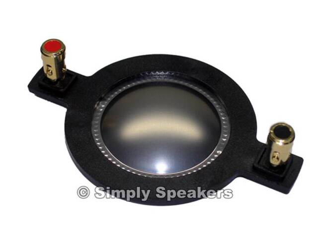

The marketers may call it a compression driver, but it isn't, and I am not the only one to call that out. Klipsch speakers used to have a compression driver.
This is a picture of a compression driver.
This is the replacement dome for the RF7.
There is a hot market for that part, as people burning them out is common.
That speaker has a dome tweeter at the mouth of a horn, no matter how Klipsch advertise it.
This replacement dome is somehow similar looking as Altec and JBL compression driver diaphragms. But it doesn't seem to have as high an excursion capability. What is its diameter?
Here is a diaphragm for the Altec 802 compression driver:
